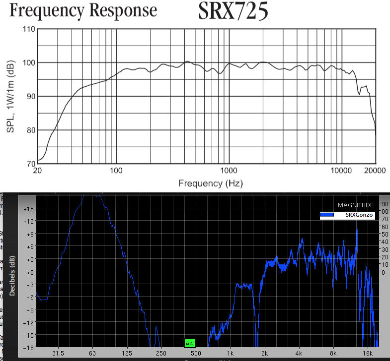

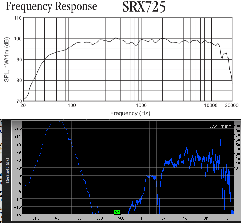

Here is an example of a 2-way JBL SRX725, and what a DJ managed to do to the response with improper crossover settings, the stock passive crossover response on top in black and white, his bi-amped response below in blue:
DJ Gonzo had been "adjusting" the active crossover on gigs for several months, managed to turn a +/-3dB response into a disaster.
Unfortunately, a response like that is often what inexperienced operators accomplish when they attempt to integrate separate components into a speaker system.
Took about 15 minutes for me to discover what he had done wrong and bring the system into alignment.
Art

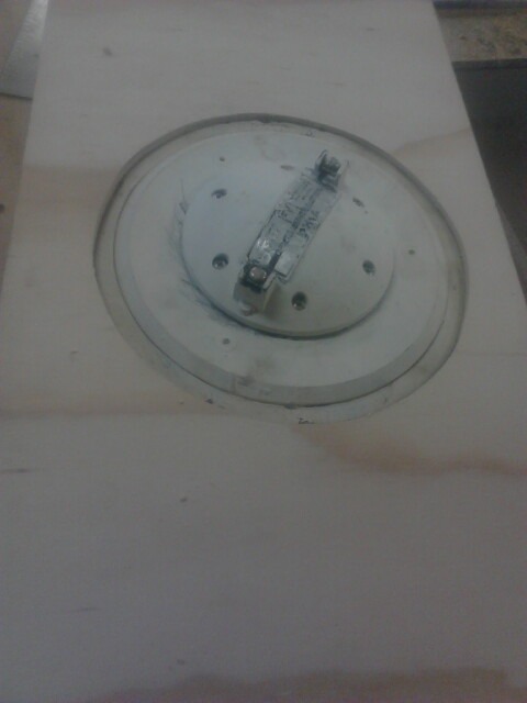

BTW: I want to build a wooden box around the 2450H 2"CD and horn. Since the CD is quite heavy, does it need some support, e.g. a wooden beam to hold its weight? Else the whole weight is connected to the box only via a few screws at the front of the horn. Basically the CD is just hanging in the air.

Yes, without support it's weight may crack the plastic horn on a sharp bump, especially in cold weather.BTW: I want to build a wooden box around the 2450H 2"CD and horn. Since the CD is quite heavy, does it need some support, e.g. a wooden beam to hold its weight?
You never know what way a dropped cabinet may land, so a circular support would be best, like this example:
That said, at 4.8 kg (10½ lb), the 2405J is only about half the weight of the above EV driver or the JBL 2445, so less likely to crack the 2385A horn.

Yes some support for the compression driver is a very good idea.BTW: I want to build a wooden box around the 2450H 2"CD and horn. Since the CD is quite heavy, does it need some support, e.g. a wooden beam to hold its weight? Else the whole weight is connected to the box only via a few screws at the front of the horn. Basically the CD is just hanging in the air.
