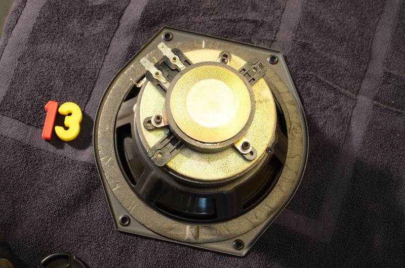

The tweeter in a Tannoy DC is a CD - it has to be bolted onto the back of the magnet to keep its VC in alignment, given that both 'drive units' use the same magnet / gap
AND Afaik all the 'newer' DC's have ferro-fluid in there as well, so un-bolting and removing the tweeter will turn the unit into 'bin fodder'...
Hi and thank you so much for the very valuable reply.
So it is not feasible. I have been impressed by the above post about the remarkable drop in distortion consequent to tweeter decoupling.
The idea was to place some of this sorbothane between the woofer magnet and the tweeter mounting frame, like just three washers of decoupling material in order to isolate mechanically the vibrating woofer from the tweeter and hoping for a decrease in distortion from the tweeter.
This looks a lot like my drivers ... of the Tannoy 609 mk II
![glosnik-dual-concentric_419.jpg](/community/proxy.php?image=http%3A%2F%2Fwww.audiofan24.pl%2Fgalerie%2Fg%2Fglosnik-dual-concentric_419.jpg&hash=ea7d00d8875cbedb110f9d234179778d)
This instead should be the tweeter frame (i have not unscrewed it yet).
If i understand well you mean that placing 3 rubber washers between this frame and the woofer magnet in correspondence of the mounting screws will damage the driver ?
Or even a larger gasket around the horn maybe ?

Hmmm,
I was wrong, the tweeter is an individual..... things you miss when your only after a serial number
You could try some form of lossy mounting for the tweeter, though I'd start by putting the drive unit back together and into a less carply made enclosure and seeing how it sounds.
Bit like building a race car and setting it up for Brands Hatch when the thing has never been driven or run.....

@Ginetto,
I have an 8 inch tannoy DC and had be toying before with the same idea of "decoupling" the tweeter assembly too. However note that the transition between mouth of waveguide and speaker cone is crucial ( see Tannoy III LZ, on another tannoy) and by intoducing an offset due to the thickness of damping might create more problems than it solves. Maybe try what tannoy do on some of their monitors, there is a brace right behind the DC and a blob of "putty" pressed in between the tweeter magnet and the brace...
