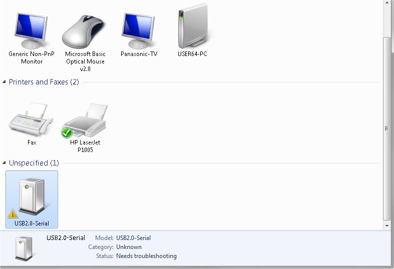

What driver ??
I know it is a Dui or nano , after installing the software - "device not successfully installed" after USB plug-in. Hardware wise - it is physically detected.
Tried manual install of either /both the com or usb driver - no luck. Even as the
installer says the drivers are installed - it should work.

I had this kind of problem last time I installed Arduino software on my home PC (Win8.1)...
Here is what has helped - download the latest FTDI chip driver >HERE<
Install the downloaded driver. Then go to Device Manager, right click on Arduino, click update the driver and then say you want to select it from the list. In the list there will be a section called "FTDI" - just select the latest version from there.
After that additional com-port appeared and I was able to communicate with Arduino...

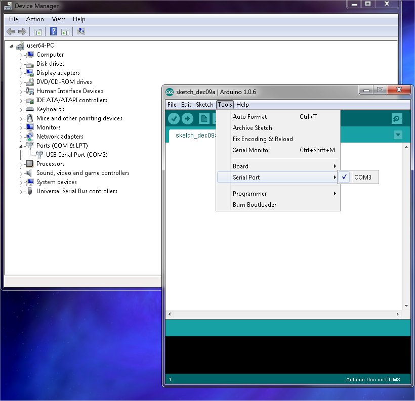

Yep , com 3 is active in the arduino editor (below). I can now
download a sketch to the processor ?
Thank you , Val !!
