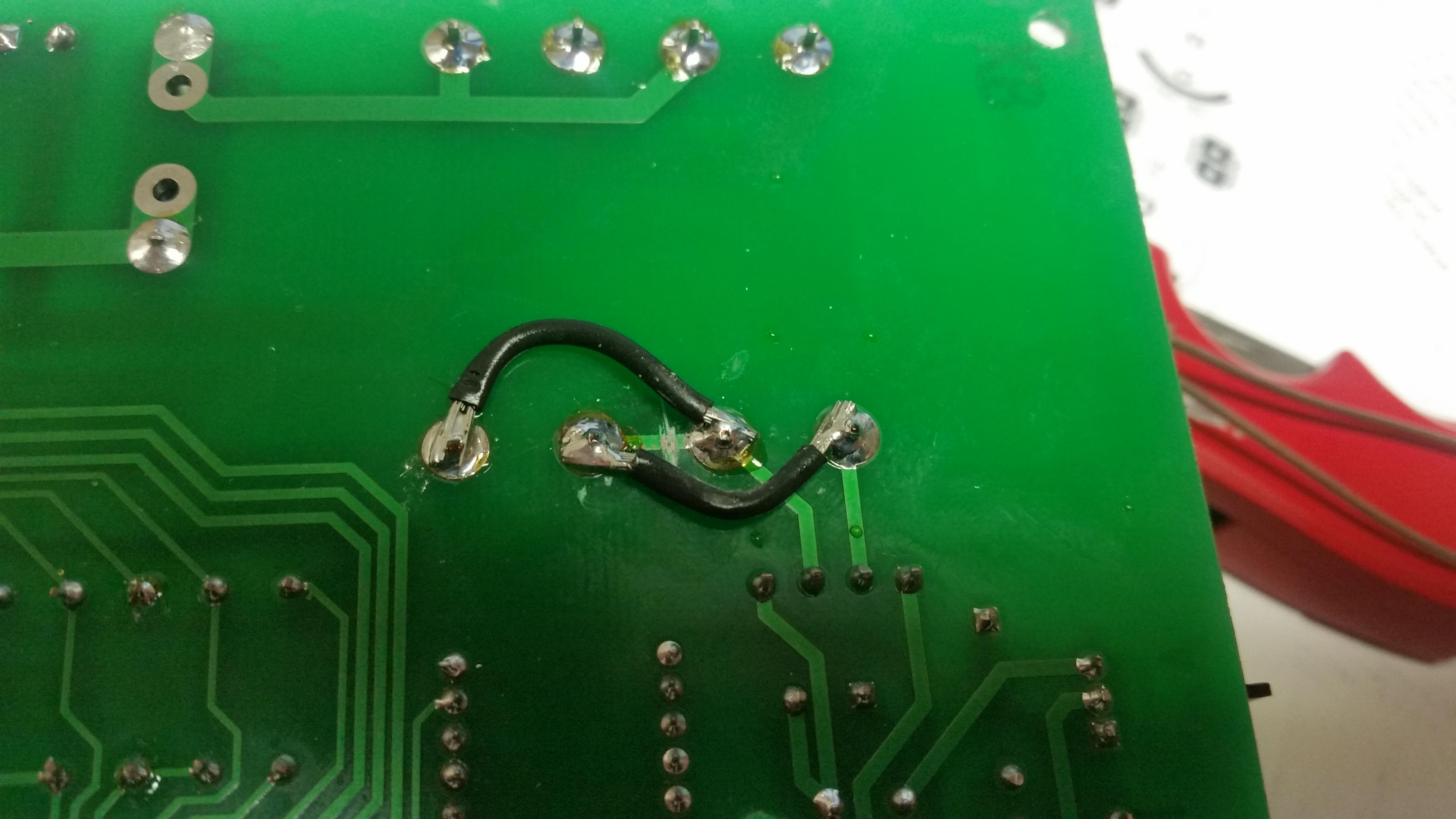

Here's a modification you might want to do to your board OS. The transformer outputs are in series. One rail is just feeding a voltage detector. The transformer will run cooler if you cut the trace between the secondaries and parallel them. You probably won't have any problems but with the extra relay for a tube transformer it's pretty much maxing out one secondary winding.

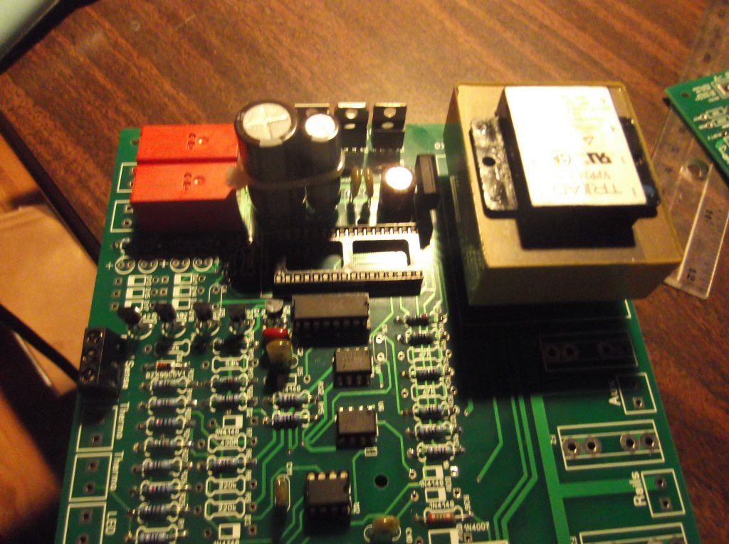

Oh , I already stuffed those (below). The big cap (2200u@35V) was so big it
trespassed on the 1000u/35 (C5) "spot" ... that's why I have them strapped together.
OS

Yes they are a bit of a squeeze.
You might want to mount your 7812 regulator under the board on the aluminum plate. It runs pretty hot.
What if I just mounted a heatsink made of flashing across all 4 to-220's.
Actually, the 2 lm78xx regs have a tabbed grounds -good . Dang ! that poor 7812 is
running all those "monster" OMRON relays - big flashing from corner screw to corner screw !! 😱
PS - you run the "monsters" right from the ULN2003 ? Does IT get hot at 158ma
X 2 (both omrons)? 😱
OS
The regulator should probably be chassis mounted. It puts out a lot of heat. It's running near the upper end of it's current handling with everything on and it's a steady load so it doesn't get a chance to cool.
ULN2003 is rated maximum 500mA/Darlington. Great device. Doesn't really warm up much at all.
160ma x2 for the omrons , 21ma x 2 for the shracks (orange relay) +just 10ma
loss through the transistors/IC. 400ma /5w = maxed out for no heatsink.
TI recommends a 10C/w for >5w load. - the chassis or my mounting plate would be
<2-3C/w.
Looks like I'll have to add an inch to my mounting plate. The 7812 leads would also
be too short to make the change (under the board).

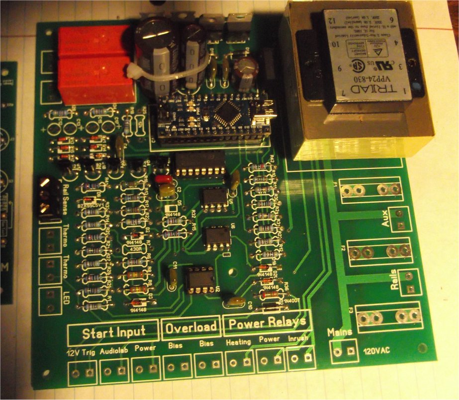

This was harder than the spooky's , I actually did the NANO itself with a"wedge"
iron tip - but better than your average soldering (below -nearly stuffed).
PS- I'm only going to use F1 , I have a more robust fuse for the main trafo -
on that back "AC only" plate.
OS
