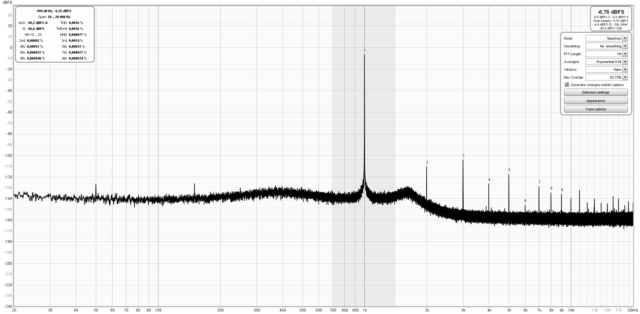

Just measured signal generator distortion with Cosmos APU + Cosmos ADC using java EXCL driver 44kHz/256K FFT/32 averages, where no carrier jumping was apparent but harmonics did vary for 6 dB or more. With coherent averaging -145 dBc. Turning on phase of harmonics, results with measured -140 dBc.

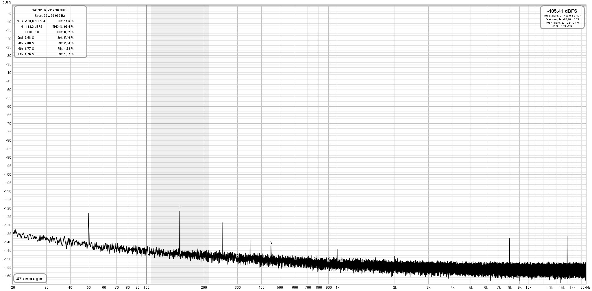

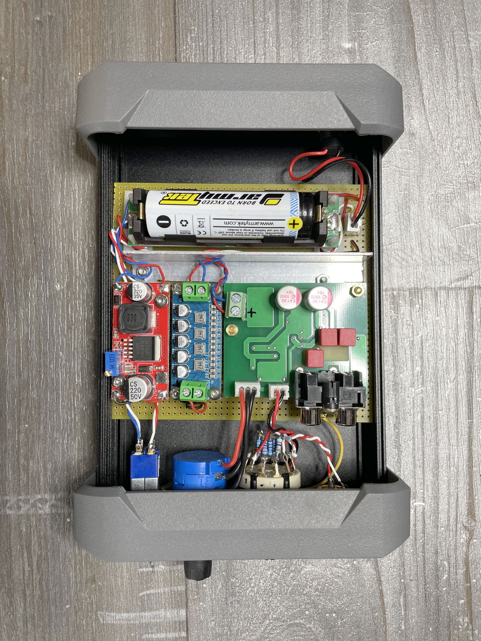

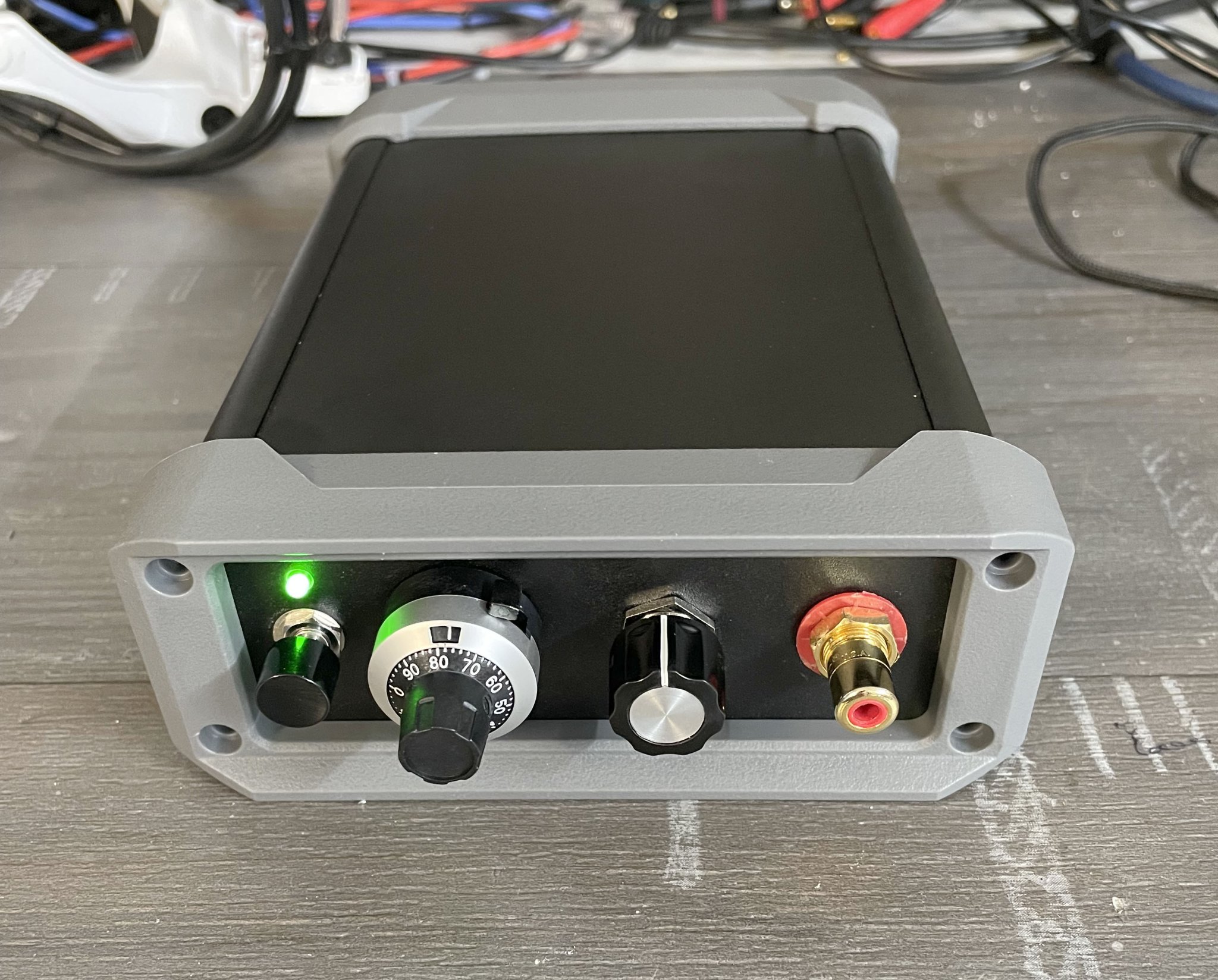

Hello,
I finished boxing Victor's oscillator. I wanted to ask you if the REW curve I'm putting out is correct for what it should be. I still have a small residue of 50Hz and its harmonics that I cannot make disappear.
Stef.
Stef.
Hello,
I've already tried with the XL6009 and 1850 modules outside the box. No change.
The oscillator GND is connected to the box (the yellow wire).
On the scope, the "working" switching frequency of the XL6009 module is around 110-140KHz.
May be this come from the others parts of the system.
Stef.
Stef.
It is highly likely that your spectrum shows solely the performance of your Tascam interface. The latter is specified with a THD of 0.006%, but since the measurement conditions are not quoted it is not much worth.
On the other hand, the order of magnitude may still estimated: converting your THD result of 0.0016% dBFS to dBc I get 0.0035%, which is in the same ballpark as the 0.006% of your Tascam, but please not that this i just a rough estimate.
But even if your Tascam had a much lower THD, it can not be used to measure the THD of an oscillator capable of -150dBc, not even a top notch ADC like Cosmos can do that without a notch filter and an LNA.
The 50Hz residual seems to come from the Tascam interface. I looped the Tascam (output connected to input without signal) and I got the following.
My installation is made up of an old Intel NUC running Windows 10, the Tascam interface and a Hifime USB Isolator (480Mbps). All powered with a 24v battery pack which outputs 18V and 5V for the equipments. Without the isolator, the 50Hz rises to -85dB.
It may also come from the LCD screen. This is the only part that I didn't put on battery. As it's an old screen which works on 18Vdc, I'm going to try putting it on the battery too. I'm missing an adaptor cable to do it.

Looking at your current spectrum, the 1kHz peak is due to the USB interface, the 8 and 16kHz probably too.
I've had them in my setup too, sometimes it helps to physically separate the audio interface and the computer as much as possible.
Re. the mains spikes, I got rid of them by separating the oscillator from its PSU, the 30V cable between the PSU and the oscillator has double sheath.
My Victor is housed is an Al casing lined inside all around with mu-metal sheet.
