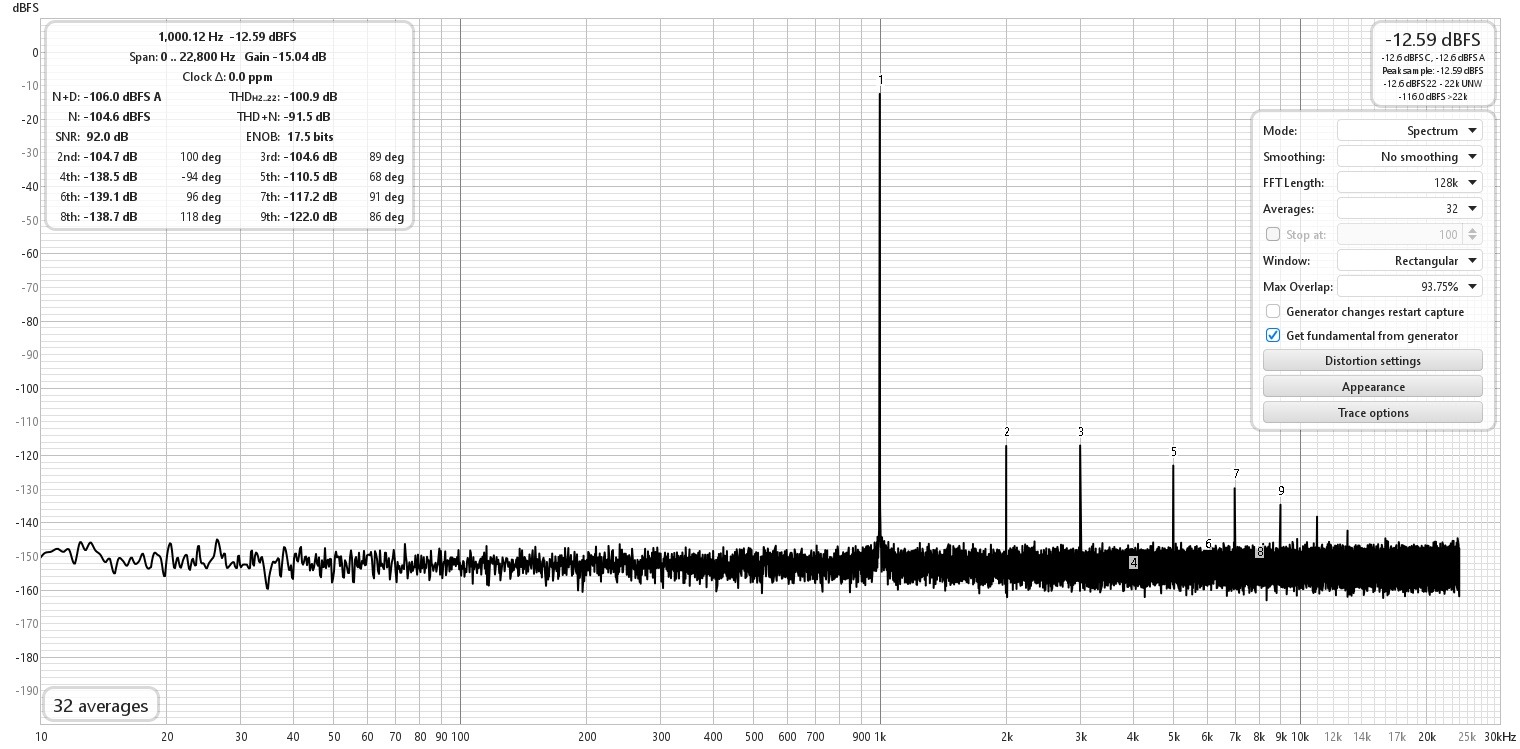

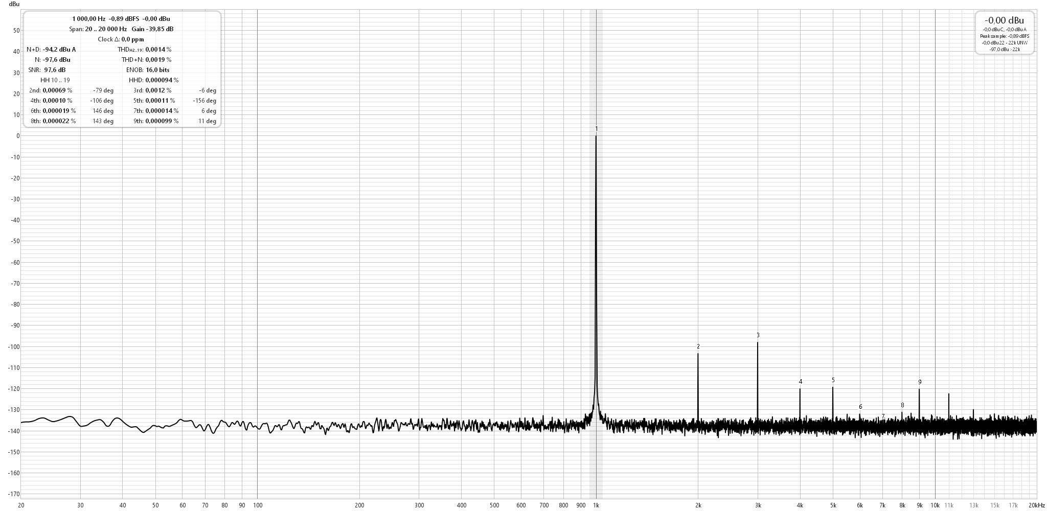

I tested with another amp with REW's internal oscillator and the two cables. I found the same phenomenon.
To make comparison measurements during development, this is not too much of a problem as long as we keep the same test protocol but you have to choose the right output level for the tests.
If we do the tests at 1W as is often the case, this ultimately does not seem very useful for obtaining real, relatively reliable information. You should choose a stronger level, but which one!

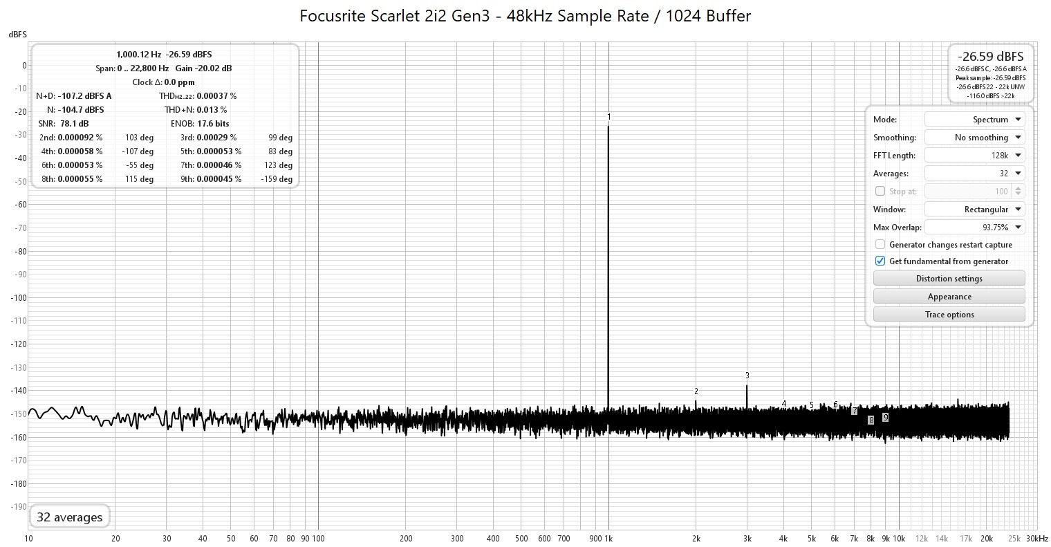

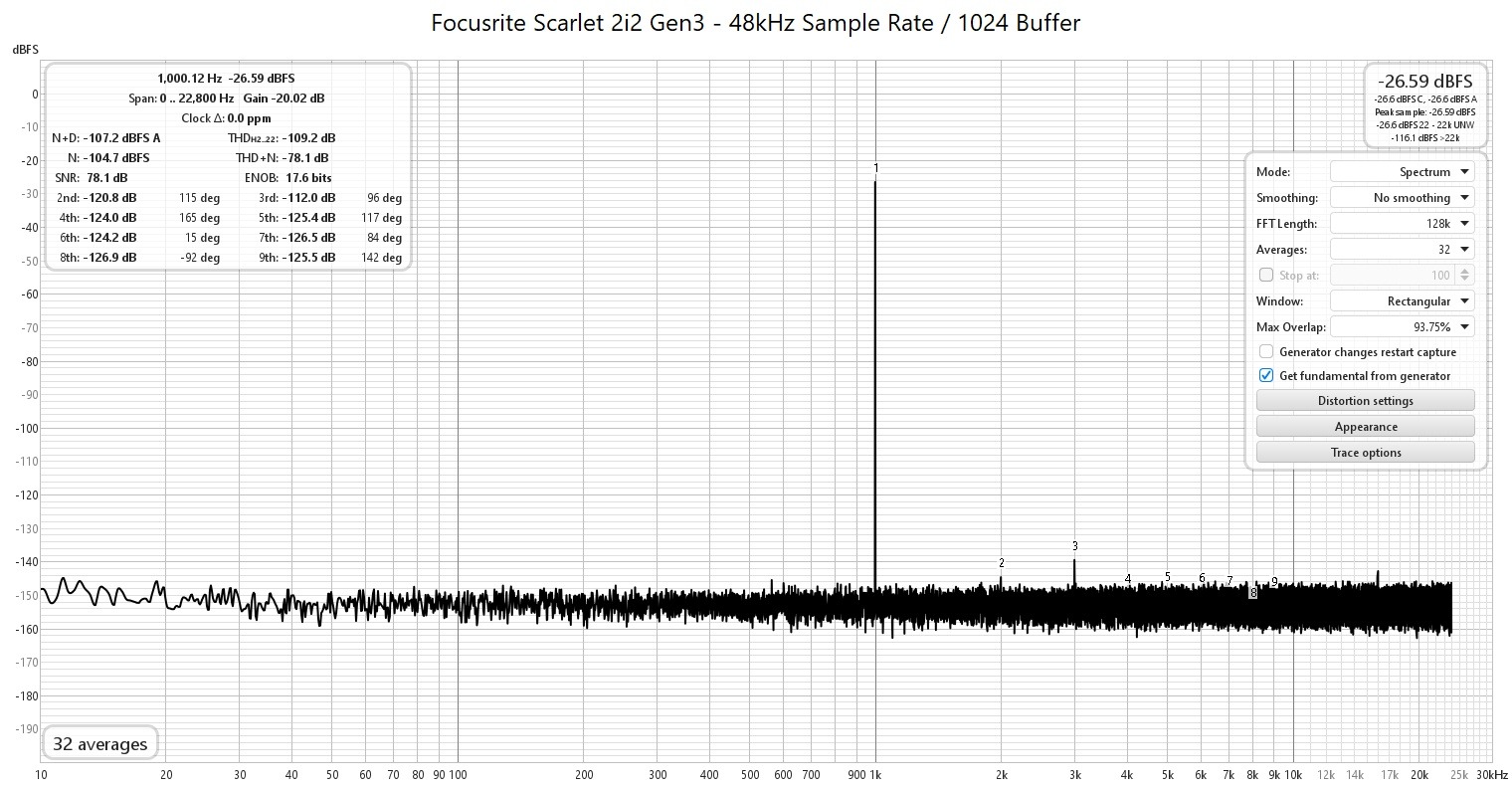

My understanding of the Focusrite Scarlett is that its best performance is when its input level knob is set at approximately 11 o'clock. That is where I have mine set, and I use an adjustable attenuator to adjust the level to the Focusrite.
https://www.akitika.com/documents/BuildingTheAttenuatorRev4.pdf
I usually aim for about -10 to -16dBFS on the FFT. I get consistent results that are repeatable, and they seem to agree within reason with expected results for the components that I have built.

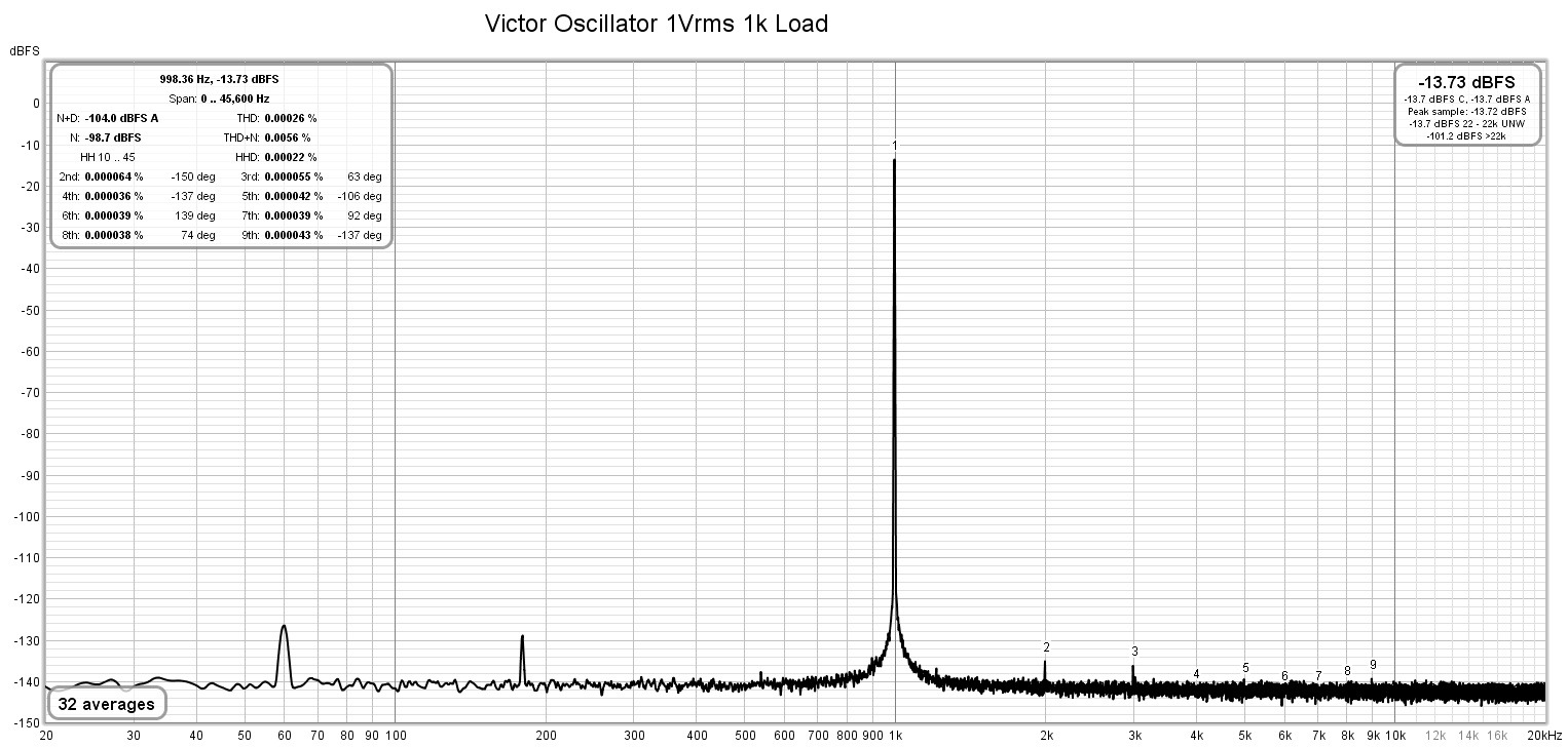

Attached is the result of the test of my earlier generation Victor oscillator. The oscillator was powered by a linear power supply and the laptop computer was on AC.
It's an older version, and perhaps the Gen 2 Focusrite was also at its limit.
However for a diyer like me, it is more than good enough as I do not build extremely low distortion audio components.

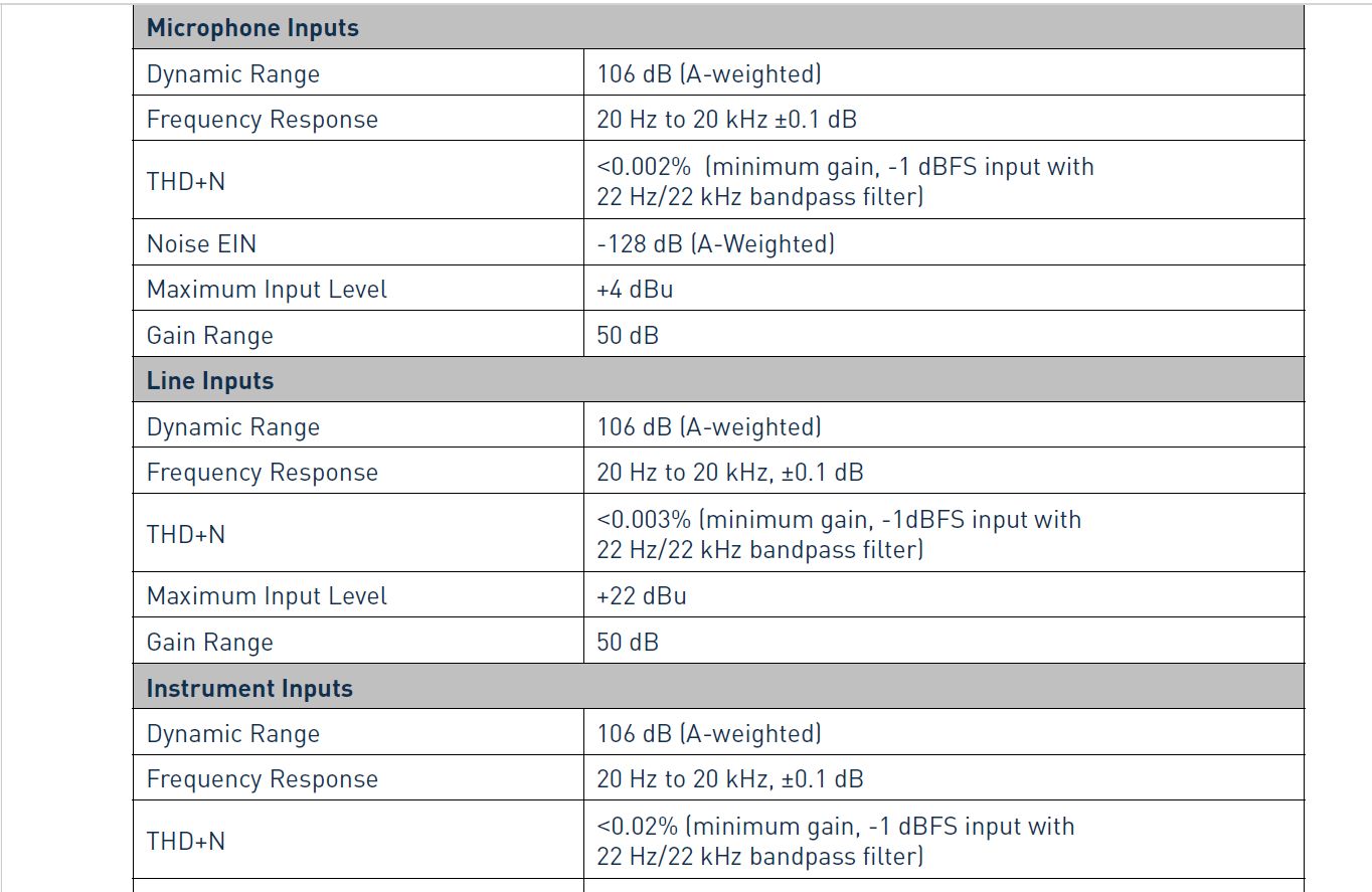

Here are the specifications for the Focusrite Scarlett 2i2 Gen 2. Newer generations have better specifications.
