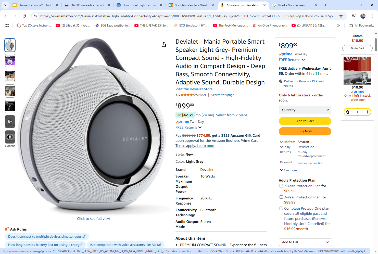

Thanks for the info, I know it's not reasonable to drive a speaker designed by crazy people, however I really want to know how they drive it (Those parameters seem unreasonable, it's a Devialet Mania speaker, it has a minimal box, and I'm using a class D tl494 (pointless adding transistors) to drive it, and it works perfectly. But you know, class Dtl494 operates at 110khz)OP mentioned a 1.6 ohm load.

The Devialet Manta is a portable powered speaker that includes amplification and equalization that is likely very optimized for the driver. So you are bypassing that? I expect it has a low impedance driver to enable a very low battery power supply voltage.
