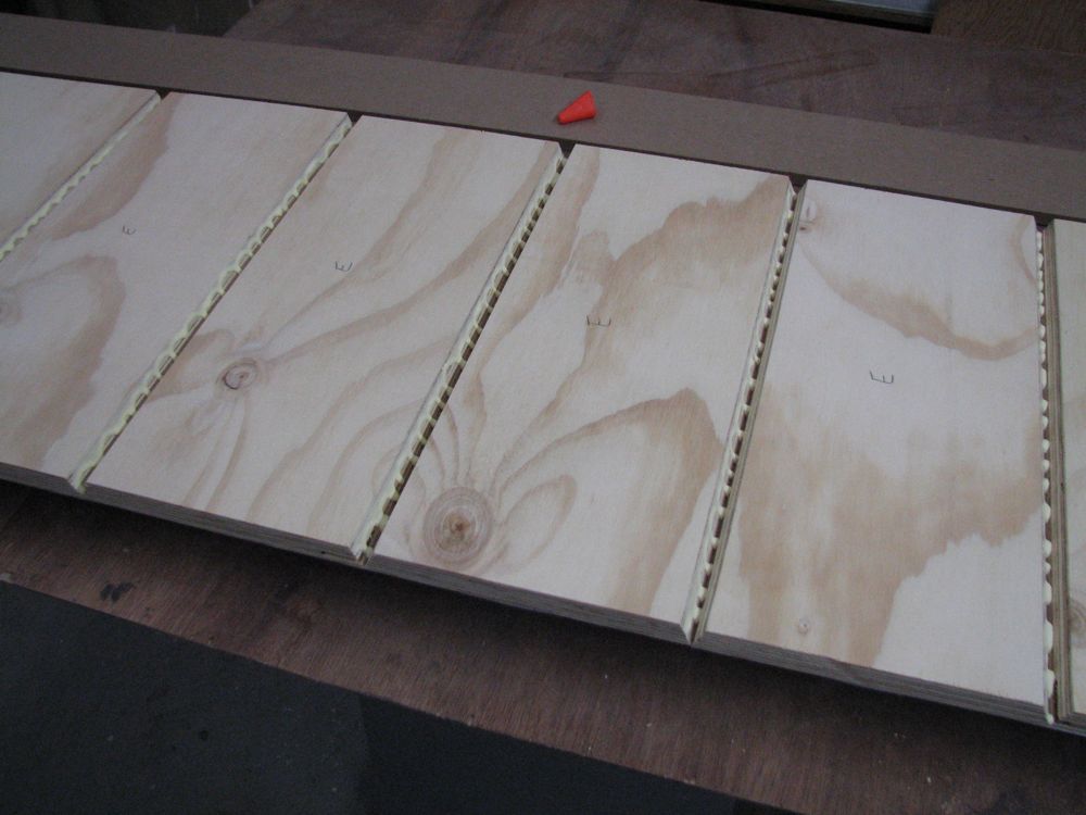

MJ is close. If you simply run a bead of PVA along the joint allowing for a dot or two of hot glue by either leaving a small gap in the bead of PVA or even creating a little circle to add the hot glue into. You might also use tape as a clamp if you are worried about the hot glue not holding it well enough.
Using a needle to apply the PVA will leave you with a rather weak joint I would think.

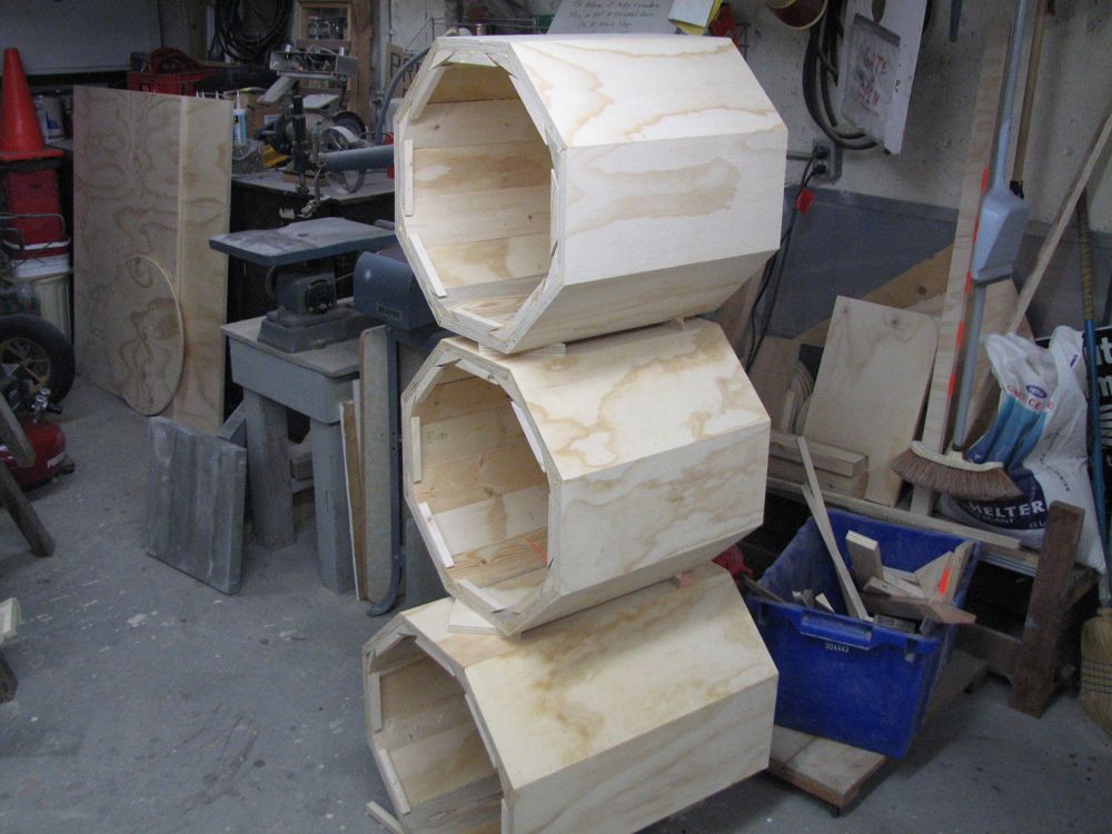

Muddjester, thanks for the cutaway diagram! Since the 45 degree bevel is wider than the tilted thickness of the triangle edge, the only way I have found to make the seams equal width for glueing is to use a thinner square or thicker triangles.
Squeak, yes, I do think wistfully of getting into production again. I have tried a couple of times but with no startup capital it's more self-abuse than a real business.

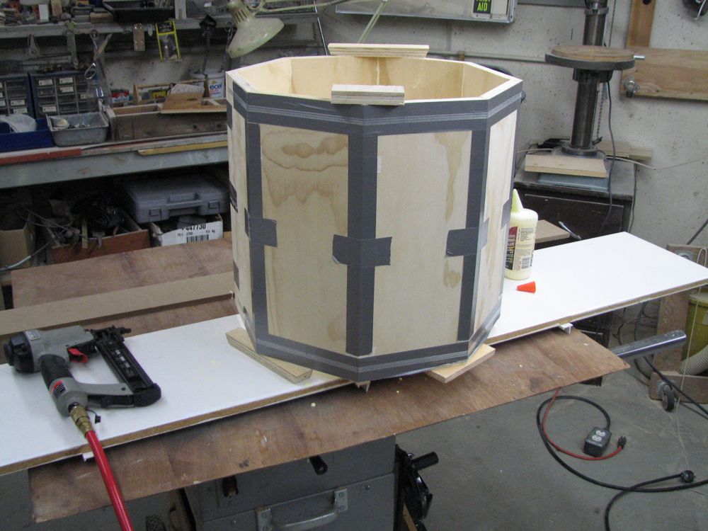

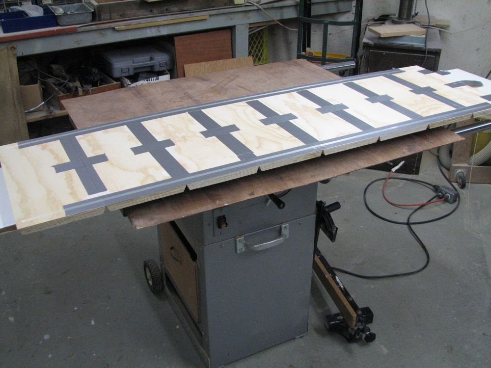

What we found worked well for wood was simple Elmer's regular or carpenter glue. For a clamp we stretched short lengths of duct tape across the edges on the outside while they were drying so that the tension would press the bevels together. Of course, we paid for that when we found that duct tape tends to leave a residue on the wood that is problematical for staining and sealing. I have since been told that packing tape leaves much less residue.
I had no residue. I wonder if my boxes were in a cooler enviro?
Tape residue is usually easily removed with household ammonia.
I used duct tape backed up with fiberglass tape (thin strip on top) for the extra strength while under tension.

Good point Cal. Florida is where we were and the building we rented for manufacturing was not air-conditioned. Maybe if we had tried it further North it would have worked better. Does ammonia give any issues with stain or polyurethane? I should have spent more time researching solvents. Live and learn. I don't repeat mistakes a lot -- but I do seem to make all of them once.
Ammonium hydroxide is residue free so it would depend on the water they use to dilute it for household ammonia.Does ammonia give any issues with stain or polyurethane?

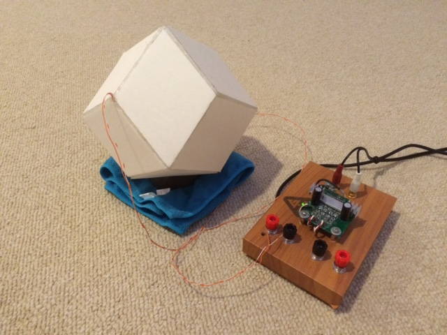

I aimed the front of the driver into a 3in dia paper tube sitting on microfiber cloth to limit output only to rear re-radiated emission. The driver face is pointing down and the mic is horizontal at 0.5m away. There is quite a bit of emission and it sounds pretty good playing saxaphone jazz (Paul Desmond). It sounds uniform like a sphere emission - uniform everywhere in 2pi space. I was listening to it on the floor and it sounds good. For the measurement I elevated onto a stool at about 30 in high.

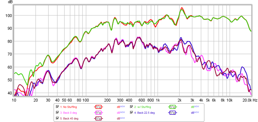

VERY cool and interesting, xrk971. Your tests are confirming what witnesses have been telling me for decades. We obtained this sort of effect (anecdotally, alas) even with heli-arc welded 1/8 inch aluminum. On occasion, we have constructed the shape out of much thicker materials sic as 1 inch particle board. When we did that. what we tended to notice was much the the same quality of sound in the frontwave as before, but a reduction of the passive radiation. In other words, same fidelity and transient response, but less omnidirectional sound.
I did a few more measurements at 22.5 deg, 45 deg, at 90 deg it is symmetric so would look like 0 deg. It is pretty uniform. Overlaid are the on axis direct radiator measurements. Same distance, same amplitude drive.

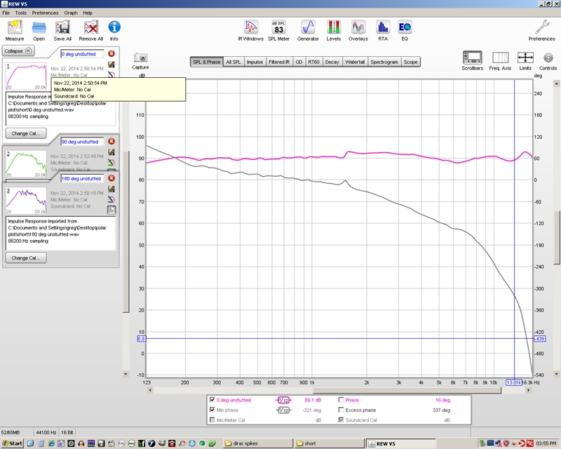

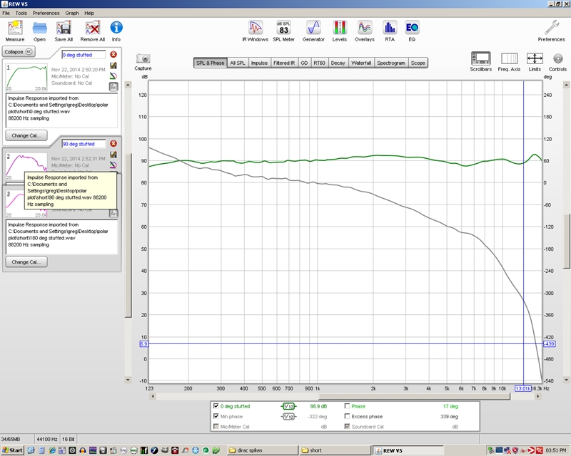

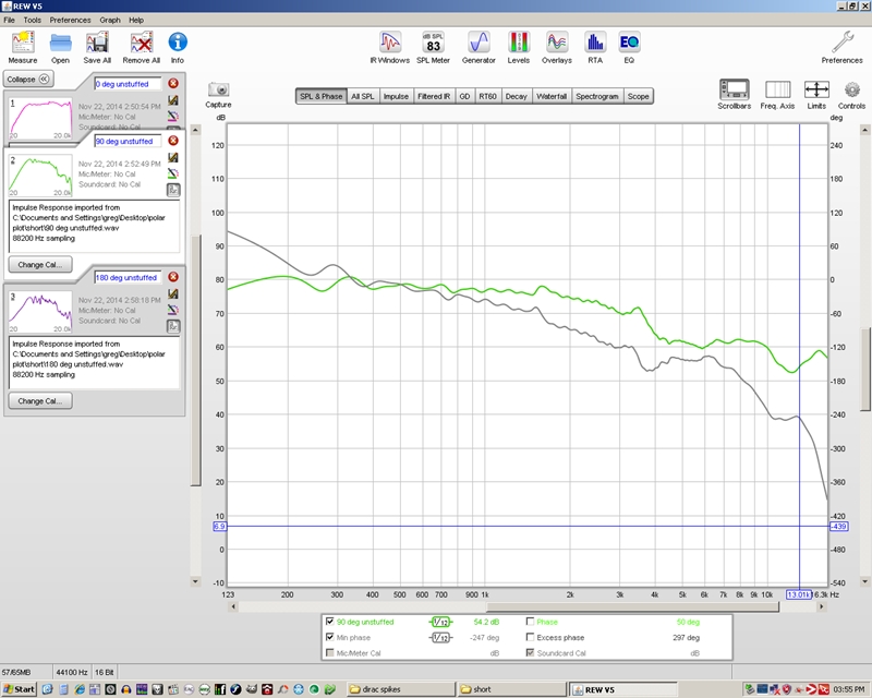

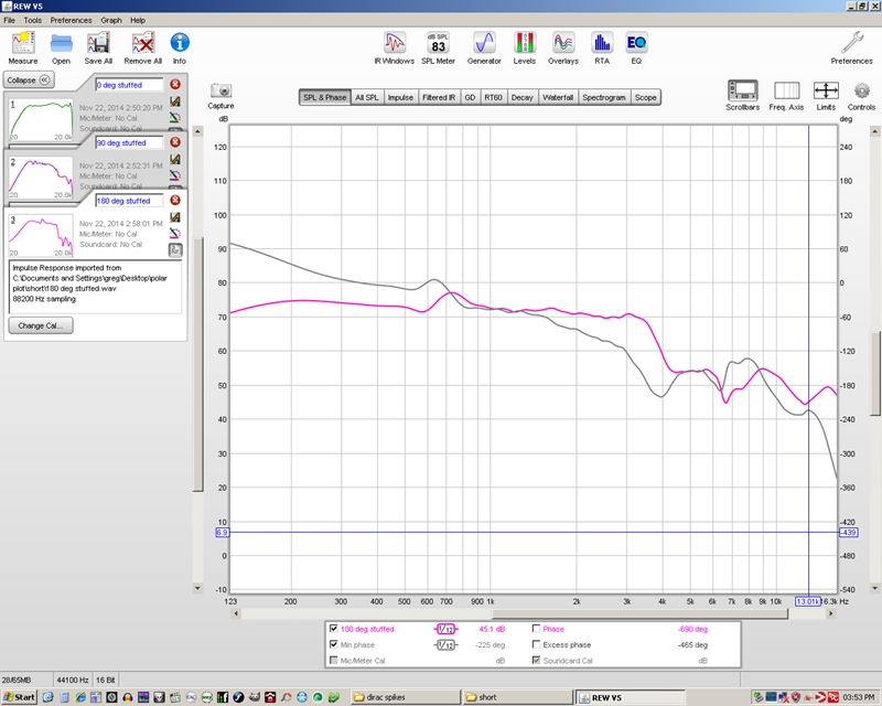

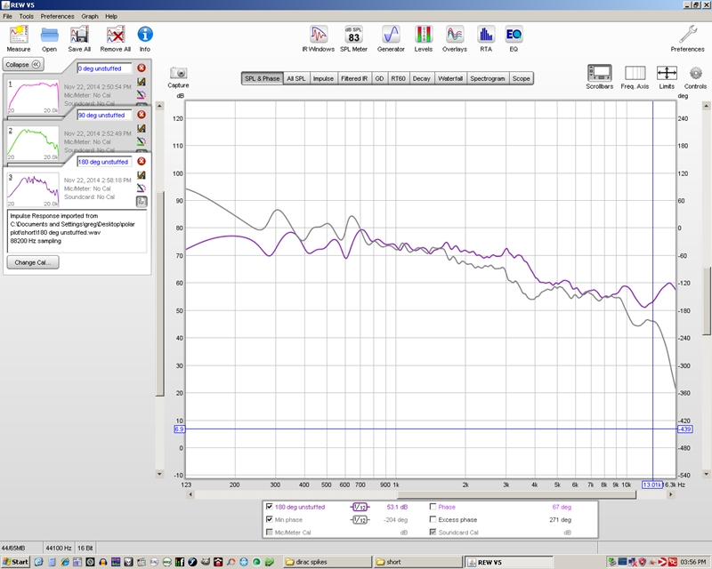

Freq and minimum phase response at 0, 90 and 180 degrees with and without stuffing.
![450038d1416688842-hypercube-loudspeakers-0-deg-unstuffed.jpg](https://www.diyaudio.com/forums/attachments/full-range/450038d1416688842-hypercube-loudspeakers-0-deg-unstuffed.jpg)
Those measurements look very nice - the 0deg is very flat - what driver is this and how far away are you measuring? I know of no full range driver that is this flat and reaches 20kHz without breakup modes.
The 180deg starts dropping off at 3kHz like mine.
How far away are the walls in your room?
