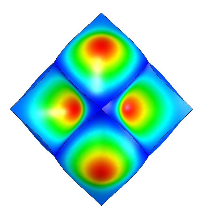

Glad you like them, I'll try to get the rest done today (kinda doing this on small breaks at work). That mild peak at 3.4K could be the first mode at which the panels are resonating. The mode shape has the back four panels flapping like drums (I can post a pic if you're interested). So if a 360° polar plot was made, I would expect to see that the most in the back, probably slightly to the sides.MuddJester:
Wow. Thanks for your work. The thumbnails look great. Indeed, I observed a mild resonance at 3.4k and I suppose if dig deeper into the decay I'll find one at 4.4k as well.
Sorry to confuse you about the group buy thought. I'm just trying to provide some technical help for others to build these.
xrk971's enclosure looks great! That's amazing, I should pick up some of that foam board. Is that just from an art supply store?
And in case anyone is still confused about the shape I made a 3D PDF of my model with the shape solid (not hollow). It's attached. Comes up pink on my screen, I don't know why...

I re-ran the modal analysis with the new panel size of 4.124". I think I made a mistake on the thickness in my first scaling of the model because I got some pretty different numbers. I double checked, I'm much more confident in the new numbers (plus I re-ran the 4.25 and they are more in alignment with the new results now that I'm sure the model is correct). The first mode (back panels resonating) is 1476 Hz. Then 1529, 1541, and 1605. Sorry guys, but that peak appears to be a function of the modes of the box. If the box is radiating, analysis seems to indicate it's not broadband. Polar plots would be really great to see if this is what's happening.
I've attached the image of the first mode, looking straight at the back of the box (speaker panel is parallel to the screen, facing away), Colors indicate displacement of the model at the peak of movement. The rest of the box is blue.
