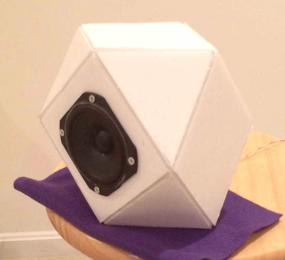

This speaker is perfectly suited for foam core: fast and easy to make, and hardly uses any material. The shape of the speaker uses very little foam core that I think a 30in x 20in sheet could probably make 4 or 5 speakers. I am using the Vifa TC9FD which I know the response of very well in a variety of cabinets. I made the square baffle 4.62in and all the other edges 4.00in. I made 2 patterns: a triangle and a rhomboid then used them to cut 4 triangles and 8 rhomboids, then a square. I added a triple-ply cardboard layer behind the baffle for screws to mount the driver. Cutting the pieces took about 15 minutes, hot melt gluing them another 30 minutes. The speaker was done in under an hour. Like Tesserax says, it is a floppy contraption until the last few panels are glued in place and then it is very stiff. Hot melt glue is the way to go - very fast and easy - only 2 sticks needed.
Here is a photo of the completed speaker - it has a nice flat for resting on surfaces. I wish one of the surfaces would allow it to slightly tilt up, but no luck there. It tilts either down or is level.

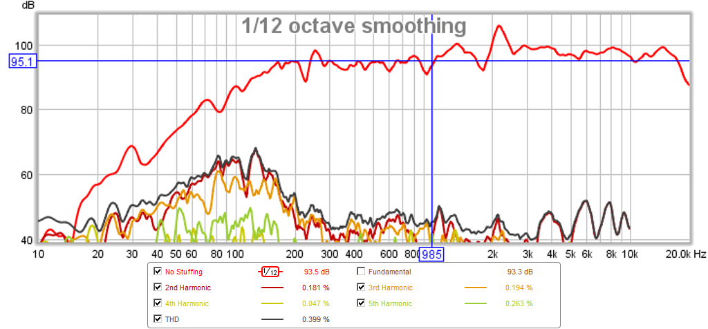

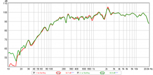

Measurements were made at 0.5m distance, amp is custom TPA3116D2, mic is Dayton UMM-6. Software is REW 5.0 with HP Mini110 netbook. Here is the measured frequency response and harmonic distortion at 0.5m away with no stuffing, there is a resonance peak that is not normally there with other cabinets. I think this looks a lot like a good sealed cabinet, and a lot like the Nautaloss in smoothness, but the Nautaloss is smoother. You have about 4 or 5 dB baffle step loss below 1kHz, and the diffraction effects appear to be minimal:

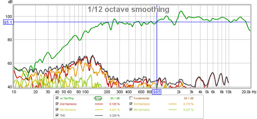

Here is the measured frequency response and harmonic distortion with loose polyfill stuffing - smoothed out some of the peaks and dips. The stuffing really does reduce the harmonic distortion levels though, which are excellent and typical of the TC9FD:

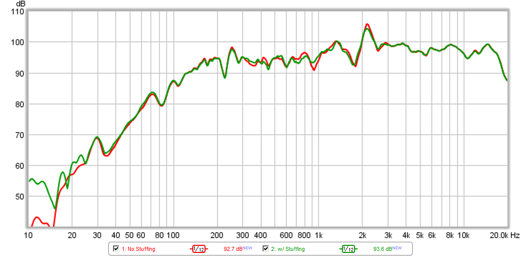

Here is a comparison of the response with and without stuffing - the no stuffing case is very similar to with stuffing - not too bad. The cabinet does indeed do a good job of controlling major typical boxiness resonances internally:

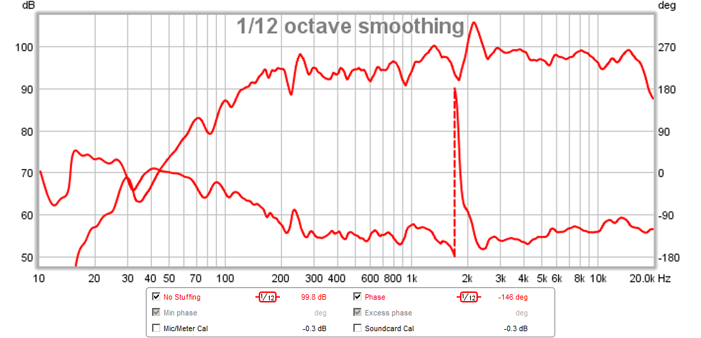

Here is the response (no stuffing) showing the phase - which shows a dip at 1.7kHz that causes a phase discontinuity because the phase was so close to 180 deg already, the dip is flanked by a couple of large peaks, with the bigger one at 2.2kHz (this level would be audible with certain songs). This must be the cabinet's characteristic resonance frequency. Probably latex caulking and a second layer of foam core for constrained layer damping would clean this right up:

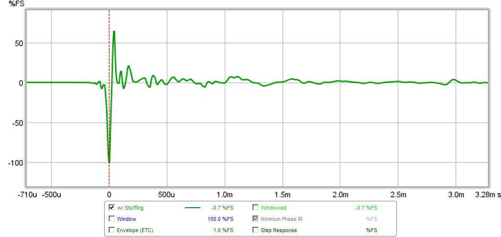

Here is the impulse response with stuffing (without looks the same) - very clean:
![449743d1416545347-hypercube-loudspeakers-hypercube-no-stuffing-hd.png](https://www.diyaudio.com/forums/attachments/full-range/449743d1416545347-hypercube-loudspeakers-hypercube-no-stuffing-hd.png)
![449744d1416545347-hypercube-loudspeakers-hypercube-stuffing-hd.png](https://www.diyaudio.com/forums/attachments/full-range/449744d1416545347-hypercube-loudspeakers-hypercube-stuffing-hd.png)
![449746d1416545347-hypercube-loudspeakers-hypercube-stuffing-compare.png](https://www.diyaudio.com/forums/attachments/full-range/449746d1416545347-hypercube-loudspeakers-hypercube-stuffing-compare.png)

Oculi, the rhombic dodecahedron normally has only rhombi (12 of them) except when you truncate it. When you truncate back one of the 4-edge (pyramidal) points it makes a square baffle plate. You can see from #113 that the rhombi can appear to be squares when seeing them from a slant instead of straight on.
cheers, that explains why the photo looks the way it looks, the baffle looks like a square because it is a square!
In a word, wow, xrk971. I have never used foamcore and had no idea it was such a fast prototyping material. Obviously I need to get out more often. Can I ask your opinion of what differences, if any, you have noted with speakers in the past between wood and foam core in terms of sound quality?
You can tilt it up though. When I make this shape, I like to situate it so the woofer is facing up at a 45 degree angle similar to the effect caused by the speaker stands I remember seeing. Granted, with light cabinet materials it can be unstable with the weight of the driver tending to roll it if jostled. But the woofer can also be faced parallel to the floor as your picture shows.
I am biased as I have only made speakers out of foam core (except for one which used a masonite front baffle). I think they can sound excellent if braced, and in some cases, if constrained layer damping (CLD) is used. For CLD, I use 2 foam core layers and latex caulking in between. This can substantially reduce resonances that lead to harmonic distortion. You can see from my measurements that the HD is quite low above 200Hz. Below 200Hz, the foam core can buzz more - but a lot of that is also the driver having lots of distortion due to large cone movement. My tractrix synergy (Trynergy) horns sound amazing:-55dB HD from 200Hz on up and 110 dB sensitivity. Those have to have CLD to work right though.
