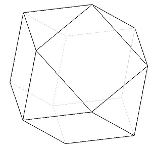

For the geometrically challenged.....I've looked at the links, but really don't have a good visual on how to efficiently cut the pieces out of wood and to see what it looks like from all sides; a cut sheet showing the bevels would be immensely helpful. In one photo the enclosure appears to sit flat and in another it appears to be angled or on edge. (I think I read) Are you planning on showing a "practical" step by step build or do we just have to buy the book?

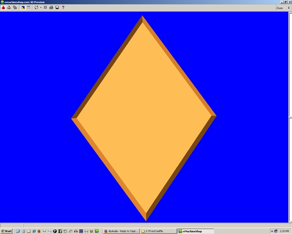

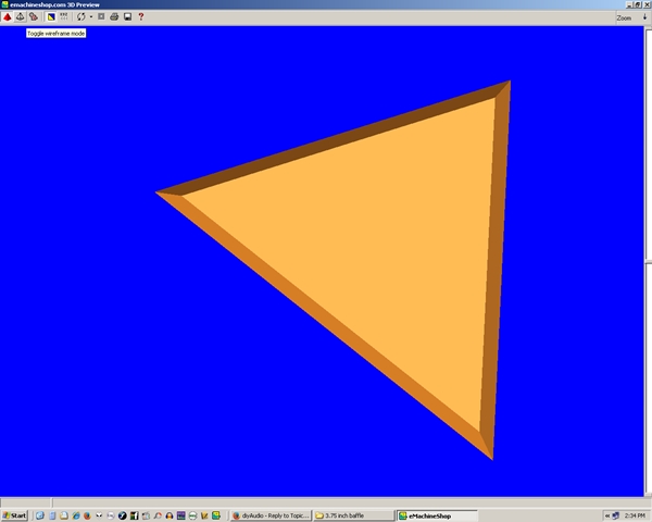

I hope these CAD screenshots plus the pictures at Futiquity help. If I may suggest constructing a paper model first:
Paper Model of a Rhombic Dodecahedron
I drew pencil lines on mine right away cutting each rhombus in half along it's minor axis (lines running across each rhombus connecting the two obtuse corners). This made it much easier to see the pyramids. It can be a difficult shape to get your head around at first since there are two types of corners : one where 3 pieces meet and another where 4 meet (pyramid points)). Once square truncated, the enclosure can be situated in two ways. One way is with the driver facing you straight on (like with a typical enclosure) or you can rotate the enclosure 45 deg and the driver will be facing up at 45 deg. --Greg
Must have missed my post #34:
http://www.diyaudio.com/forums/full-range/265053-hypercube-loudspeakers-4.html#post4126628
Take above shape and lop off one pointy vertex to get a square baffle.

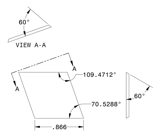

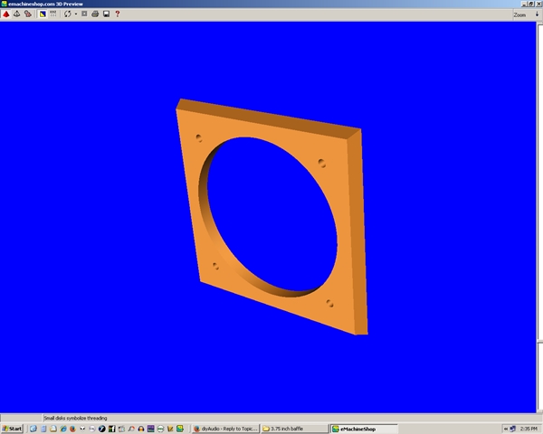

End result of cutting off one of the corners looks like the attached image.
I've also attached a technical drawing of one of the Rhombic sides. If that's what others would like for making the parts I can make a full set for all three parts needed. The sizes in the drawing are with the square baffle at a length of 1. I noticed that my angles are slightly different from posted earlier, not sure where the difference comes from, but these come from my CAD model which is based off of geometry. I'm sure my numbers are correct.
Just for fun I also set the baffle length to 4.25 inches, made the walls 6mm thick and set the material to acrylic and ran a modal model. Of course this assumes perfectly joined corners and there was no speaker, but the model showed this thing is really stiff. The first mode (not including the square baffle moving like a drum) was at 3404 Hz. Then jumps to 4435 and on up.
