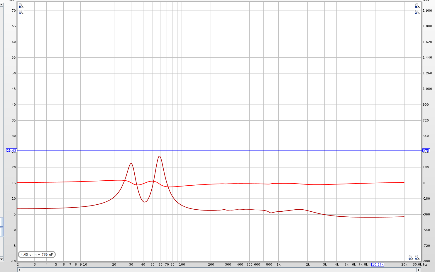

I now have impedance measurements of my speaker, though it dropped lower than I thought in the tweeter region it shouldn't be that bad since if I remember that Nelson said that the Aleph J works fine with 4 ohm, though it can output less power with such loads.
If you readers here want to I can parallel both my Aleph Js and redo my test, for if I have understood correctly that would give each amplifier an easier load than 4 ohm.
