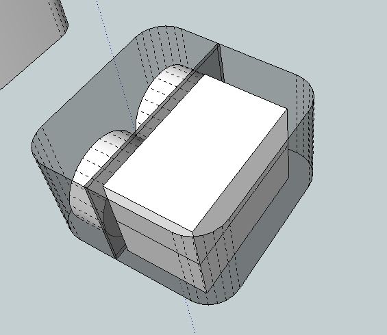

Thanks for the comments guys.
You do realize there is no one-size-fits-all-and-everybody-is-happy enclosure; though we did go for the one-size-fits-most. ;)
When deciding dimensions we took everything into consideration and we also examined various alternative designs like the ones proposed.
We settled for this cube-like 3U design for various reasons.
It's short enough to fit in most racks/shelves but also tall enough to not look funny or "lost" when you place it on the floor next to your loudspeakers (where monoblocks actually make more sense).
It's small enough to fit a monoblock amp/smps without looking empty but also large enough to fit 3 (maybe more) channels with a clever arrangement and utilization of the added flexibility the height and panels provide. I've even managed to fit a dual mono amp (2xNC400s, 2xSMPS600s) inside, but I bet wiring will be a challenge on that one!
Moreover, it's ratio of height to width/depth in conjunction with it's curvy design make for an aesthetically pleasing, unique enclosure.
These are all advantages that come from the added height, which, IMHO proves it's not really "wasted space".
There are plenty of enclosures out there for someone who wants a 450x300x60 or something more..ordinary - though I doubt you can fit that much more stuff in it (plus these will indeed look empty and a waste of space if you try and use them for a single monoblock amp).
Last but not least, me and my friends like it more than any alternative. :eek:
Remember that we originally picked this for our own use and we just have a few to "spare" - of course there are more than a few available in case there is enough interest.
Please take the time to draw a quick sketch and play around.
Internal dimensions are 184x184x112mm and you can find the dimensions of the Hypex modules in the respective datasheets.
Also create a mock enclosure out of paper or something at 200x200x120mm. You'll see it's actually really small for the stuff you can fit in it.
I'll ask SilliconRay regarding the option of having them anodized in black upon request (perhaps with a small surcharge).

I too will be placing the amps next to the speakers however I want an enclosure that will look good if placed that way or not. If I was thinking of functionality alone I would have the power at the back (and inputs) and output at the from in which case a square design would be fine.
It's helpful to know about the module placement. It was just that in squeezing the modules and leaving enough room for the switches, speaker bindings etc and connections internally, they would have been a couple on mm apart. The bespoke layout gives a bit more room but not excessively so.
That's the issue with 1U and "1.5 U" (60-65mm) enclosures.
They "disappear" or look plain funny if you place them on the floor next to a loudspeaker.
