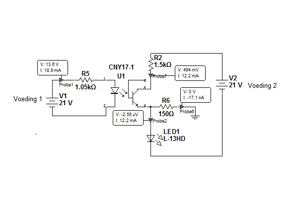

It seems this is more compicated than I thought as they seem to operate at much lower voltages than the 21V aux output unless someone can point me in the direction of a suitable 3mm flush mount clear blue LED.
Look up the specs of the LED and fill them in here: LED Series Resistor Calculator if you don;t trust your maths. It'll give you recommended resistor values (pick the "higher" value).
As you're going down the low-waste route anyway (class D), if you can get your hands on them, I'd use a low power consumption type led (~5mA). Seems a bit of a waste to dissipate nearly half a watt for a single LED when the total idle current for the NC400 is ~4.5W.

I am making monoblocks so just need it to indicate when the SMPS is switched on.
You can use the right part of the circuit then. Leave out the optocoupler.
The LED I use is also a flat top type (L-13HD) from Kingbright. I used a little bit of silicon rubber to hold it in place. Silicon rubber can stand a lot of heat so no worries here. It is also easy to remove again.
I also have a 10 mm front panel, just drill a hole at the back of the panel large enough to fit the body of the LED. Be carefull not to drill it all the way through. Then a 2 mm hole (depending on the front size of the LED) in the centre of the larger hole. If the LED needs to be brighter use a lower value resistor, 1K or something like that. The resistor must be able to handle about 1/2 watt
Thanks, I was thinking of using silicon too. I thought I just need a resistor on the positive side of the circuit. Do I need something more? I was thinking of buying a 1K resistor and one or two of higher resistance to try too. I have all the measurements for the drilling.
You can also leave out the second resistor (150 Ohm). Forgot to mention that.
You can use some nice screw terminal blocks to connect the wires and some spacers to mount it all to the front panel or somewhere else in your enclosure. you don't really need all this, but it surely looks nicer and and with a euro circuit board it is a piece of cake to mount all components.
Perhaps a euro circuit board to mount all components. Cut it into the right size.Do I need something more?
Use a 1K resistor for typical use. If this turns out to be to bright then use a higher value resistor.
EDIT: in my opinion they are to bright to be used in the front panel. Unless you want to light the room with them.
I don't want it too bright which is why I ordered the lowest light output I could find (though maybe I should've asked for help first). Most were many times brighter than the ones I ordered.
What resistance would you suggest for the LEDs I've ordered to reduce them to a normal fascia level?
