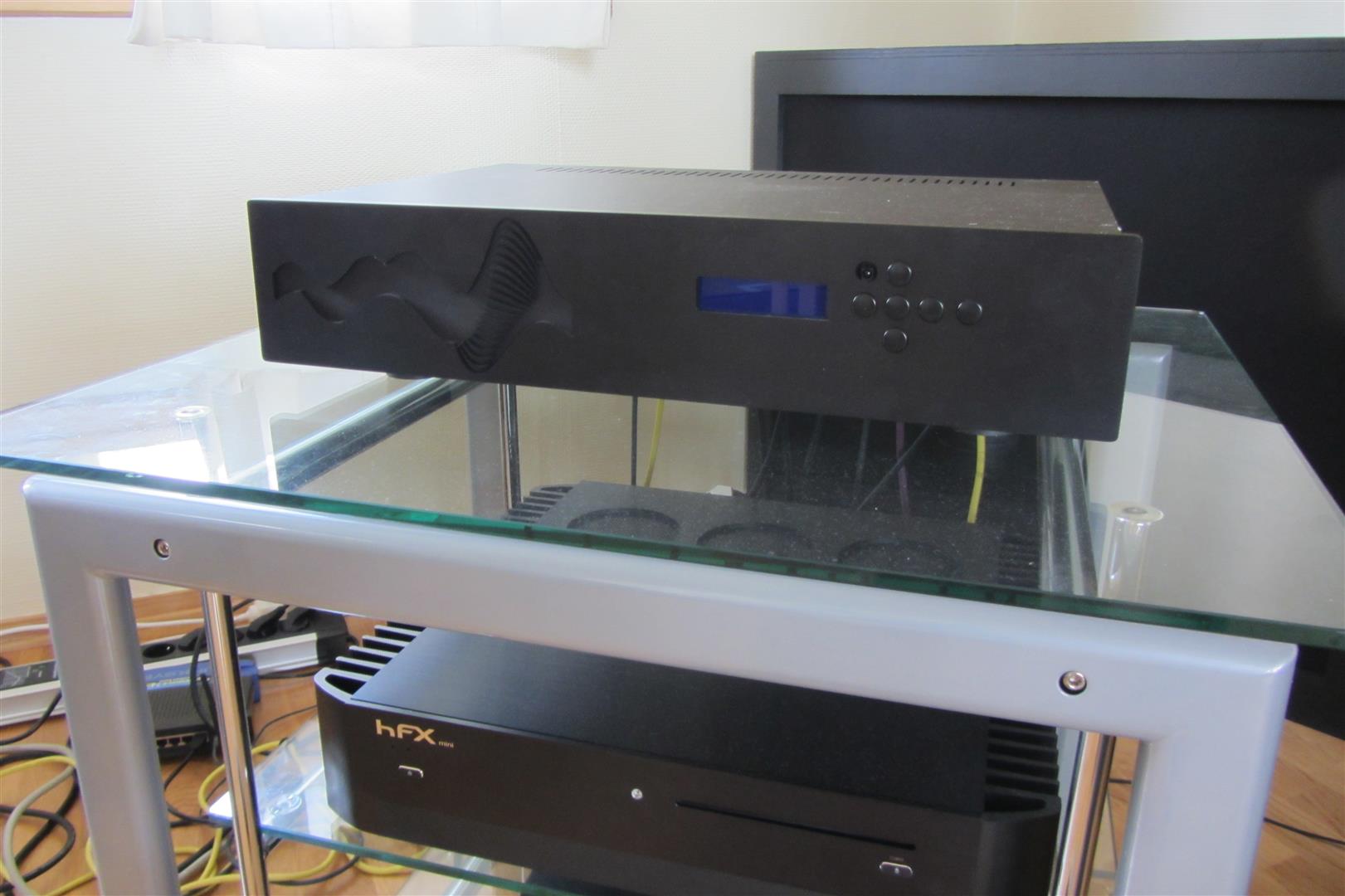

That's correct. I got the design from ds23man (active in this thread). He is the one behind it, not Modushop. Ask him if you can use it. It looks very nice!Just a bit off topic...
Bjørn - didn't you have a rather nice DLCP front made for you at Modushop? Was this a design they had available, or did you have to provide CAD drawings?
Johan-Kr
