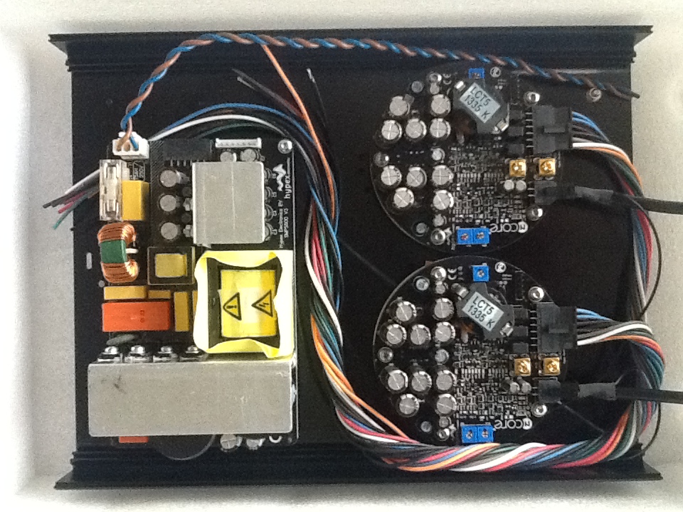

I'm in a similar situation: for active biamping, I'm going for two Ghent stereo cases, with 2 NC400s and 1 SMPS600 for each. As you know, it's pretty tight, especially for the wiring from PS to NC400s. Ghent suggested to lift the NC400s, using 10 mm studs, and route the wires underneath them. That looks like a good suggestion to me, as the studs also open up the ventilation holes in the base plate.
Did you consider that option too? Any drawbacks in your opinion?
My only concern is that that brings the wires pretty close to (and potentially parallel with) some of the high-power switching circuitry, but if it is only the power wiring, it should be OK.
My main concern would be, that those NC400 amp modules might be heating up even further, because the round heatsink it is mounted on no longer are in intimate contact with the enclosure anymore because of those studs. I routed those cables therefore "over the top" through the middle, because that stereo distribution kit from Hypex with its smallish PCB in the middle couldn't get anywhere else symmetrically.

As for the heatsinking: I could use some conductive paste between heatsinks and enclosure, but that might be messy (never tried it) and then I lose the ventilation holes again...
I did use thermal paste in between heatsinks and casing because it lowers the thermal resistance and improves heat transfer to the enclosure to some extend. Just apply only a very thin coating of it.
I don't know what you mean by "losing ventilation holes again...". There are no ventilation holes / slots underneath the amp modules, because those are only underneath the power supply. Unfortunately, those slots around the outer edge of the back plate, which the mono version has, are missing on the SE version too. I therefore drilled a row of additional ventilation holes right behind the rear and front plate as an afterthought just to get some "cold" air into the enclosure from the bottom side because Mr. Ghent never responded to my messages in this respect. The SMPS1200A400, which i used, blocks those remaining ventilation slots underneath the power supply area (almost) completely.
Note: The Ghentaudio mono cases are been used by Hypex as "their" enclosure offering with a minimaly different design.
Those additional holes / slots are sorely missing right from the beginning, because the case will heat up quite a bit otherwise (> ~45°C). I contacted Mr. Ghent about this but didn't get any answer from him except that a new version of the stereo case is in development which is supposed to be somewhat wider and larger.

My thought was to fill the 10 mm gap between heatsink and case -- goes to show how little I know about this . It's my first DIY-light project I go for...
The 'ventilation holes' I mention are the predrilled holes I don't use in this configuration. When putting the amp modules on studs, I could drill some more holes underneath them, I guess. Should allow for some sort of chimney effect!

The enclosure is part of the amp module's heat sink. You want them pressed together, maximum contact, with the thinnest of heat sink compound film. Heat sink compound has a much lower thermal conductivity than metal on metal. Think of it as the thinnest of gap fillers only. Do not blob it and hope clamping pressure spreads it. Spread it thinly as possible over the entire area.
Yes, that makes sense. So wires over the modules it will be. I'll see how I can best route them and check with you guys. Thanks!
If you "cross over" (bridge-like) those amp modules with the cables just in the middle between both amps modules you should be fine, because most of the heat is been generated by that inductor on top of the amp PCB. This way your are at least as far away from the power cord as in the mono version. Just twist and bundle them tightly. Calbe ties are your "friend" there.
Main "problem" (and attention needed) might arise from the wiring harness, because of length concern and the need to split those cables coming from the SMPS600.

I sent Hypex an email, asking for a '2 x NC400 - to - SMPS600' adapter kit. Let's see what they say...
If that kit doesn't exist, and I just solder the wires together, couldn't this (see picture) be an alternative routing? I keep the mains-to-SMPS as far as possible from anything, and the balanced inputs cross the 'power wires' (or how do I call those?) perpendicularly. The speaker wires (not on the photo) can be routed upwards first, as to stay away from the 'power wires', and cross perpendicularly too. [I haven't fixed anything for the photo - as you can see - but I hope it's good enough for my question to be clear...]

Looks good to me. The missing distance between one of the amp boards and power cables don't matter that much I would asume. I have moved the power cables upwards and afixed them to the casing to increase the distance there somewhat.
Some effort (and care) is needed to splice the PSU to the two amp boards.
I got a reply from Hypex about the NC400 - SMPS600 adapter kit. Yes, it's in the pipeline. But it might stay in that pipeline for quite a little longer, as they seem to be very busy with other matters.
So they advise me not to wait for it, and splice the PSU. For future builders it'll be very worthwhile checking the website though.
