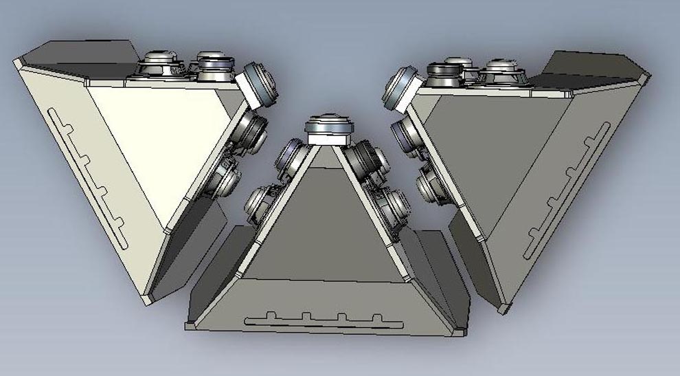

I think I read the patent a few months ago.
The way *I* understood it , it is a lot of synergy horns lined up under each other. Then by selectively delaying/advancing the signal of the drivers further to the mouth, it acts as if the angle of the synergy horn is wider/smaller than it is. (Off course the crossover range of said drivers also must be adapted to the altered entry point in the virtual horn.)
Basically this is a synergy horn with selectable beamwidth and therefore efficiency. (You can throw lots of efficient SPL in a narrow beam to the end of the venue, and as you get lower/closer to the front stage, you can widen the beam, giving less efficiency/SPL to the people nearby. All from an apparent point source.
I can have understood this wrong, but given my knowledge of line arrays and the pros and cons of different techniques for even coverage, it makes sense to me.
The drivers must be all separately amplified and DSP-ed to pull this one off, or if Danley can get this with a passive crossover I sure would like to see that!
musgofasa said:I could see doing it with passive network as the drivers are all going to be customized to the application. One thing is for certain. It should have a hefty price tag. I would like to hear it in use though. Pretty design.
Big too and i like Big! lol
Hm, still assuming I am correct, then how would someone make a passive crossover with an adjustable variable delay for each driver?
Only by going active, I think.
I expected the outer horn to be paved with mostly identical drivers, but seeing this picture, I think I should search for and reread the patent ...
Ah I didn't actually notice that comment before. I went back and read some of TD's site. It could be a really complex delay after all. I sure am glad I don't do pro sound sometimes lol. I would need way too many definitions of "line array performance" and "front to back dispersion" etc. I have never tried to work with such a large area as a concert venue and I know nothing about that sort of thing lol. I was only thinking of Danley's custom drivers. He wouldn't need an active crossover just for frequency corrections, but to get all the details described, I think you might be right. Don't forget, I am frequently wrong lol.
"Shaded Amplitude Lens"??? Interesting.

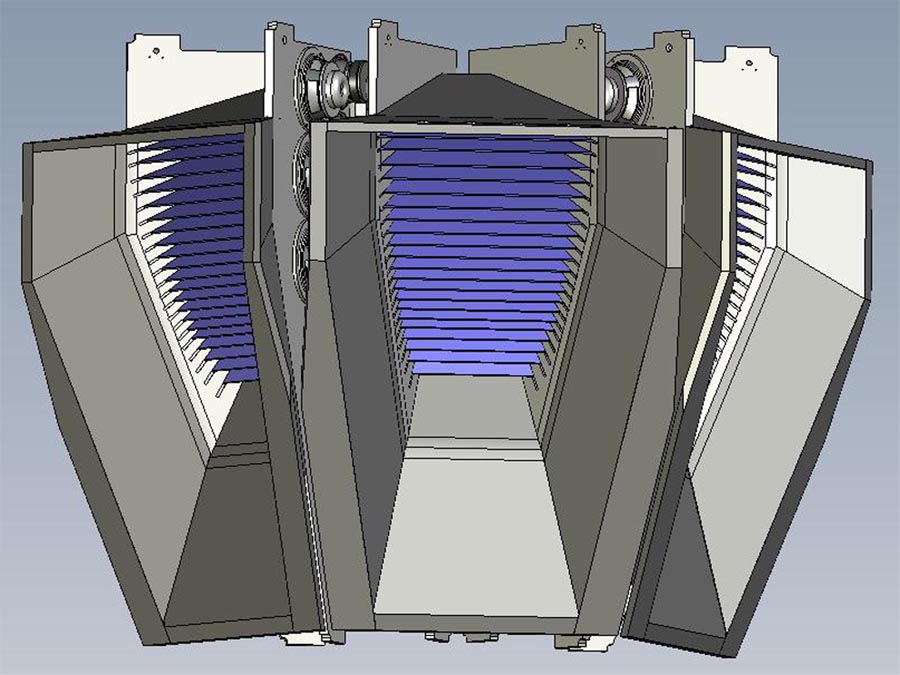

I have attached a drawing from the front side.
Each vane you see represents a step of 1.5, 2 or 3 dB with down (the front row) being the lowest level. Pix2
