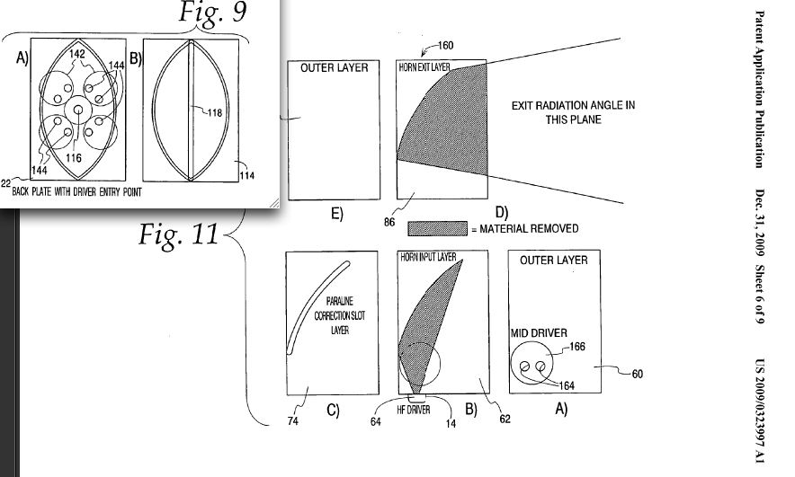

while reading the paraline patent:
Horn-loaded acoustic line source - Google Patent Search
Fig.6 is there any restriction of A1 length? say max A1 = min lowest cutoff freq?

A1 is 1/2 the length of the exit slot. The cutoff frequency is determined by the size and shape of the horn.while reading the paraline patent:

I don't know if there would be a practical limit on the slot length, but 9.75", over double the size of some 1" Paraline devices used by VTC, worked quite well for me.

Hi Art
One can make a Paraline any desired size if pattern control over driver density is the object. There is a 60 inch tall one at work made like the one in fig 9 except it has 6 mids. I have a smaller one at home that is very hifi and I have hopes to do that with it.
The important relationships; When A1 and B1 +B2 and C1 + C2 and D1 +D2 are all equal path lengths, then the exit wave front is a plane wave in the vertical.
If you make D1 shorter relative to A1, you end up with a diverging wavefront, if you reverse that, you get a converging wavefront, to a degree, adjustable focal length in one plane.
Mostly where I have used the Paraline is as the rear portion of a narrow vertical horn, it supplies the somewhat curved wavefront a much deeper point source would have produced.
The other part is the dimension or thickness of the passageways like as seen in fig 5. Sound will readily bend around a 90 degree corner like a fluid IF the acoustic dimension is small (for example . The thickness of that or actually the difference in the paths between the inner and outer pressure path will control how high a frequency will pass before the geometry causes cancellation and low pass filtering.
Anyway, have fun with them, I was pleased with that one, it was a simple but effective invention and it's roots lead to the layered combiner used on the J speakers and an upcoming something.

Your 12/31/09 patent application pictures would have come in handy back in 2008 when I built my Paraline small format line array.
My units all have A1 and B1 +B2 and C1 + C2 and D1 +D2 equal path lengths.
In retrospect, I probably would make D1 shorter relative to A1, though it is pretty amazing as built to be able to focus HF energy at a far distant point, counter acting the HF air attenuation problem.
Despite the line being 67.5” tall, like your stadium horns it is pretty well immune to crosswind “swishing”, but each module only ways 50 pounds, so no cranes or chain motors are required ;^).
Using a mid/high arrangement as in figure 9, what keeps the mid output from modulating the HF diaphragm, is the HF compression ratio simply enough to keep that from being a problem?
Is the layered combiner used on the J speakers like figure 9 or 11, or something different?

Hi Art
If your version is immune to crosswinds, it is radiating as if it were a simple, single source (cool) and not an interference pattern like one gets with a complex radiation source or uncoupled multiple sources. It is the porcupine appearance of the dispersion pattern at high resolutions that makes the audible swishy swishy effect if the wind blows or the system or listener moves.
Fig11 is the oldest version, the first one I built in the old days and of the two, might be closest to the layered combiner although not that close in appearance.
The idea came from thinking about the horn / reflector assembly used by telephone companies when I was a kid and and old one was used to discover the cosmic background radiation.
I found a picture of one;
The problem with doing this with sound is the wavelength varies so much that the reflector is a variable not a constant. In microwaves, the bandwidth is very narrow and the dimensions large.
It occurred to me that unlike a reflection, a pathway had no such issue, worked at any frequency up to where the passageway acted like a low pass filter etc.
If you look at fig 11 and the radio horn, you can see the direct analogy and the root for the idea.
Fig9 is fig 11 extended to full symmetry. A cool part here is on one side, the radial plane, the expansion is 360 degrees radial originating from a point, no chance for a reflection or interference in this plane while in the thickness plane, the dimension is too small to permit reflected sound.
Some of the Paraline elements, like the ones used by VTC or in the GH-60 actually show a smoother frequency response (less grass in the curve) than normal horns.
