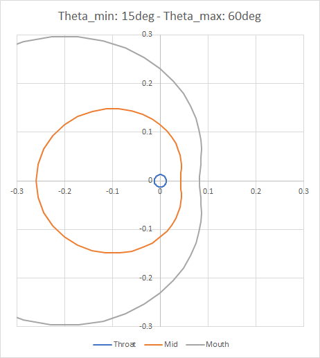

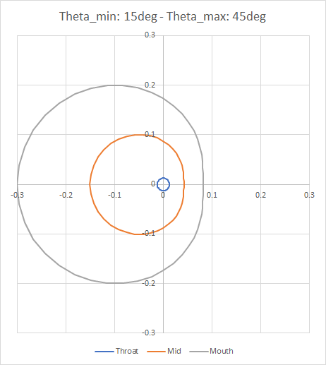

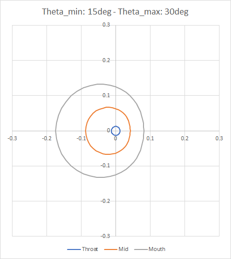

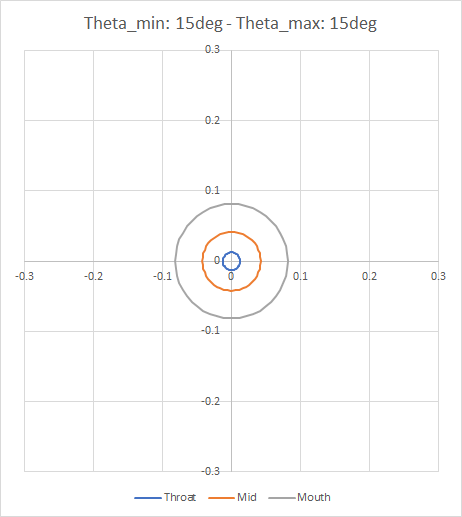

If anyone wants to tinker around with this in 3D, here's some ideas to get you started:
Understand that the waveguide is narrower on one side than the other, so the throat needs to be too. The 'trick' to getting a circular throat with a mouth that isn't circular is to 'punch' a cylinder through the throat. This gives you a non circular mouth with a circular throat. Use the 'smooth' function to minimize HOMs
More pics
The vanes are tricky. They start out razor thin at the throat, then expand as they get closer to the mouth. This is one of those spots where you really want a 3D printer. If you read Danley's posts in this thread, you'll see that there's a big argument for a large roundover on the vanes at the mouth. (Because of horn "waistbanding.") So at the mouth, you might want the vanes to be an inch thick or even more. Consider that the horn is basically behaving as if it's four horns joined at a common throat.
Now this device is hardly finished. I whipped it together over lunch. If you really wanted to go nuts, here's some ideas:
1) As Geddes noted, you probably want the compression driver to enter the waveguide at an angle. This allows you to focus most of the energy into a particular slot of the vaned waveguide
2) I think it would be SUPER cool if you did the math and made the mouth circular or rectangular. You'll need to run the numbers, but it should be possible to juggle these three variables to get a waveguide with a round or square mouth, that focuses the output OFF AXIS:
a) area of the 'slot' at the throat
b) area of the 'slot' at the mouth
c) angle of the compression driver at the throat
To understand how this works, just understand that we're taking the output of the compression driver, subdividing it into a series of slots, and then varying the mouth of each slot to achieve a specific shading. Understand that you can use log shading also; IE you could make the vanes thicker or narrower to change the shading of the waveguide. Due to HOMS, I would try and accomplish this task with a minimum of vanes. It might be possible to do this with as few as 2-3 vanes.

It seems that you left out a right bracket in your equation.
Is this the correct placement ?:
R(Phi,x) = sqrt( R0^2 + x^2 * Tan( Theta(Phi)) ^2)
I created a spreadsheet to test the formula.
X is incremented in 5mm steps. Phi is incremented in pi/24 steps.
Three plots are made of the cross-section at the throat, the middle and the mouth.
When Theta_min and Theta_max are equal it shows three concentric circles. As Theta_diff increases the circles become more elliptic and they are being offset to one side.
At first it looks like it works, but at some point they lose their elliptic shape and become something else.
Is this to be expected?
How about the center-axis? Is that supposed to also follow some curve, or should it be a straight line.

I would not expect ellipses. I would expect a straight line axis.At first it looks like it works, but at some point they lose their elliptic shape and become something else.
