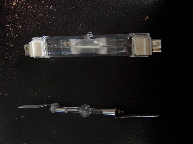

Are these new lamps you are talking about, that can work on a HQI ballast?
If so, is it only for the 400watt lamp? Do you have ones for the 250watt as well? What are the specifications etc?
yes, that can work on a HQI ballast, but that work not longer by this time. I not know the life of the new lamp.for the moment
I have two type only:
400watt lamp,AC, double end.
250watt lamp,AC, double end.

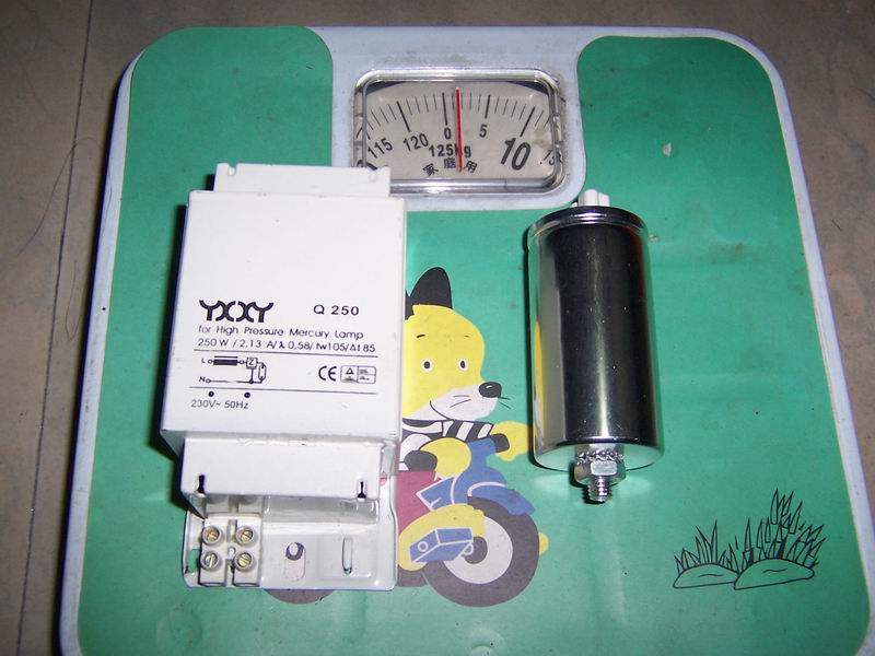

slodki said:Any updates YWH on the ballast manufacturer?
the ballast manufacturer did no answer me.
i dont need the ballast manufacturer now.,my new lamp can be run with magnetic ballast .

Speed.Cat said:with HQI ballast do you mean a "non-electronic"-ballast?
do I see this right, that a e-ballast will extend the life of these bulbs?
my first post in this forum(hi everybody!)
welcome!
yes! the HQI ballast is a "non-electronic"-ballast.
but a e-ballast, the voltage is invariablenes,about 130V-140V.
that is not good.
but the the voltage of some e-ballasts is 100V, that is good.
