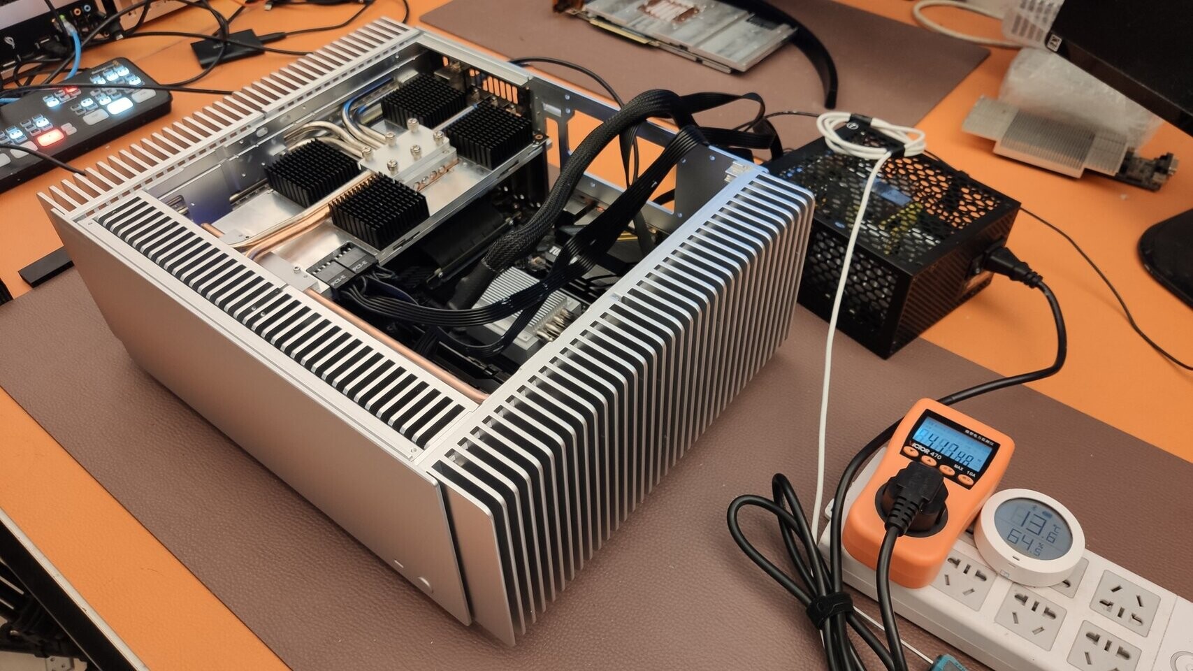

Completely passive with heatsinks across the CPU and NVIDIA 3060Ti graphics card and is running a Ryzen processor with Roon Server and HQ Player Desktop and is processing DSD 512 with ASDM7ECv2, SDM poly-sinc-ext2 successfully with no dropouts. The actual music media is stored on a separate NAS.
Computer # 2 - Roon Endpoint (NAA)
Roon End Point computer which was an Intel i5 processor and 32 GB of RAM and is completely passive with an external HDPlex 400w Linear PSU running the HQPlayer NAA image via a USB stick. This computer also has a JCAT Femto USB card and JCAT Ethernet card (standard) and both are powered externally by the 400W Linear PSU from HDPlex.
Even though I’m running two computers, the sound is still not as good as running my JAYS AUDIO CDT3 transport connected to my Denafrips Terminator DAC via i2S, let alone vinyl or 1/4" 15 ips Tape. The soundstage is not as wide, deep or as clear.

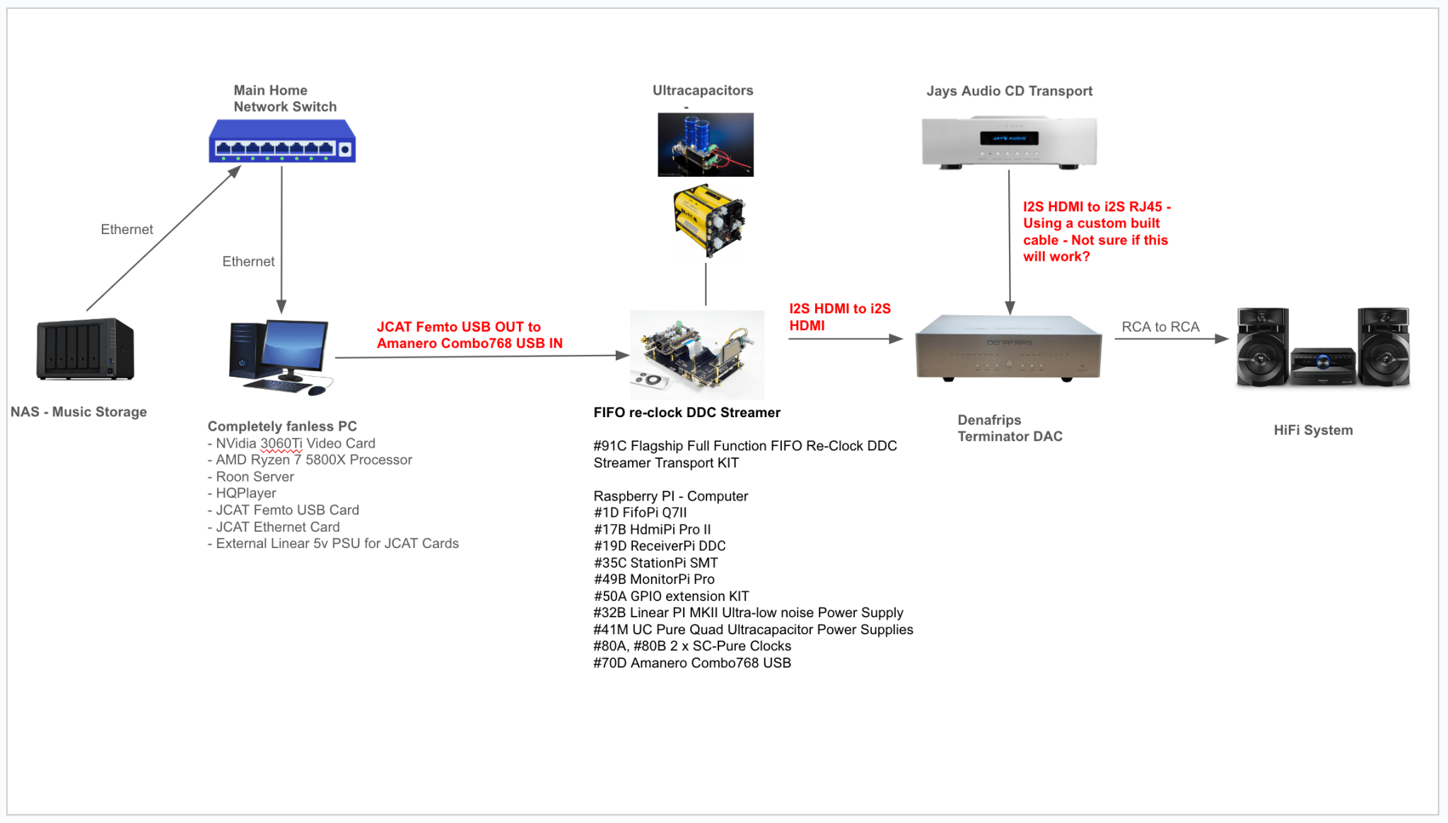

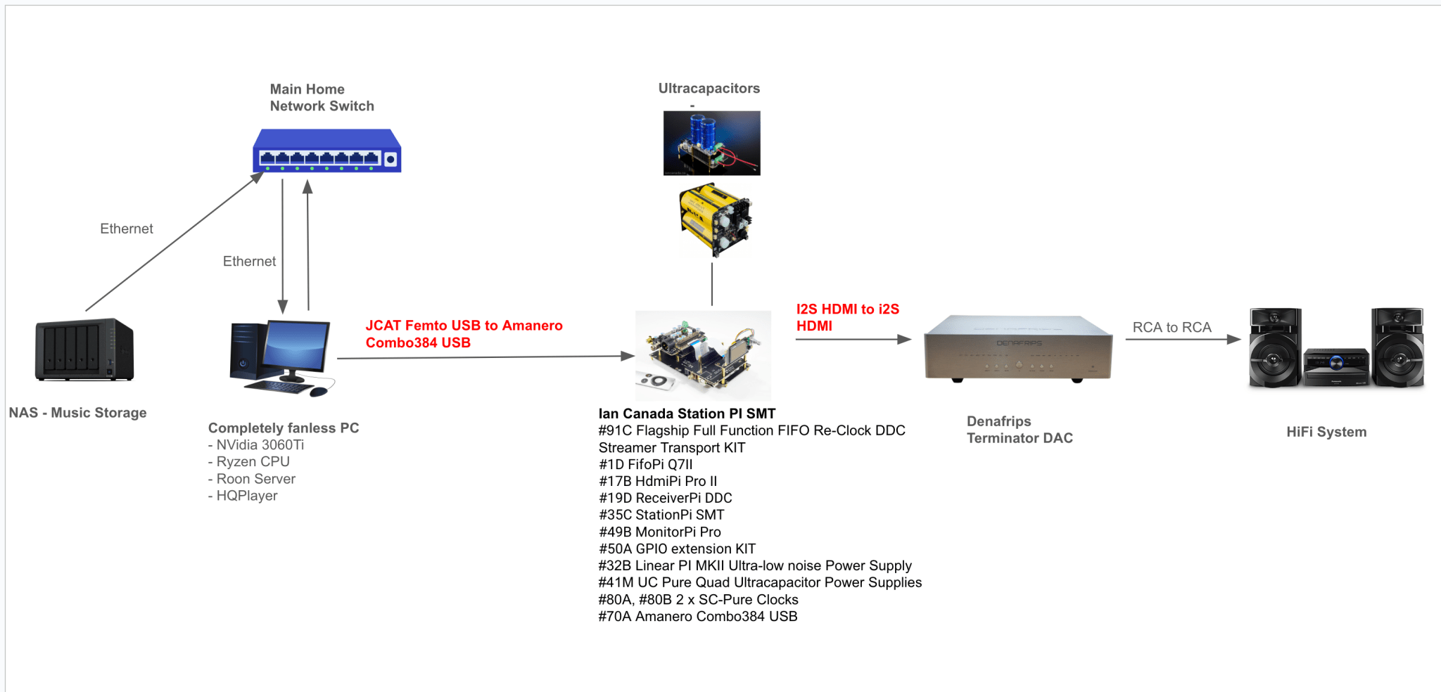

Here's what I'm currently running for the last few years
Option 1
Option 2
Use the Amenero Combo384 USB in this configuration. This eliminates the need for the Ethernet Regen switch and have both computers connected by USB Only. Will this work? Thoughts?
All parts for Ian Canada computer has arrived

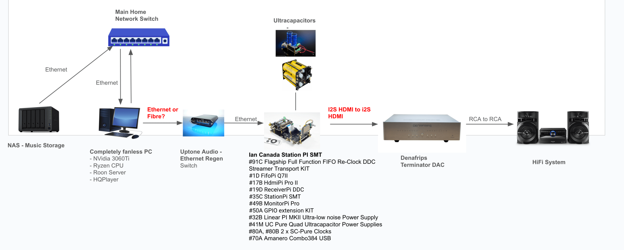

Option 1
Option 2

Thanks Fred Sonnen. Not sure why, BUT my network streaming does not sound as good as my CD transport feeding same same DAC
Only point of difference I can see is that the CD transport is connected to the DAC via i2S HDMI and the network streaming computer is connected via USB.

Hi, I love your project. This is what I wanted to do a year ago (JCAT approach) and what I want now (Ian Canada approach)
I think the design looks good. I'm curious if the fanless PC is only dedicated to audio. I'm looking at audiolinux as a Linux SO that has a real-time kernel alternative.
With your actual setup, have you tried a different USB cable to see if that makes a difference?
Hi dpak, yes the fanless computer is completely dedicated and sits within my audio rack running Ubuntu, HQPlayer and Roon. The CPU and Graphics card both have aluminium / copper heat sinks and bolted heat pipes back to the chassis walls, which have thick aluminium fins on all three sides. Including the front, which itself has a face plate cover hiding the fins. Unfortunately, the PSU itself is fanless, but is a switch mode standard Seasonic (not sure how I can change this). Thoughts?. See picture below. Haven’t tried USB cables.

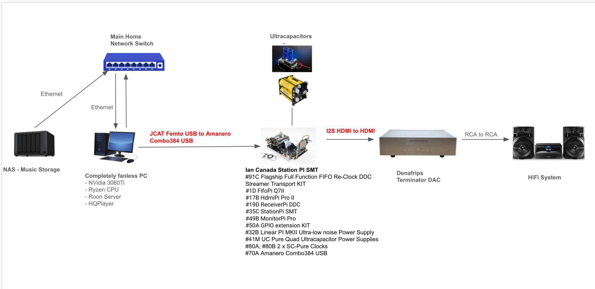

Hi All, Ian replied back and indicated I do not need the Raspberry Pi, since I'll be using the Amanero Combo768.
This makes it simpler. Final view below.
I'm guessing if I wish to use ethernet (in) on the NAA end point, then I would need a Raspberry Pi. Can anyone think of any disadvantages to this approach without the Rpi?
For me, is more neat this way, RPI free because:
- Pure DDC functionality with SO agnostic. If you want to connect your server to a HQplayer NAA using an external RPI, you can connect it to the Amanero USB. Other solutions, like Gentoo player or Audiolinux are available. This would make less sense for the JCAT cards.
- FifoPI Q7 has galvanic isolation already, so it doesn't need an Intona. You are saving money because you no longer need the Linearpi and UCconditioner for just the RPI
- Internal RPI can make more EMI noise and lower the SQ a little.
If you put in an internal RPI, there should be a reason for it, like not using the Amanero card, and using the RPI GPIO instead, or connecting a hard disk or other peripherals like a screen.
