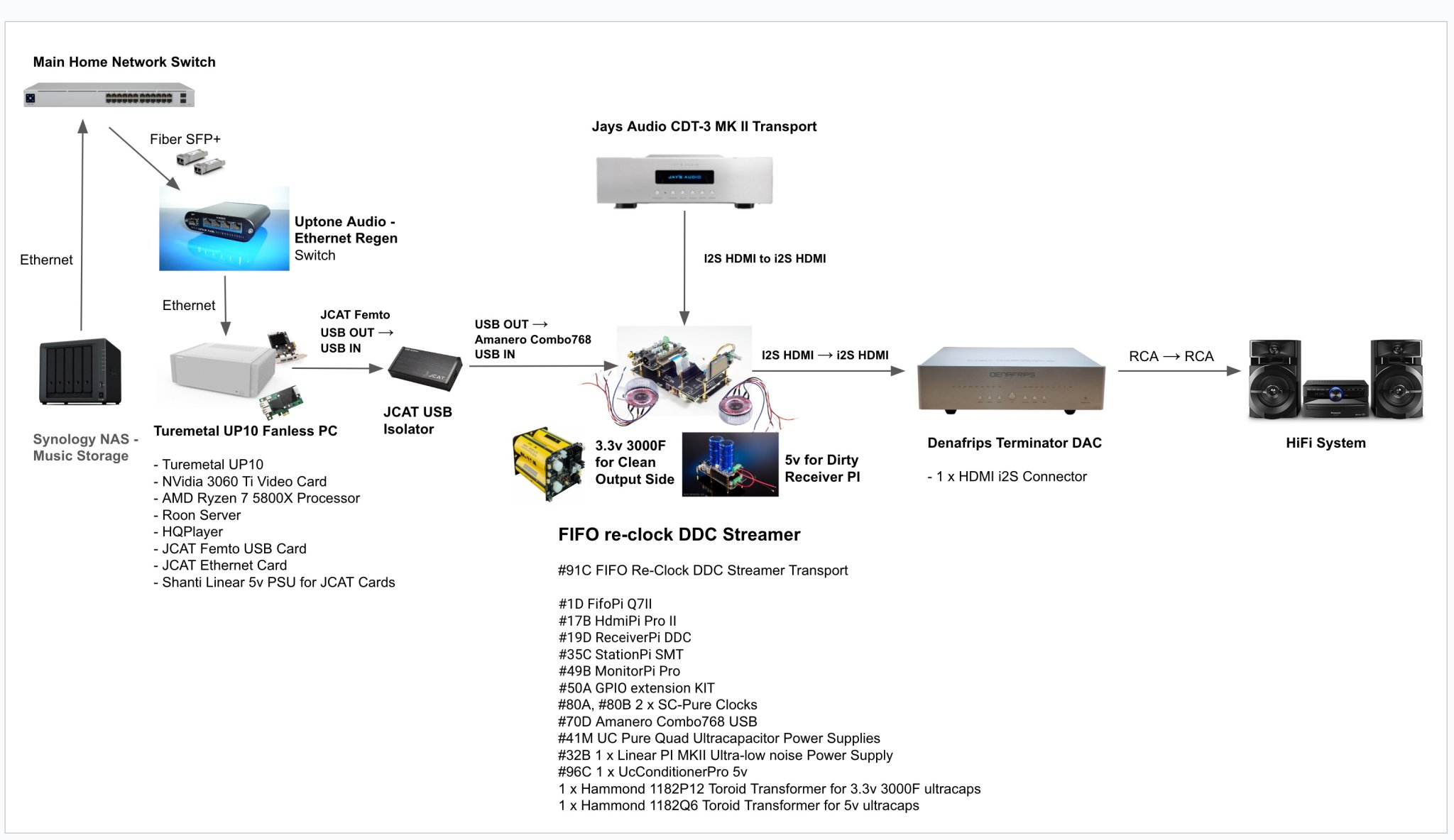

This is what I did about 4 years ago:
https://audiophilestyle.com/ca/revi...rdware-with-jplay-femto-software-review-r885/
I understand the current systems design, but is it Goldilocks "just right"?
What about using a Jcat ethernet card and bridging the network too?
Now USB could be just fine in this case!

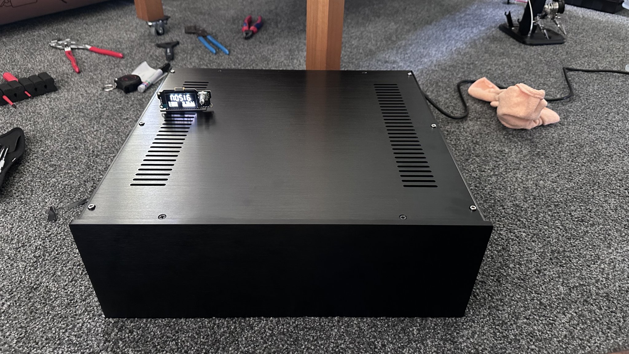

Which case are you using?the Hammond case for the Ultracapacitors
Also what is this tiny board?

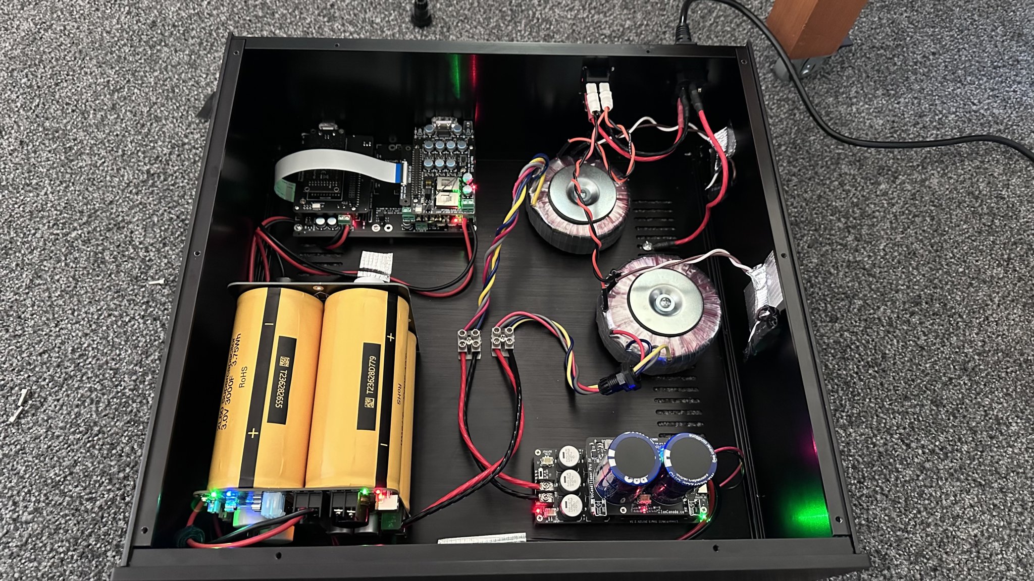

Quick questions for those that use Ian Canada gear today.
1. Can anyone advise which DC power wires go to which green power terminal as shown below and if any need to be piggy banked.
2. Assuming I should use a metal case for grounding the AC mains voltage housing for the Toroid transformers and not a plastic enclosure.
From reading the manuals. The station pi can share a single 5V supply by setting the jumpers properly. I see that you have the FifoPi wired up for the 3.3 volt input.
So you could set the 5v jumper properly for your use And run one 5v line to J3 on the station pi.
Just re-read the manual.
