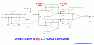

Hi Greg
Did you add the 12nF coupling cap between the two stages?
Regards
Chan
@bigpandahk,
I'm not sure what 12nF caps you mean. I see the optional 3.8n caps to ground before the summing stages, but I don't see the 12nF caps. What am I missing?
In any case I am using the IVStd balanced output into a balanced amplifier, so I am not even installing an opamp into the U3 position.
Sorry!
Greg in Mississippi
P.S. I think @Markw4 tried caps in that position and they may have been 12nF. BUT he had oscillation there. I don't know if that wouldn't have happened if he used the specified value (I know he didn't use that, but don't remember for sure what he used... sorry, no time to search tonight). BUT as I say above, I don't even use that stage in my current implementation.
Sorry!
Greg in Mississippi
@bigpandah,
Thanks. I had forgotten that Ian had posted the IVStd schematic with the Rasmussen Filtering changes.
I'm attaching the schematic Joe Rasmussen had originally posted as the 3rd picture in the first post of this thread:
Practical Implementations of Alternative Post-DAC Filtering
Joe's comment about the 12nF caps:
"The 2 x 12nF caps can be finely tweaked to restore response to 'flatness' "
BTW, note the added .33F/5V supercaps, a technique adopted by Allo. Kewl that Ian provided positions for our DIY experiments along those lines!
Actually I have only used the pre-IV R-C filtering and not the 'equalization' caps. So no, I did not. At the tender young age of 63, I know I do not hear a db or so frequency droop at 20k.
Greg in Mississippi
P.S. IF one wants to argue the merits for or against the Joe Rasmussen pre-IV filtering regime, please refrain from posting here and feel free to start a new thread so it can devolve into name-calling and get closed as all of the other ones did. I WILL NOT ENGAGE in such discussion here. What I have said, that I'm really enjoying my Ian GB setup with a lower IVStd IV stage filter cutoff, using the Rasmussen pre-IV filtering, sporting NDK SDA clocks, and powered by Ian's LiFePO4 supply, is as far as I'll go.
Greg in Mississippi

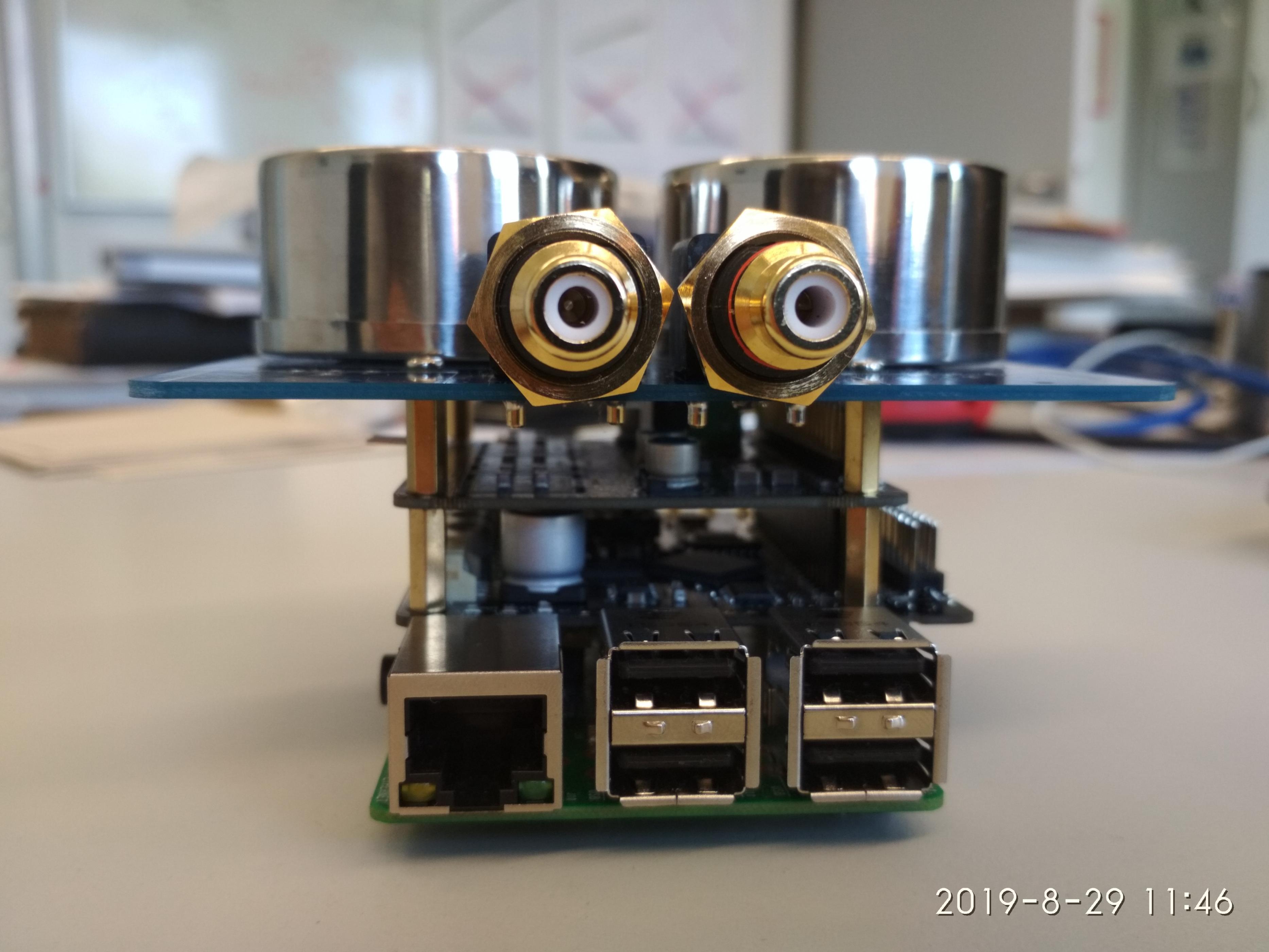

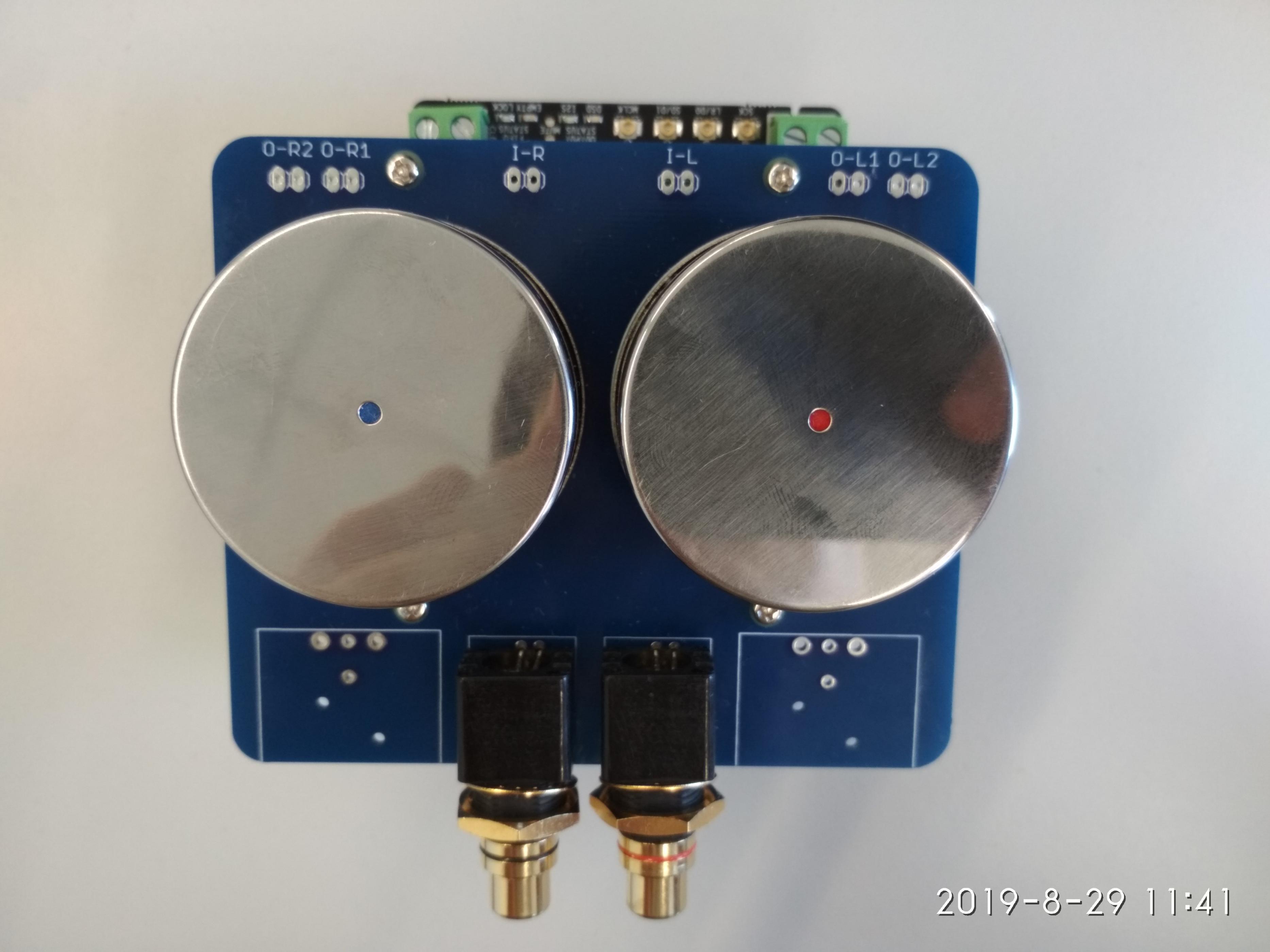

Just finished an early prototype of custom wound high permeable cores output transformers for Ian's DAC. Currently only SE output is supported. Balanced output will be added in the future.
Bit thanks go to Ian for making such flexible and powerful sound platform!
View attachment 778204 View attachment 778205
@xaled,
Looks very nice. Good PCB design. What are the I/V transformers?
Ian
@xaled,
Ian
Thanks! Board design was heavily inspired by your boards
I/V transformers are custom made by my technical partner here in Germany. I will send you the board for evaluation once we finished the initial testing and are confident with the design.
Greetings,
Denis
