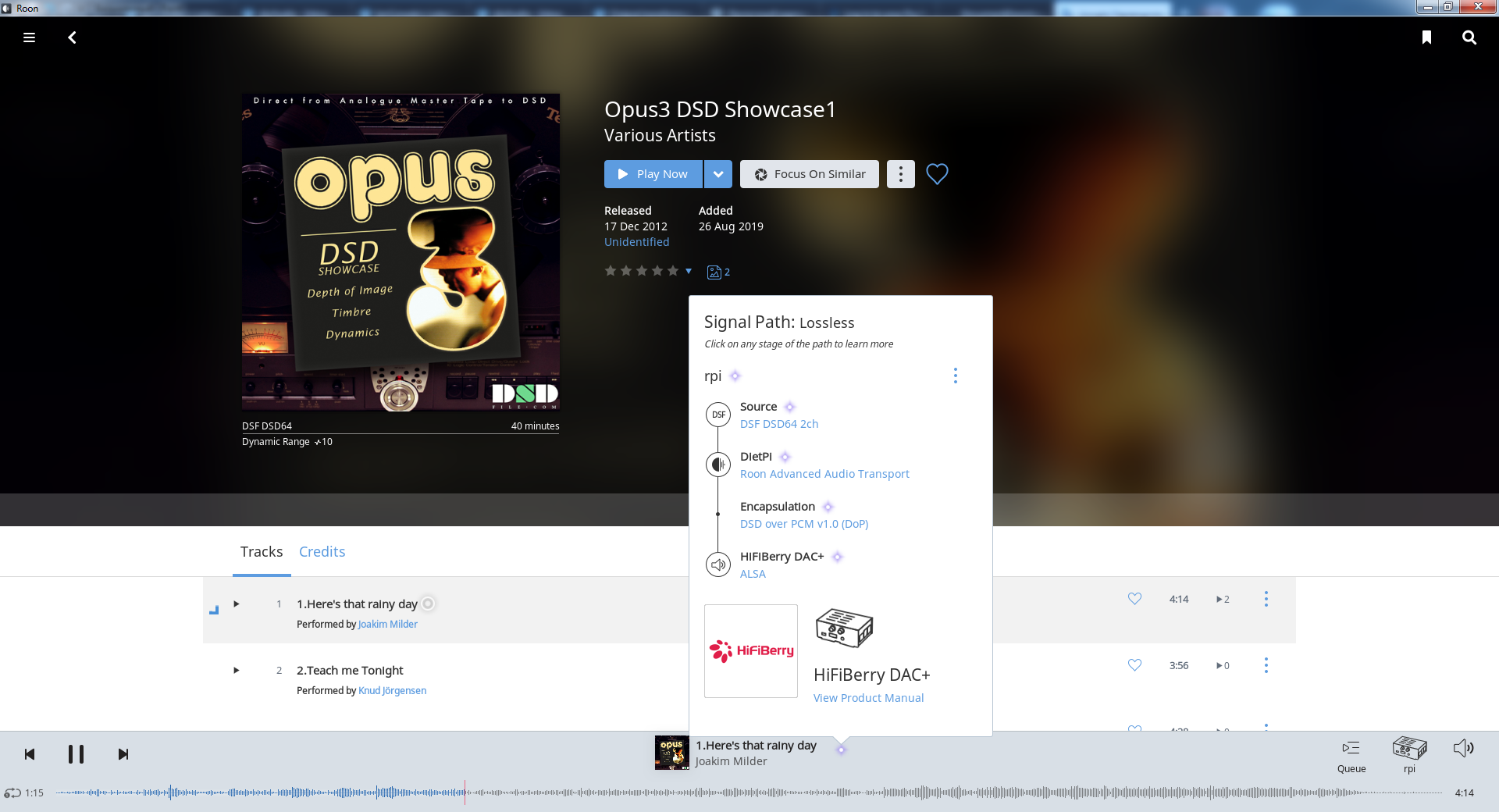

Guys I got the FifoPi but still not have success with DSD output from Roon. There is I2S input always on FifoPi Status leds, but Roon says that he doing his job as needed. The output led is always on I2S too. Jumper S1 on FifoPi board does not helps - always I2S input while playing DSD files. Can anybody confirm that it is possible somehow to force play DSD on Roon+Ian's FifoPi&ES9038Q2MPi?
Here what Roon says during playing DSD:
Is your DAC is really Hifiberry DAC+? If yes, then it can not play DSD. DoP (DSD over PCM) is still DSD (only in PCM stream), which PCM5122 in Hifiberry DAC+ can not accept.Guys I got the FifoPi but still not have success with DSD output from Roon. There is I2S input always on FifoPi Status leds, but Roon says that he doing his job as needed. The output led is always on I2S too. Jumper S1 on FifoPi board does not helps - always I2S input while playing DSD files. Can anybody confirm that it is possible somehow to force play DSD on Roon+Ian's FifoPi&ES9038Q2MPi?
Yes, I can confirm it works. The thing is that because you have to use DoP (which is DSD wrapped in a PCM stream) the input to the FifoPi will always be PCM (thus the I2S led). The output let of the FifoPi should show DSD if the DoP decoder is on (S1 in off position) and I2S if the DoP decoder is off (S1 in on position).

I have Ian's ESS controller and there is always I2S stream (no matter S1 ON\OFF). What DAC should I choose in Roon can you advise? Thank you!If you have the ESS controller you should be able to check the stream as well.

What hardware\OS do you use for Roon Core and for RAAT on Rpi (DietPi or Ropieee)?

Just flashed a RoPieee image into a RPi3. My Roon core is running on a QNAP.
I use my phone as remote controller. With my ESS controller in analyzer mode, things look good. Both PCM and DSD (DoP) format and sample rate are monitored at real time exactly as same as what displayed on the Roon controller.

Ian, can you say what settings exactly have you choosed in the Roon for playing DSD stream? Thank you!
Thank you! Ofcourse my DAC is not HiFiberry DAC+, but which one should I choose from list of Roon's branded devices (there is no Ian's FifoPi in the list yet )?
Which HAT DAC do you use?

Select HiFiBerry DAC+, DAC+ Pro during the configuration in Ropieee.Phisically - Ian's dual ES9038m2qpi. But I am trying to find any usefull for DSD in Ropieee (to allow Roon to send DoP correctly if I understanding correctly). Which one should I choose in Ropieee (?), can't understand...
If to select Hifiberry DAC (or DAC+\PRO) then DSD playback not works like any other within ropieee' list and there is no option in Roon->Device Setup->Advanced->Max Sample Rate (DSD) at all. I have selected Audiophonics I-Sabre ES90*8Q2M DAC, but still no sucess -I2S output from FifoPi always (I2S on ESS Controller always)
