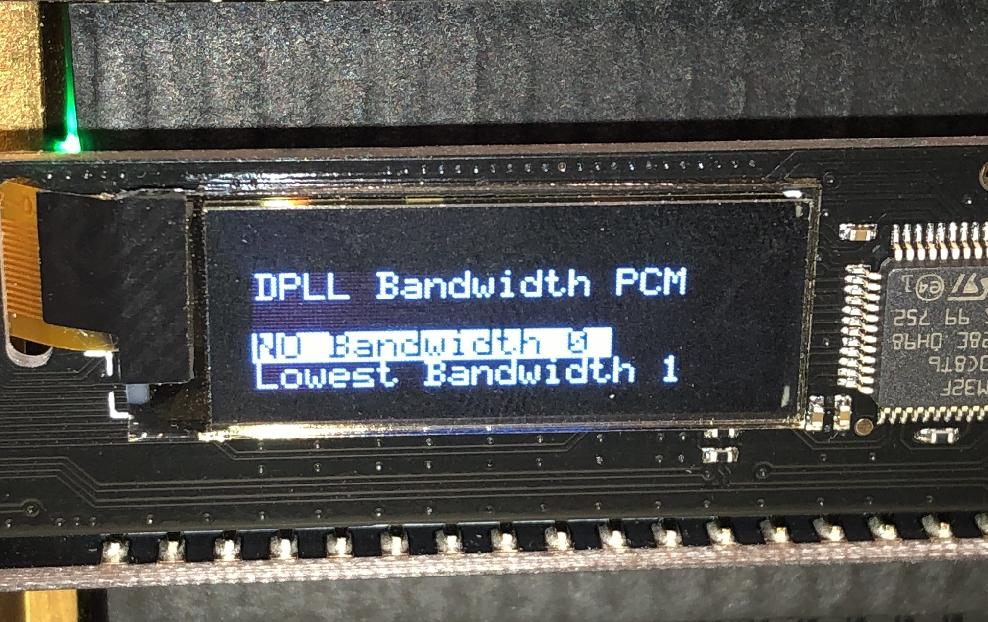

I had been listening to DSD format musice on my ES9038Q2M Dual Mono DAC the whole week last week. When I switched back to PCM music with setting the ESS DAC into true sync mode by stopping DPLL and configuring the BANDWIDTH=0, I really felt the improvement. By comparing with sync mode under the same XO clocks, true sync mode comes with more air and liquid,solid stable 3D image and quieter background. The better XO clocks I use, the more obvious I feel. The only issue is that ES9038Q2M doesn't support DSD and DoP at true sync mode.

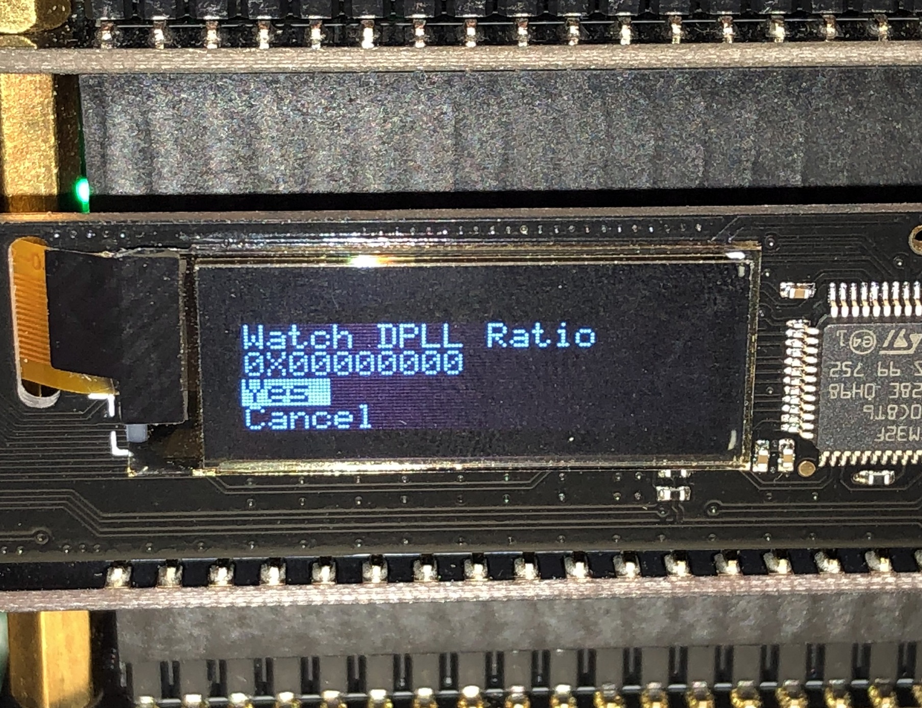

I don't know if anybody uses the DPLL ratio status watching function on the ESS controller. It's a really powerful feature to evaluate the clock quality and DPLL status. I found something interesting. At sync mode, ES9028Q2M and ES9038Q2M work in different way. ES9028Q2M DPLL was in "free wheeling" status which means that the DAC is using the external mclk rather than the DPLL. While under the same condition, ES9038Q2M DPLL still trying to lock to the input music stream though the music signals are already synchronized with the mclk. If the XOs are good enough, the changing of DPLL ratio is just 1 or 2 above or below the center numbers.
When setting to true sync mode, the DPLL will always stop at 0 without any change (truly stopped).

What watch DPLL status number was showing on the OLED when you play DSD at true sync mode? Did you set DPLL DSD bandwidth to 0? Did you use external mclk from FifoPi? Did you set jumper switches to sync mode on ES9038Q2M DM board(I suggest switching both on)? Please let me know.

0x00000000What watch DPLL status number was showing on the OLED when you play DSD at true sync mode?
Yes, for both PCM and DSD options in ESS-controller setup.Did you set DPLL DSD bandwidth to 0?
