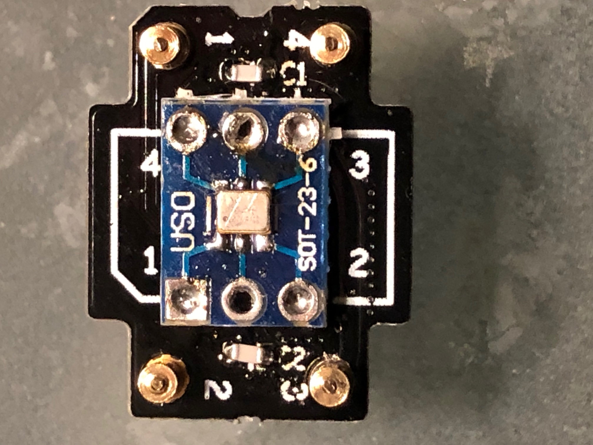

I don't think I've seen anyone do this before, it turns out the NDK clocks fit perfectly in a sot23-6 adapter, which in turn solders right into Ian's crystek clock adapter.
I soldered clock right only the pads on the adapter. Then I put solder on the Ian's adapter pads, some solder in the sot23 adapter holes, heated and done.
Adapters were bought from ebay a while ago, I'm sure they are readily available.
