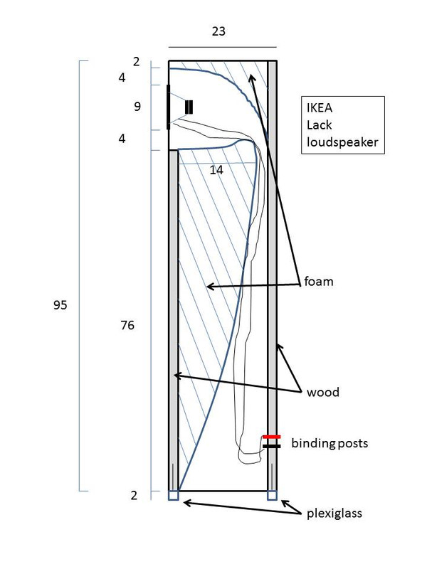

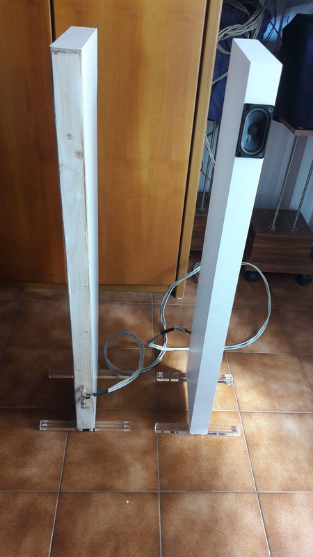

I have also over the years have searched for unlikely ready made enclosures and then reverse engineer to choose the the driver. I like your solution here. I would be concerned that the Lack shelf material is vey light ( not dense) and would vibrate and resonate uncontrollably. How do you deal with this?
It could happen, as the wide walls of the shelf are only 3 mm thick ( the others are 7 - 8 mm ).
But they are glued to the polystyrene and wood inserts, that dampen all vibrations.
Anyway, if You want to be sure, You could put some dampening sheets or paint inside the shelf, or little wood blocks between the wide walls.

Or maybe the side panel resonance could enhance LF response, like the Reso cabinet for the famous Saba Greencone loudspeakers ;)

Being so narrow they will almost certainly have balance issues
in the upper midrange that must be addressed by a filter, can
be line level or speaker level. 15Hz ? Not a hope in hell.
Measurements rather than claims are always very sobering.
