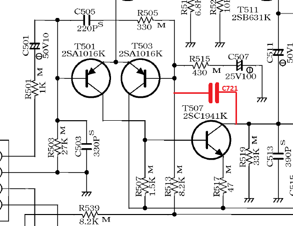

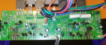

Ok, finally started work on first stereo board of 976 MK2. First step mostly audiofool changes. From technical changes replaced nfb capacitor with 220uf (from 100) and input ground resistor changed for same value as nfb resistor. I also need to replace current sources ground resistors for higher power rating because PCB under them is bit brown.
Next step will be ltp translator matching.
On PCB there is unoccupied space for C721, C722 capacitors. Though they can be used for miller cap but this does not look like "classic" compensation. They are from VAS collector to NFB end point.

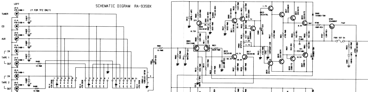

Hello gents 🙂
I have discussed mod of power amp of rotel ra-01 and I would like to get second opinion here. I didn't find this mod here (or I do not realise it) and I wonder what do you say.
So the mod is to cut power supply for power amp and add RC filter and "come" closer with capacitors to some transistors in power amp. Suggestion is to add at least 470 uF capacitor, or 1000 uF better with 10 Ohm resistor.
Enclosed scheme for one channel.
Thanks and hugs 🙂

Hi Piotrek,
Yes, that works. I did that at the very early stages of upgrading (see post #24/25) and it does reduce the input stage supply ripple.
You will lose a bit of headroom, but nothing serious.
However, I later found that if you actually manage to precisely match the input transistors the PSRR of the amp shoots up and practically makes this filter addition (which also requires cutting of pcb tracks, air-wiring, drilling holes and finding suitable spaces for the componets) - unnecessary.
And, being the lazy b*gger that I am, it suits me just fine. 😉
Correctly matching of LTP transistors has been covered elsewhere on diyAudio. I found that it is most important to make sure that the trannies stay at exactly the same temperature during hFE and Vbe measurement. So I use a vice to clamp them while still sitting on the tape, measure every transistor twice and pencil down the result on the tape. Then it is easy to find matching pairs later.

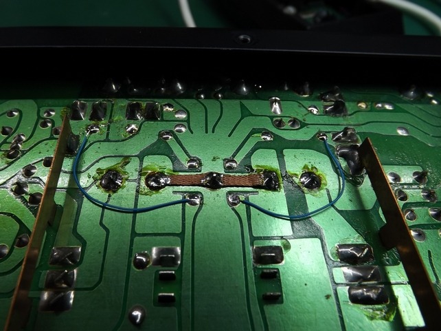

Hi Sam,
i think that is a little harsh verdict on the old Rotels. Yes, there are definitely improvements to be made, but generally I think that these Rotels easily hold their own against the other amps of their era, class and price range. Not least due to the layout and use of high current busbars in the power supply.
And if a THD spec. of 0.03% can be regarded as "high distortion", try doing a RTA on your £1000+ tube amp.
I have by now had at least a hundred different Rotels past my workbench and the "noticeable voltage drop created by currents in the power circuits of the output stage" has definitely eluded both me and my 6½ digit Keithley.
Actually, the whole idea behind this thread was to show that THD (and with that all the other distortion gremlins, cf. Chris’ post #81) can be substantially improved ’by 20dB to an audiophile level’ with only a few relatively simple measures – without performing radical reconstructive surgery on the amp.
That said, you are right about the high currents inthe power supply. This is particularly true in the ground star connections and I always add a strip of copper braid between the ground potential terminals and the black return wire to the transformer, see pic 1. It could perhaps be argued that the trafo wires could be thicker, but there is not much we can do about that.

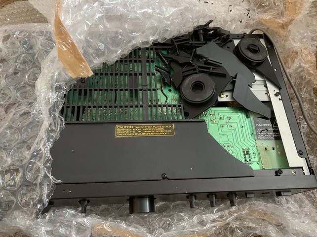

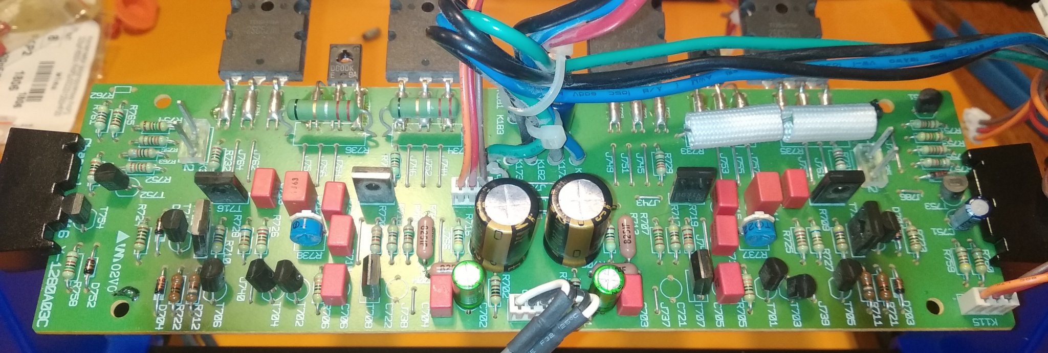

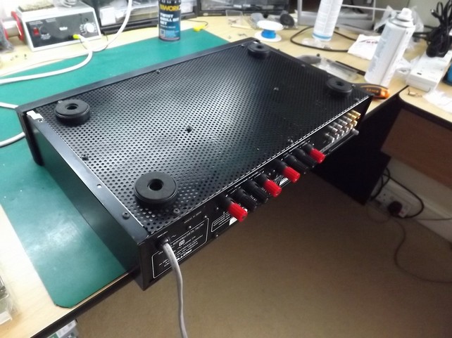

The RA-930/931 series of course also have a basic design flaw in the use of a plastic bottom panel and an insufficiently rigid transformer base screwed directly onto it for support. Many of these amps end their days after a courier transport – particularly if you label the box ”FRAGILE” – apparently, that is like waving a red blanket in front of a bull.
Typical result - Pic 2, ageing plastic gets brittle and these spare parts are rarer than ’hens’ teeth’.

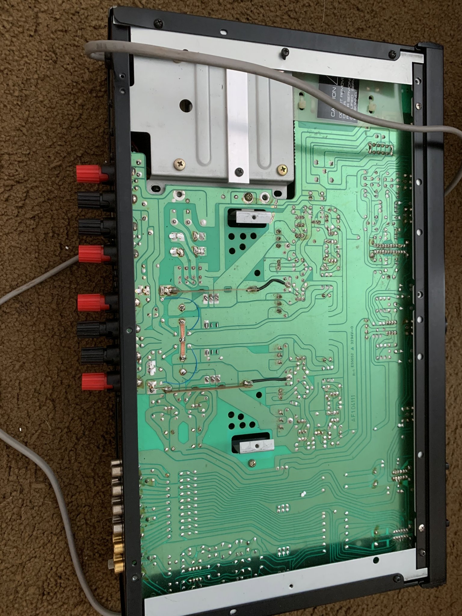

My solution – Pic 3, a stabilising bracket under the base and removing the two screws to the pcb and bottom panel. This effectively stops the trafo from vibrating and saves the plastic panel for another 30 years of service.
If the damage is already done, I have made replacement panels from perforated Al sheet with some snazzy black or gold feet to spice up the looks, Pic 4. Gives a better shielding than the thin alu tape on the plastic - and slight reduction in 50/100 Hz too.
There is always hours of fun to be had with these amps!
