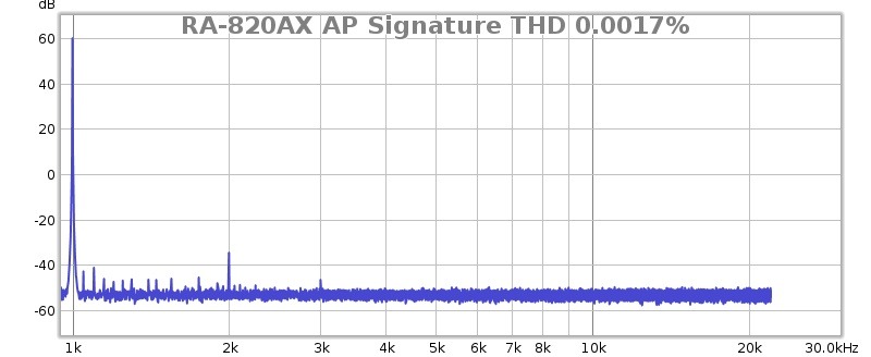

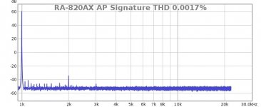

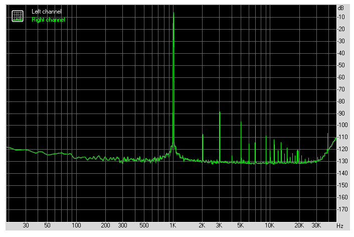

Hmm, I see the third and other odd harmonics only just over 80 dB down and adding the rest of the distortion peaks, I don't think that the THD is anywhere near down to the 86dB or 0.005% as claimed.
I enclose a RTA plot of one of my recent AP Signature amps (with absolutely no mods to the power supply lines or bias capacitor) measuring 0.0017% THD.
It is absolutely possible to get these improvements with only a few direct drop-in upgrades.

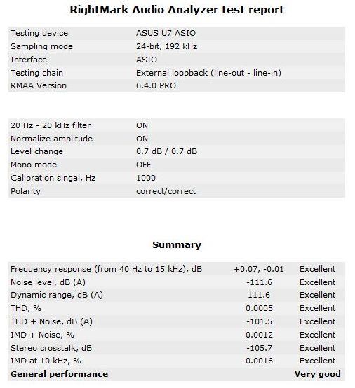

According to the attached graph (-3dB), the third harmonic does not exceed -86dB, which terms of 0.005%. I don't remember the exact details. This is better than the manufacturer's stated 0.03%, -70dB.

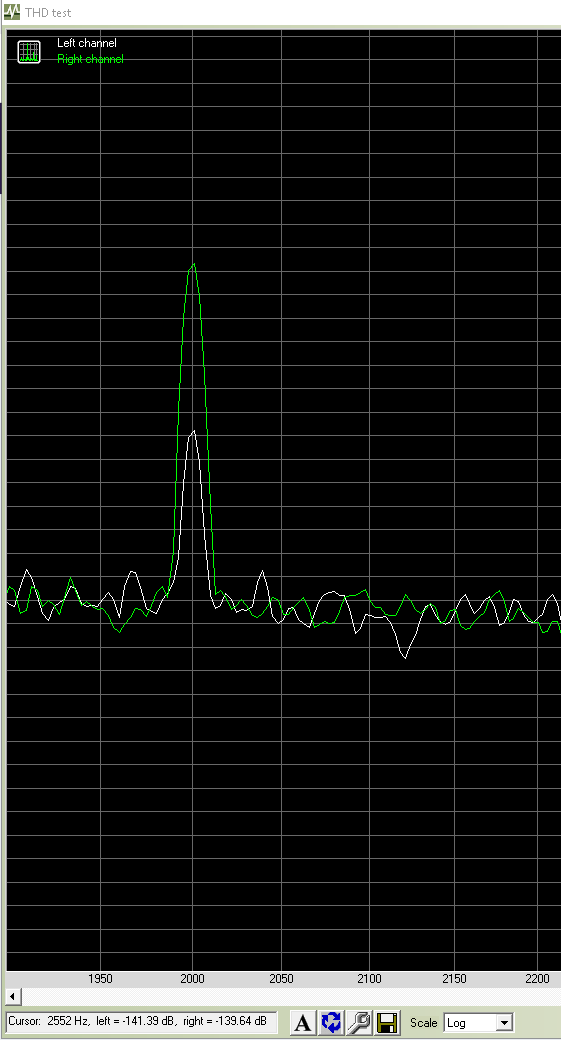

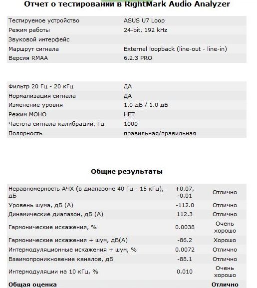

What was used to measure 0.0017% - 95 dB THD? ASUS Xonar U7 (line-out - line-in).I enclose a RTA plot of one of my recent AP Signature amps (with absolutely no mods to the power supply lines or bias capacitor) measuring 0.0017% THD.
I must admit that I have never seen that Russian(?) report on an ASUS U7 before - and maybe that is not surprising, as it is dated 00:45 - this morning!
Even so, the results seem very strange. I have never seen distortion peaks of 26dB above the noise floor in a U7 loop-back test.
It has been a few years since I did them and the files now sit somewhere on an old hard drive, but there are at least some indications in post #64.
It is also strange that the U7 should have internal 50Hz peaks - when it is powered by +5V USB?
This indicates to me that there must be a serious flaw either in the U7 device measured, the RTA instrument - or the loop setup.
I use a the U7 Mk2 (I think), but I have never heard of the RightMark Audio analyzer. I think that this may well be the 'fly in the ointment' - which could also explain the distortion peaks on the RTA trace you shared in #741 above.
A 'quick and dirty' estimate of the THD in that trace provided it to probably be somewhere just under 0.010% - that is if the analyzer is to be trusted.
http://personalaudio.ru/detail/asus_xonar_u7/
ASUS Xonar U7 MKII
https://ru.gecid.com/mmedia/asus_xonar_u7_mkii/?s=all
RMAA is very worthy, apparently different card instances.
https://www.diyaudio.com/community/...c-and-measurements.330472/page-4#post-5737957
#741 was not measured by Asus. TASCAM US-2x2 or US-4x4 I don't remember exactly.

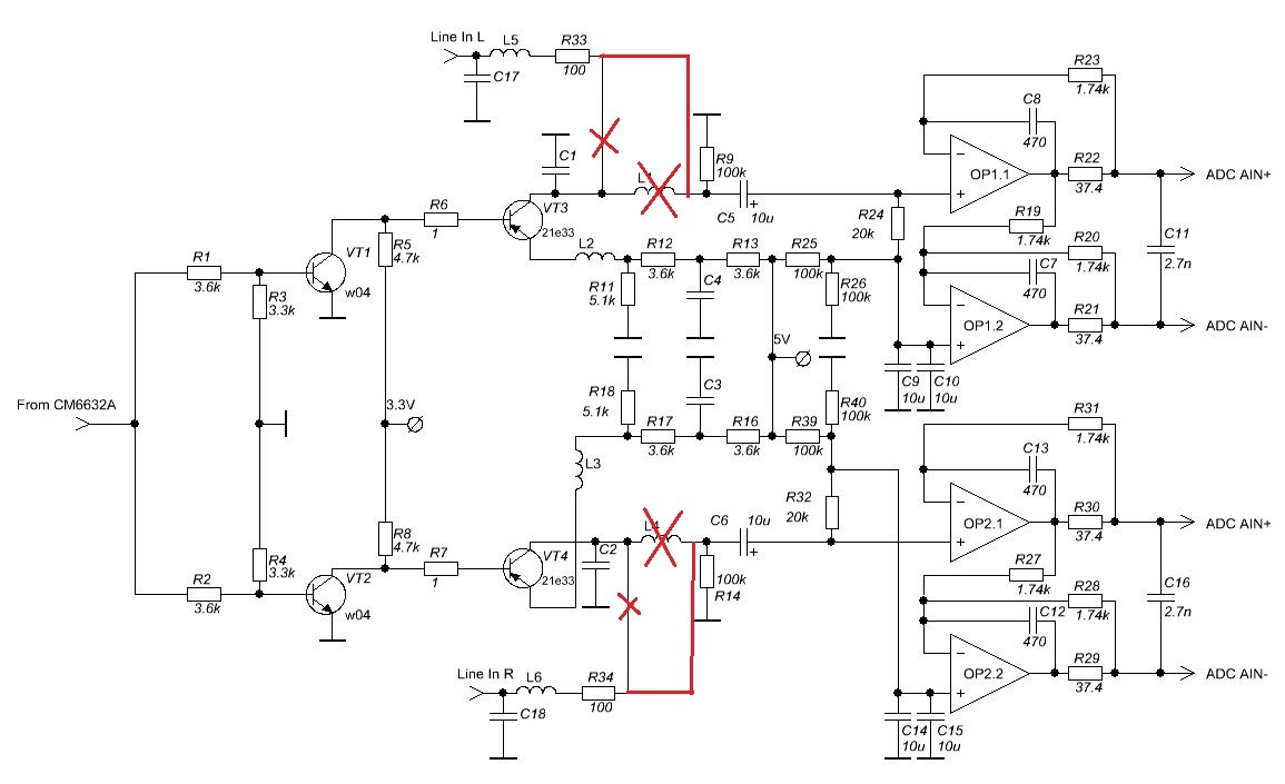

https://forum.ixbt.com/topic.cgi?id=12:54737:996#996
The main problems of the ADC and the power supply of the 5V op-amp, gidagap also turned off the transistor switches.
I found the Xonar U7 MKII, measured it, but the miracle did not happen.
Hi Per,
I couldn't find a complete diagram on the internet.
I think that at 5 volts it is difficult to achieve significant improvements,
even with op amps with rail input and output. After all, the 2 volts rms required for improvements is almost 6 volts peak-to-peak.
Perhaps I'll try to install the OPA2156 rail-to-rail operational amplifiers (op amps) type.

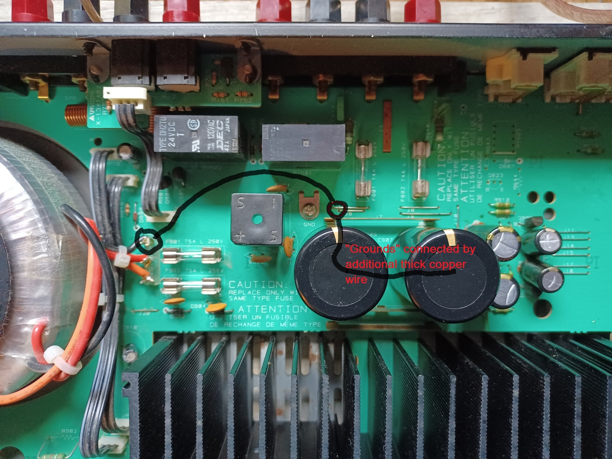

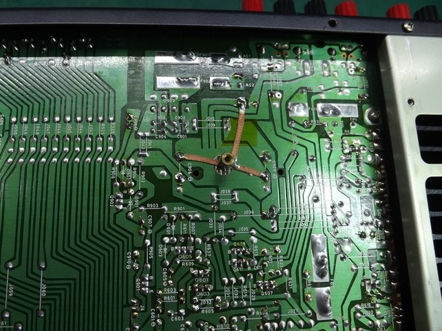

That said, you are right about the high currents inthe power supply. This is particularly true in the ground star connections and I always add a strip of copper braid between the ground potential terminals and the black return wire to the transformer, see pic 1. It could perhaps be argued that the trafo wires could be thicker, but there is not much we can do about that.

Hello, I would like to understand it precisly, as I work with RA-01, RA-02 and RA980BX so far. They do not have "one grounding point: as RA930/931. By this you are connecting "ground" of the main filtering caps (in RA01, 2x6800 uF) with thicker copper wire, right? And this connected "ground" you are connecting by thick copper wire" with Ground of the trafo, right? I showed it in the picture with black line.
HI Piotrek,
Yes, I use a piece copper of solder wick in the 930/930 (and two in the RA-820AX). The RA-980BX has got a massive central ground plane, so it may not need further help - and the RA-01/02 appears to use the advantage of a more modern, more clever pcb layout software and in my experience they do not seem to show these grounding issues as much. But they all do have a central ground point, either a pcb Faston or tab which is screw connected to the bottom panel.
In the RA-01/02 you could try to fatten the pcb track between this tab and the black wire to the transformer and see if there is any 50/100Hz reduction.
I don't recall that I have ever done that.

Привет Пер,полная схема U7?

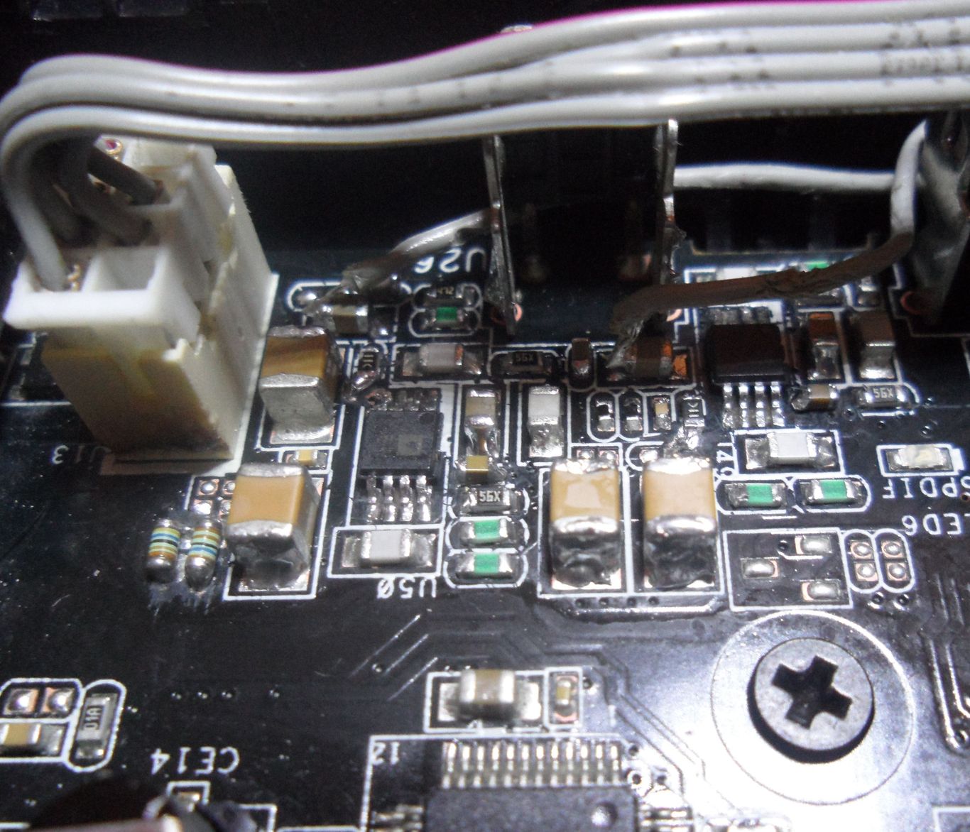

BoardViewer.exeI seem to have problems in opening the zipped ASUS document. But I will try another zip program.

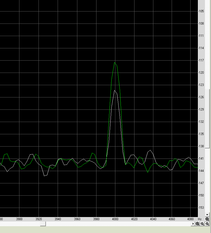

Removing the transistor switch in the left channel reduced the second harmonic. I continue the experiment.
