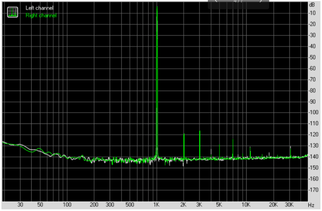

Improve a Rotel amp THD by 20dB!

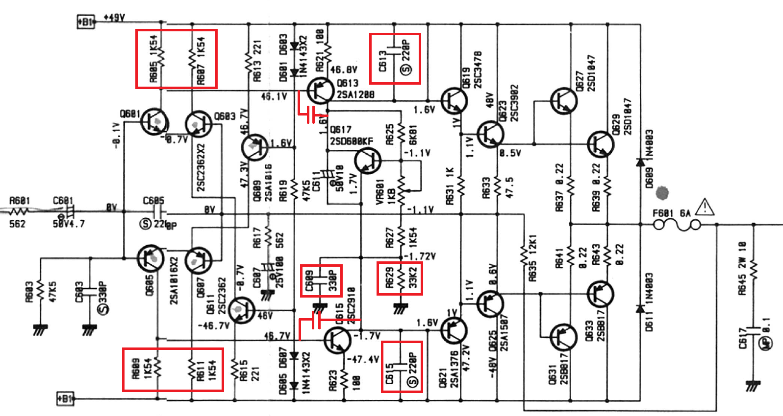

1) There is advice for other Rotel amplifiers to decrease C609 from 330pF to much lower 27pF and leave R629 33k completely out. Can it be done without further risk or modifications?
2) There was also discussion to completely get rid of C613/C615 to decrease capacitive load of the VAS stage, but others said that this may lead to local oscillations of the output stage. At the moment I tend to better leave them in. (BTW: right next to the caps there is a shortcut in the schematics, hope that this is just a mistake - or to fool copycats without knowledge...)
3) Adding 68pf miller capacitors to VAS Q613/Q615 transistors; can I just do that and it "improves" (from "Rotel" to more "HiFi" sound), or are further analysis/modifications needed?

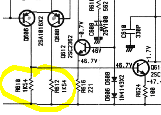

4) 1,5k R605/R607/R609/R611 in the differential output stage: seems sexy and easy to change them for a current mirror pair of transistors (and maybe additional 100 Ohm emitter resistors) which may help to power the VAS stage (and miller caps) better. But I have no idea what parts to choose and if they have to be exactly matched. Do you have a recommendation what to buy (no SMD, wire through preferred) or is this not so easy?

My ideas/questions:
!) Yes, that will take away the "pleasing, soft" Rotel sound, but do not remove them without putting in the Miller capacitors! And test without speakers first.
Since you don't have an oscilloscope you will have to rely on AC measurements and checking the component temperatures to detect possible oscillations.
Keep a finger on the off button - and put in lower amp fuses during testing.
2) Leave those caps in for the same reason as above. The short is clearly a drawing mistake.
3) There is a lot of circuit theory and experience going into Miller capacitors. But they do work by kicking in at higher frequencies and reducing gain as to keep the amp stable. Choose them too low and get oscillations - too high in value and your slew rate will suffer. I have seen values ranging from 2pF to 220pF in various amplifiers, I usually keep to the value that Doug Self recommends - 100pF. In your case that means 47pF around the C-B of each of the two VAS transistors if you want to keep the schematic looking nice and balanced. (100pF at just one of the VASs would do as well).
4) No, this is not easy. I will start the posts (I promise!) on my experiences on doing just that on the RA-971 which will cover the challenges.

Okay, so I will leave the 220pf VAS capacitors in and the current mirror idea out due to limited experience and measurement equipment...
At first I will listen to the amp, and when i find that it is bit too soft for me I'll try 1) & 2) !

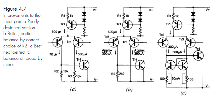

Hi everyone,
sorry for my rookie questions, but now I've started to read a bit through Douglas Self - Audio Power Amplifier Design Handbook.
I found this:
Rotel is using option a):
At my - very limited - view it seems like there is some potential to optimise balancing of the differential amplifier just by leaving out R3 respectively R612 and Re-dimensioning of R2 / R618 ?
But the Rotel input circuit has much lower impedance (1,5k vs. 10k) so the imbalance may be much smaller as the current over the restistors vs. to the base of VAS transistor is higher than in Self's circuit...
Reactions: 1 user
Joined 2012
Hi Peter,
The goal is to send the same DC current through each of the input transistors to balance them, thus lowering distortion and output offset.
a) has a much too big R2 collector resistor, as the voltage over it is the VAS's Vbe - or 0.7V, hence the 70uA current.
This resistor should be designed so it passes about half of the current source value, here 600uA. Thus 0.7V / 0.0003mA = 2k33 or the nearest std. value 2k2 as in b).
R3 has no function and could/should be omitted - but it looks so nice and "balanced" on the schematic.
c) A current mirror greatly improves the LTP balance and reduces distortion gremlins as Self demonstrates.
BUT, you can't use CM's directly in your Double Differential amp topology because there will be no control over the VAS current - and a transistor blue smoke mayhem will soon follow:cry:.

I tried to reactivate my rusty electronics knowledge a bit, but the voltage levels documented on the schematics seem to make it easy (even if some values may be a bit erratic...).
Assumption of the diffamp currents:
From my rough calculation its seems that 1,8k instead of 1,5k may give a bit better balance, but the 46,1V I took from the schematic may include that some of the current through R605 goes to the base of VAS stage transistor. So in general, Rotel has made a correct job here with dimensioning the diffamp current balance, not much optimization potential here with the values (of course the current mirror will bring improvements!).
As you mentioned, R607 and R611 have no function so they are redundant. But will it bring any improvement to replace them by 0 Ohm wire bridge?
