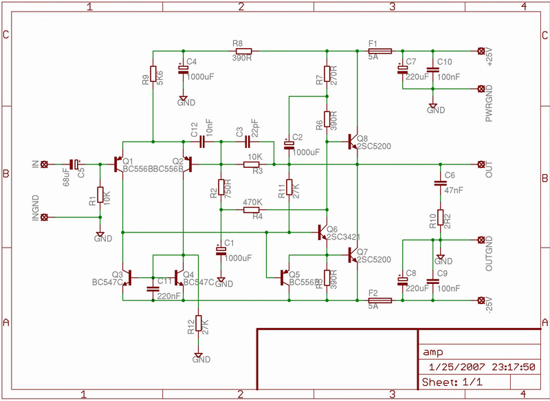

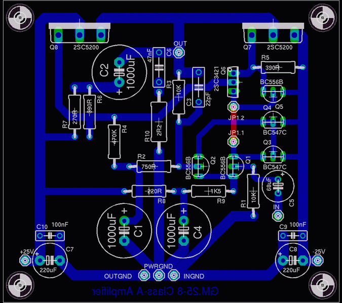

Hello Sparkle, Graham sent me a new schematic
A fresh brand new design, simple and easy class A amplifier.
With reduced number of parts.
I will listen at it too.
regards,
Carlos

This amplifier was shown by Graham to be used as Class A...and the voltage to be used had to be 25V simetrical.
Fast i decided that i will make it Class AB, and the supply will be plus and minus 36 Volts.... i made modifications in resistor values to compensate that voltage increase and now i will switch the amplifier on (will it work?)
This time, i cannot change bias pot just simply adjusting it....Graham had supressed the Potenciometer...ahahahahah!
But i will do it...despite of that...will work class AB

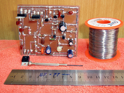

So many provocations and Graham do not return to us...my God, the guy really turn old

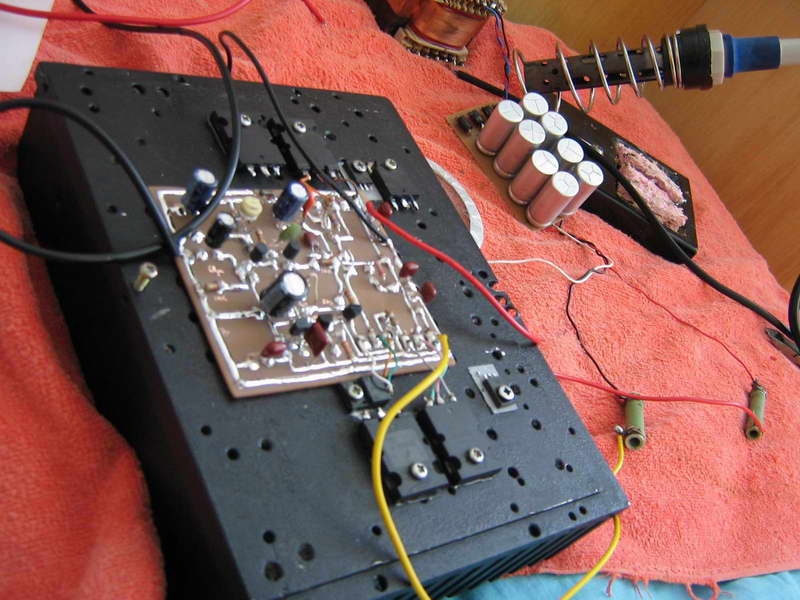

You can see here that the amplifier is assembled...i have installed fake transistors only to show you their position.
They are still removed.
I will be listening this afternon...and morning is going...in 3 hours i will be here telling what i perceive...or if is do not works because my errors.
regards,
Carlos

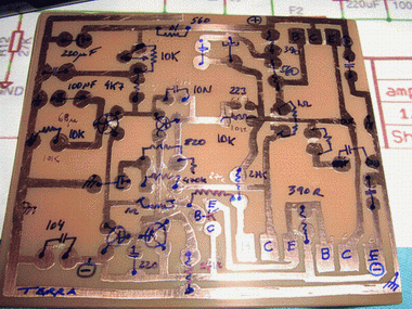

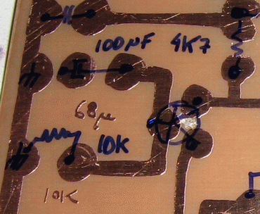

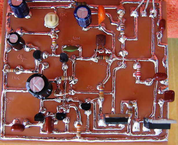

Hummm...too much complicated to my taste
Very crazy voltages, starting in the differential.
Circuit checked 4 times....resistors measured once again, transistors removed and checked twice, board examined serching for open circuits or shorts and nothing.
Unballance of stand by current...enormous off set.... voltage amplifier not biase...crazy.
Related this one i will give up..as i have many other one to make...this one was made in simulator...and sometimes those sons of simulator do not works.
Also sometimes the constructor do not work fine.
regards,
Carlos
Off course, despite the double check, i am human and some error could remain
But in the reality, i will have to modify the circuit to match my needs...to make another one...a new one!
Well, this will take hours...and during that time i can construct one amplifier and test two that i have waiting for testings,
Also i have a TDA2052 to construct and listen.
And also some circuits result of talks with my friends...things to test in real life.
GEM is beautifull...but this one...well....this one...well..let's say that i was not lucky.

If someone wants to fix it...or to construct it, or even checking it.
I will be happy..i will keep my board for future references.
It may work another day.... i will repeat, it is not uncommon my mistakes during construction...this can be the sittuation now...try it by yourself.... i am not a computer....a man only!

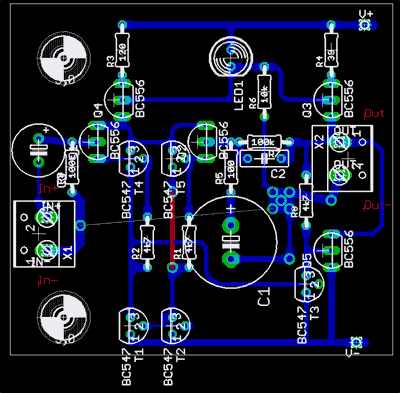

I made a layout before for it, but never built it... after reading this thread, I learned that his schematics seems to be drawn exactly as built (physicaly - layout wise)...
So, I thought I'd try it with the Graham Maynard preamp, and I think my latest PCB layout is closer to what he would have in mind..
Does it look ok? I'm still green when it comes to anything woring with transistors... I know about decoupling chips etc... but transistors, is big gray area... makeing it hard to just build schematics, as I don't know what is assumed as logical and left out...
and my pcb is attached for your comments... I just tried to copy the layout style of other GM circuits... BC547 = BC550, BC556 = BC560, just used similar pined components to draw...
