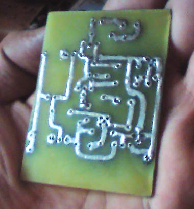

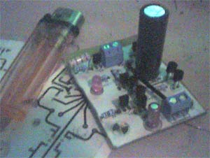

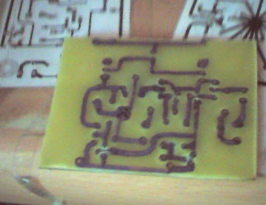

Ahahaha!...lovely work Nordic...thank you by the images.
Please..continue to keep us informed.
I finish the supply to the Dx amplifier...the 3601
Very clever to cover the board with the schematic to have references...easy and good.
