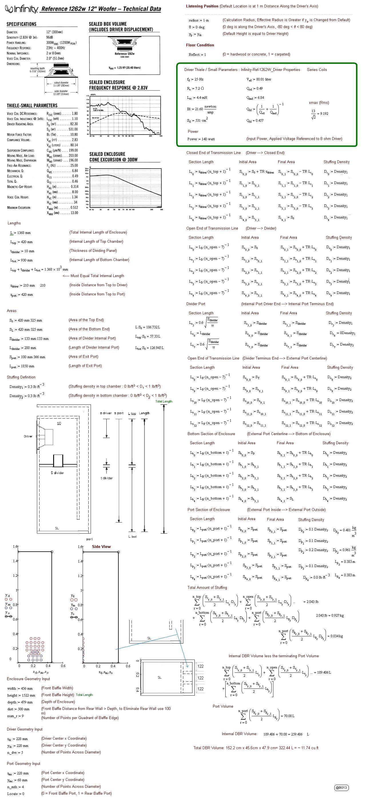

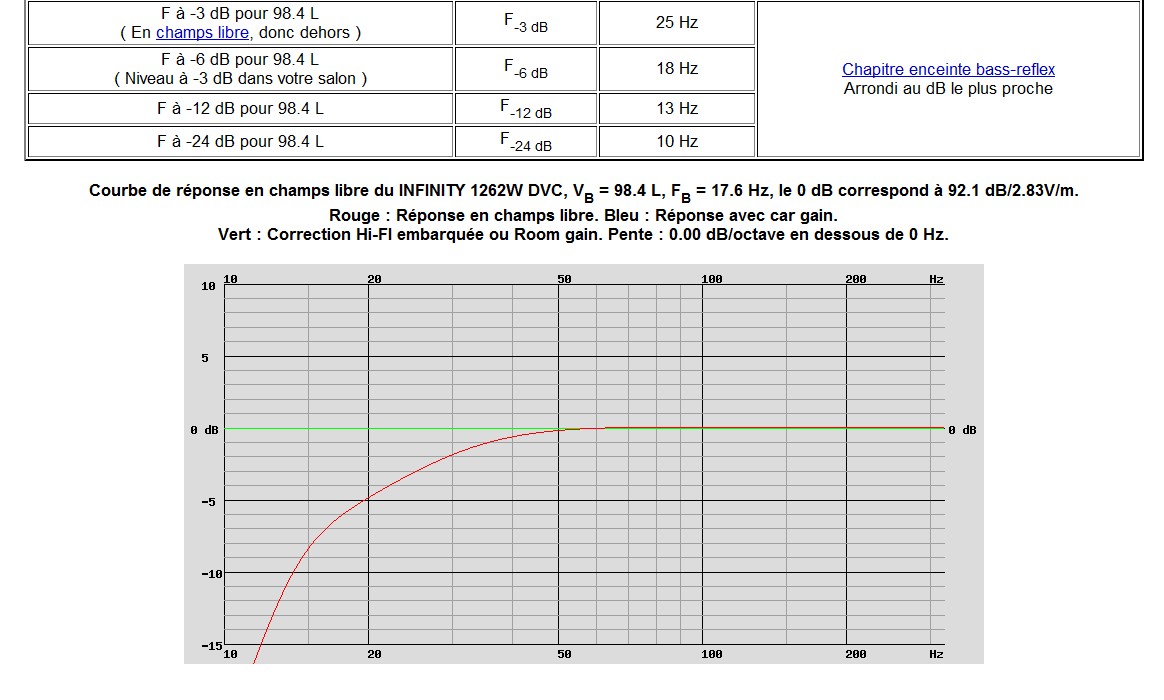

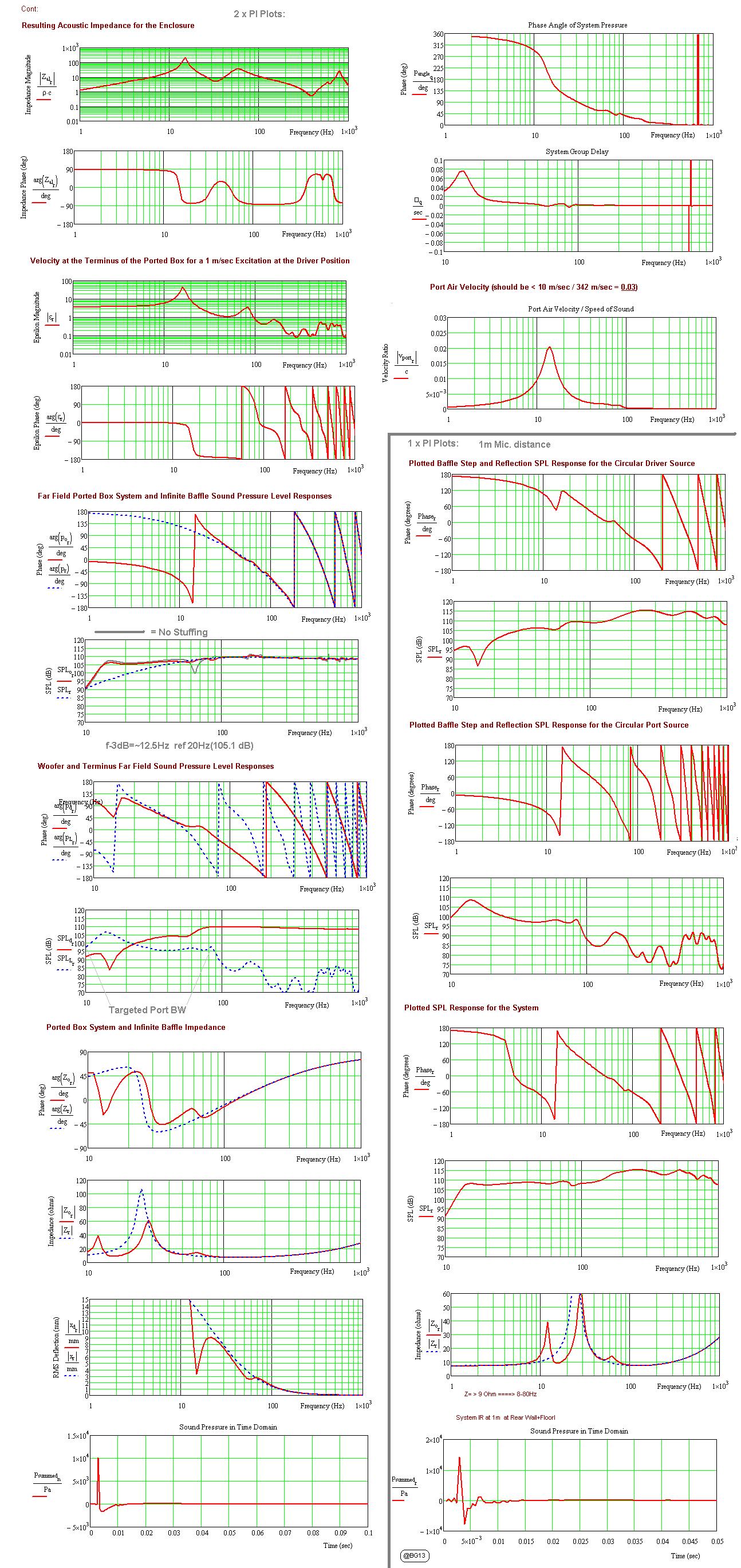

Good Alex,
You will get infrasound.
Now to the speaker you will need, I will model a BR alignment.
A special built enclosure is possible in a TL/QW/TH or BR form. A sealed unit would be good only in another application regarding your requirements for LF extension.
INFINITY Reference 1262W DVC
VB = 98.4 L, FB = 17.6 Hz
You will need a BR enclosure with net ~100L.
You will need to add extra space for the volume of the port, if you place it inside the cabinet. If you place the port outside the cabinet you don't need to add extra volume to the total (net) internal volume of the speaker.
Now this is going to be very important and decisive for a good final result.
Let's say that you have 100L (net) plus 15L (port) plus 2L (driver), you have 117L total inside volume needed.
The size/volume of the port it's in relation to the materials used, if you use a pvc pipe vs. ply/wood (for a round or square port).
Also the power W used is going to be important for the max. SPL and port noise.
Let's say you are using max. power admissible. So, for a 12.5 cm port (internal diameter) you will need a 111 cm length (yes, 1 meter and 11 cm) for the tuning frequency to be calibrated. You can adjust and test this later, with your final design.
A port built with ply/wood will have a much higher volume that the one I used previously for a pvc pipe. Let's say 30 cm x 5 cm (internal) square port made of 1" ply (it's 35 cm x 10 cm external) will have a volume close to 38L, this only for the port (vs. the 15L of a pipe with ~3mm thickness), putting your final internal (net) enclosure volume in ~140L (100+38+2).
Measure carefully the thickness of the materials used (PVC, ply or MDF) and final volumes and dimensions of parts, internal and external, for an appropriate and calibrated result that matches the one expected by the simulations. Have fun and a lot of infrasound music. 🙂

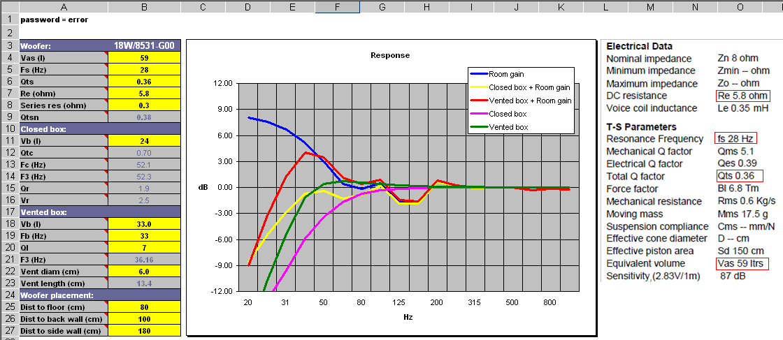

Put simply, room gain is not assured at all at any specific frequency, as can be seen in actual testing:
Data-Bass[pp_gal]/1/
What SPL does the INFINITY Reference 1262w 12" achieve at 10 Hz and 16 Hz without exceeding Xmax with your BR alignment radiating in half space?

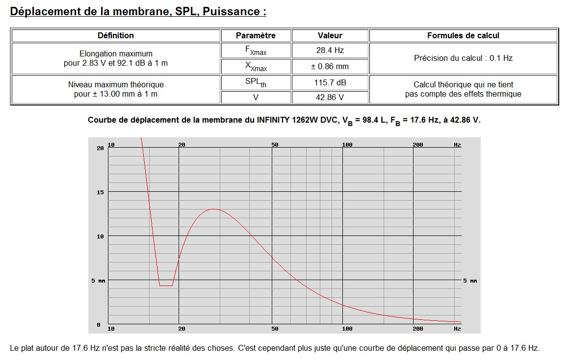

Alex,Dear all ,
I have a small doubt regarding the enclosure tuning , as inductor calculated the required enclosure volume , he mentioned that the box tuning (Fb) is 17.6 Hz ,my doubt is that - is this a fixed number for a particular driver because I have read that when we go below the port tuning frequency there will be unloading of the cone , will this cause a loss in efficiency ? and is it possible to tune the BR to 15 Hz as space is not an issue? ( as i will be using this subwoofer mainly along with virtual pipe organ .... I will be regularly hitting 16Hz (32' stop ) and occasionally 8 Hz (64' stop)
Below box tuning response drops rapidly and excursion rises rapidly.
Tuning to 15 Hz is possible, only about one note down in frequency from 17.6 Hz (assuming your box is actually tuned to that frequency) a but an 8 Hz tone is nearly an octave below, the speaker will "flap" rather than reproduce that fundamental.
I'd suggest tuning to the lowest fundamental or sealing the enclosure, fairly easy to experiment and choose which works better for your room and taste.

Tuning to 15 Hz is possible, but won't make much difference .
You can check the tuning now using swept sine wave tones, put a white dot on the cone, at Fb (box tuning) the cone movement will be less than above or below.
You could even use your keyboard as a source, a "B" an octave below the usual lowest B on a grand piano is around 15.75 Hz, 17.6 Hz is only a note or so higher, 15 Hz about a half step below "B".
At any rate, a simulation is only an approximation, measurement tells whether the simulation is accurate. Too high, cut off some port length, too low, lengthen it.
