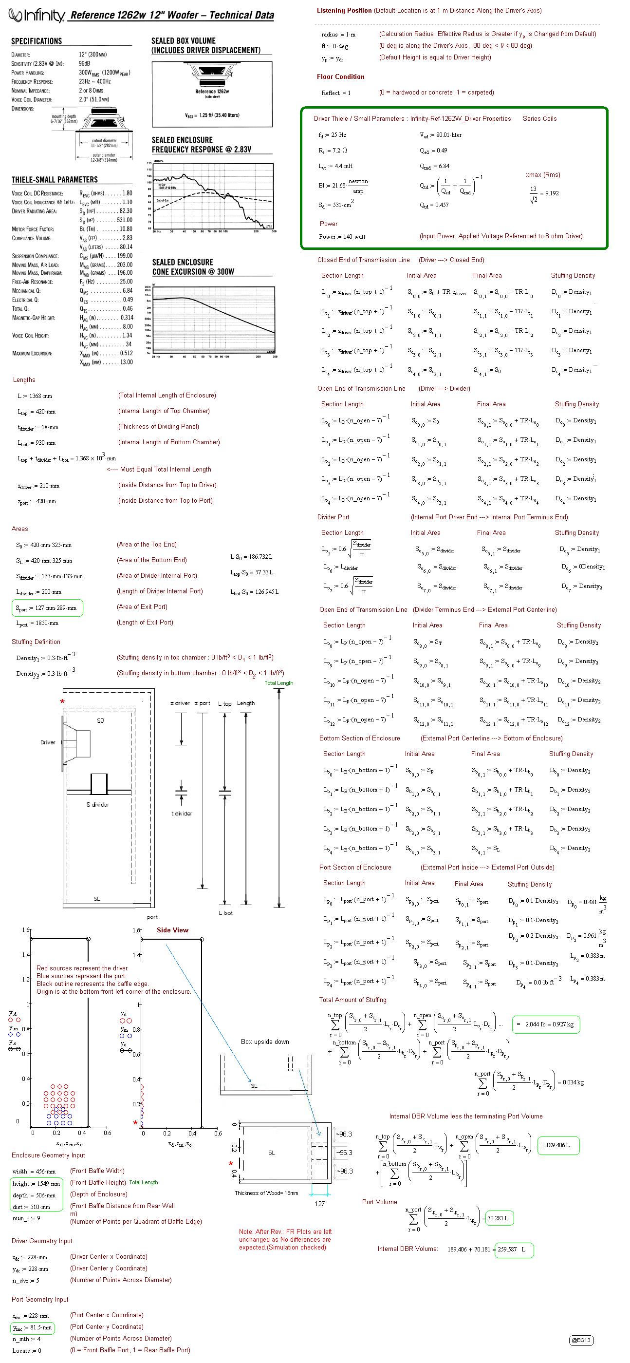

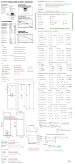

Dear bojorno,
the first schematic on your post is quite clear. But I have doubts regarding the second and third schematics. (Side view) , What are those small circles? and is the port partitioned with two separators ?
regards,
Alex
regards,
Alex
Dear bojorno,
regards,
Alex
Hi Alex,
FYI:
1. Look at the Picture again.
2. Yes: The Port is partitioned to decrease the Reynolds Number for the Pipe in order to prevent a non laminar Air Flow.
This design should work fine despite the very long Port System.
I've calculated the flow induced attenuation becoming equal to the viscous-thermal counterpart at a frequency of ~46 Hz, and the sum of these will add up to a negligible loss of only ~ 0.1 dB, IE. the attenuation due to the Port losses is solely defined by the amount of added Flow Resistance.
The preferred Pillow-fill that have the lowest Absorption characteristic of all commercial Stuffing types and will show the lowest FR attenuation above 46 Hz.
Be very careful to tease all Port stuffing and the weight of Port fill should be measured to be equal in each of the partitioned Volumes.
