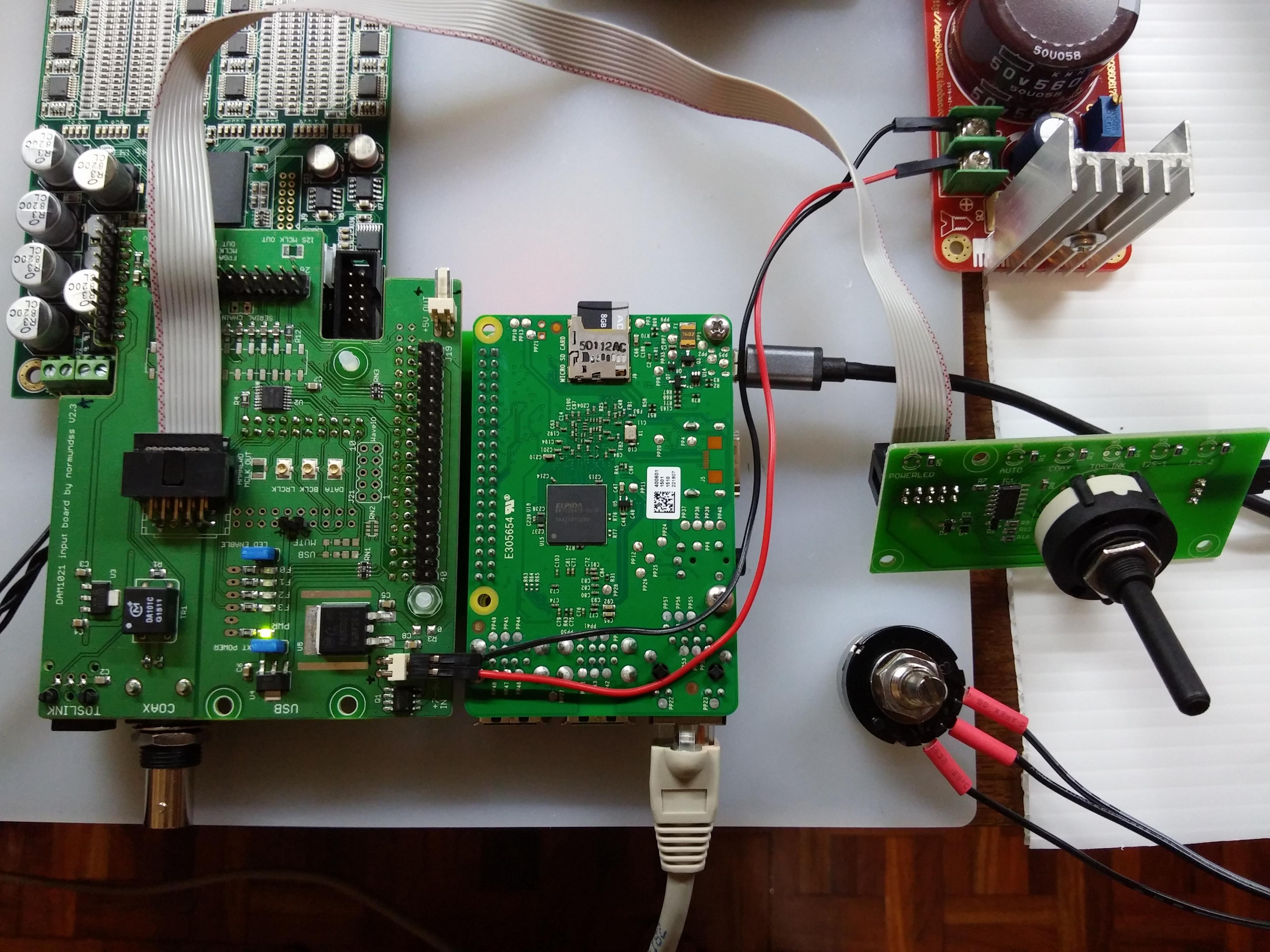

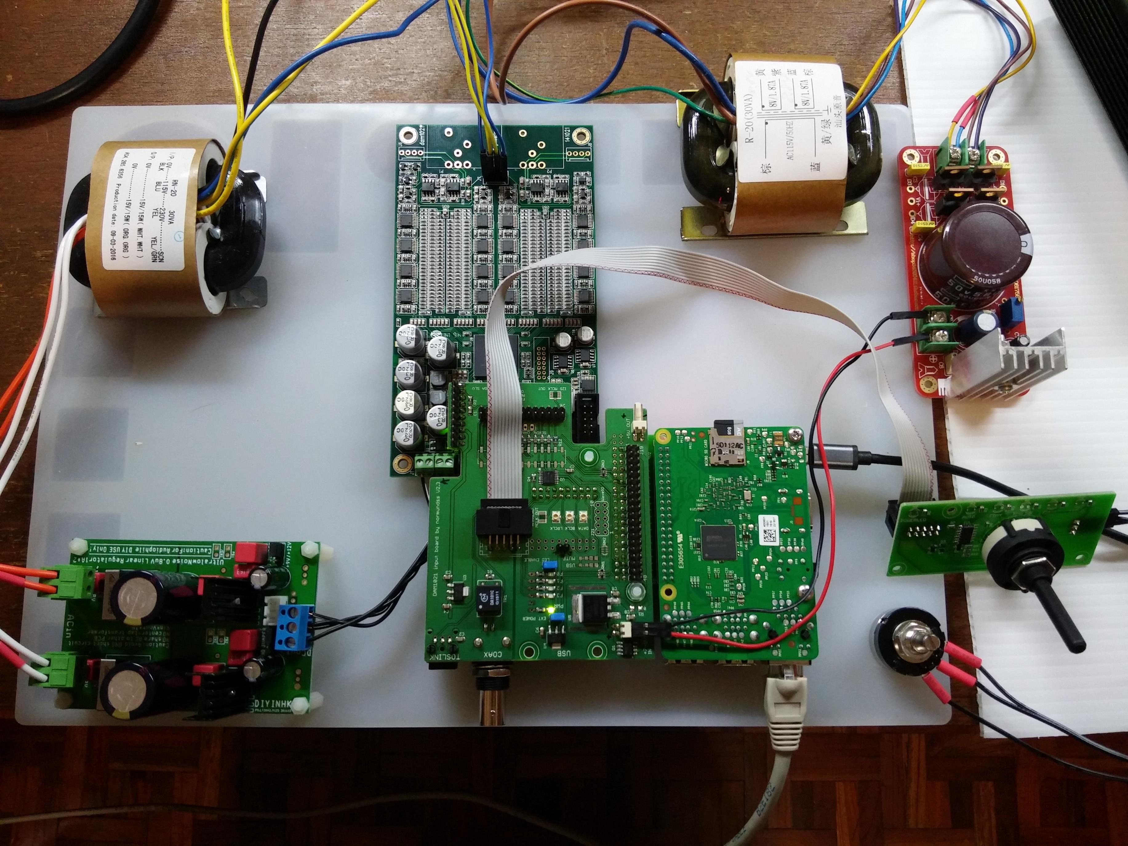

Noise when using volume pot with RPi attached to Input Board
I have encountered problem when played music from Raspberry Pi (RPi), which attached to Input Board, I could only hear noise for most pot positions. Originally, this issue was posted on DAM thread below as I thought this was a DAM issue,
http://www.diyaudio.com/forums/vend...magnitude-24-bit-384-khz-575.html#post4770669
Since it's more Input Board related, I re-posted it here. As RPi streaming is my main music player, I appreciate any help/comment to resolve the noise issue when using volume pot with RPi attached to Input Board.
Thanks!

Hi Normundss,
After further tests, I found that volume pot works for all sources (toslink, coax and Amanero USB) except RPi. Could you help to investigate and advise.
Thanks!

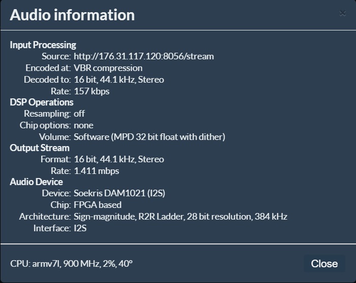

That is strange.
What sample rate do you use on the RPi?
Are you sure the DAM1021 isolators and the input board are powered when using the RPi?
Can you post pictures of your build?
Hi Normundss,
Thanks!
The audio source is Internet radio played with Moode Player. The audio rate is 16bit, 44.1kHz, 157kps.
DAM1021 and the input board are powered when using the RPi. The pictures of my temp build are attached for your reference.
Thanks!
