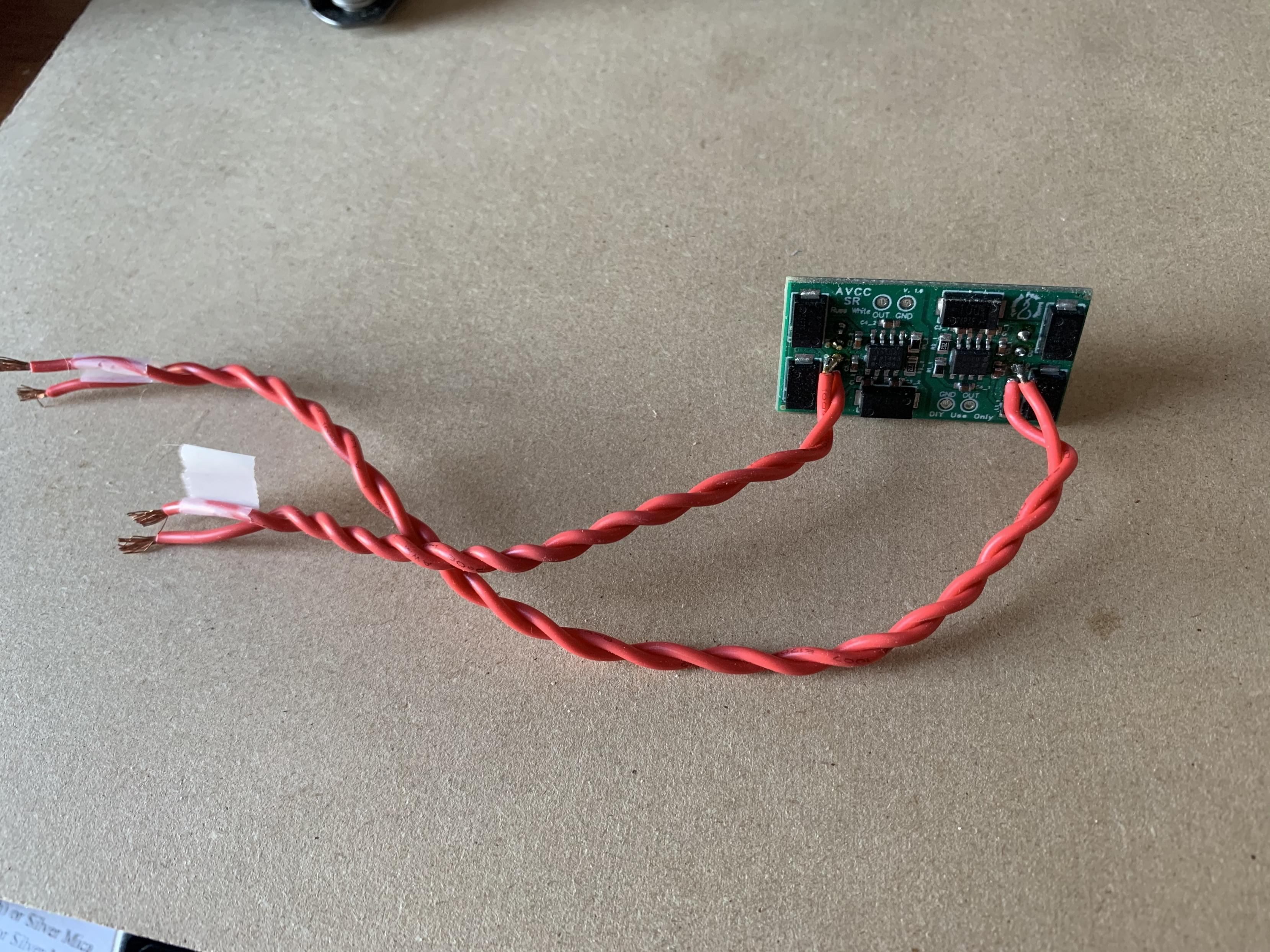

Reviving a dormant thread:
I'm wondering if it would be possible to supply both AVCC on the 9028 with a completely separate supply. I'm thinking either a 3.3V LiFePO4 cell for both, or 1 cell for each AVCC L and R.
Has anyone tried this? Or tried powering the AVCC pins of the 9028/9038 independently from the rest of the BIII board?
Looking through old posts here, yes I have been doing this. Possum has posted a few times on the TPA website about doing this also. I've tried feeding them 3.3v directly and also feeding the tridents with their own external power. Feeding the AVCC tridents with external power was a big improvement. I'm currently feeding two Sparkos regulators that output 3.6v with two separate ultrabibs.
I plan to ultimately have one toroid power the left side of the i/v stage and AVCC L and another to power the right side.

I first tried powering the AVCC trident with one Salas reflektor d becuase I had an extra supply. There was a definite improvement in clarity. I have been listening using Sennheiser HD650s directly out of the mercury, or with my main amp/speaker combo which is very resolving. I next tried omitting the AVCC trident and powering the AVCC L/R directly using the reflektor. The sound was a clear step down from using the AVCC trident powered by the onboard power.
I next tried powering the AVCC trident using two separate reflektors connected to a single transformer. This was another step up, although probably not as much as going from powering the AVCC trident with onboard power to an external supply.
Next I tried the Sparkos regulators, mainly because the 9038 was sounding bright to me. I find these slightly smoother and there are definite sonic differences compared to the trident even when using onboard power. I am currently powering each Sparkos regulator with its own Salas ultrabib connected to the same transformer. I ultimately plan to have the left side of the i/v stage and AVCC L hooked up to one transformer and a separate one for the right (I assume but don't actually know whether the AVCC L/R are separated within the DAC). The Sparkos like more voltage headroom so I am feeding them 9v from the Ultrabibs. The transformers will have 9v secondaries and 15v secondaries.
This set up sounds great with the 9028 (and good with the 9038 putting aside my issues with it sounding bright). I am going to try putting an ultra cap pair between the AVCC shunt supplies and trident/Sparkos regulators. I also plan to try feeding AVCC directly, but would only be able to do so with 3.3v.
I think the most basic step of powering the trident separately is a very worthwhile upgrade and whether you power l/r separately is a question of case space.

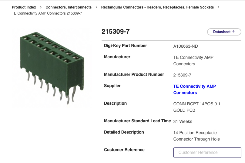

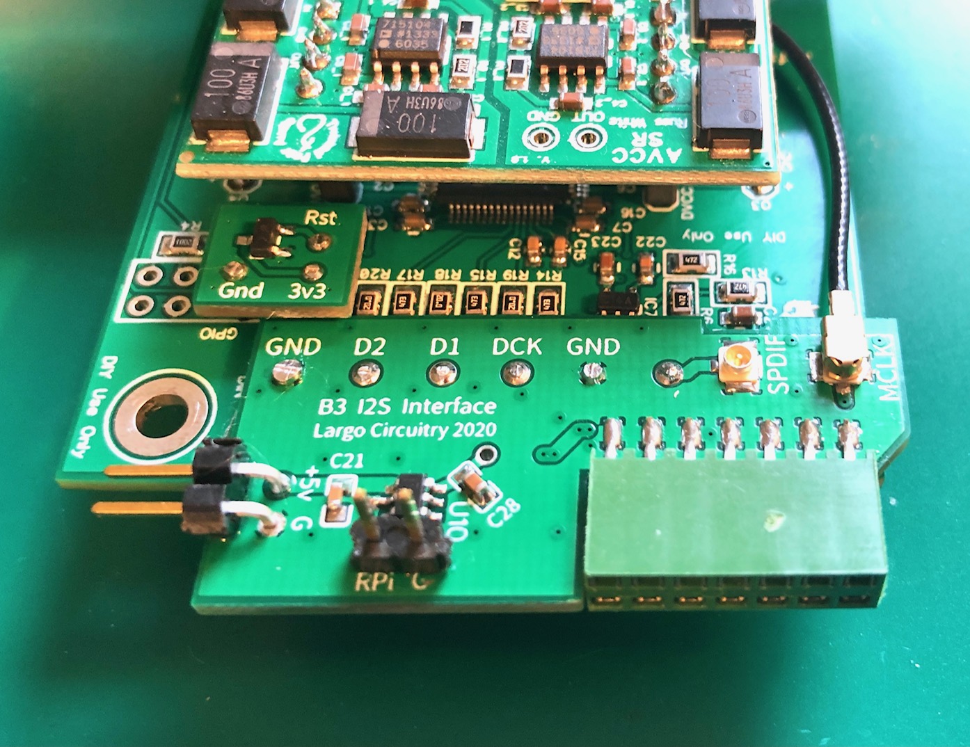

I had a question about the B3 adaptor shown in post 1002. This is to illustrate the application.
It is part of a small batch of boards I had made in China for my current project. Added here is a photo of the actual I/O connection without back panel in place. At left is an RPi with a custom GPIO isolation hat made to control this mix of boards and functions. Center is the XMOS USB reclock/I2S board I chose, and right is a (formerly retired) B3 9018 sounding just great atop a Mercury I/V board. Hidden but present are an OttoII and a Toslink receiver. So, this is the bigger picture. Other builds in this group are using 9028 and 9038 Buffalos. I removed the u.fl input connectors from the B3s and there is a layer of mica insulation between the adapter and the B3.
Hope this helps those who inquired.

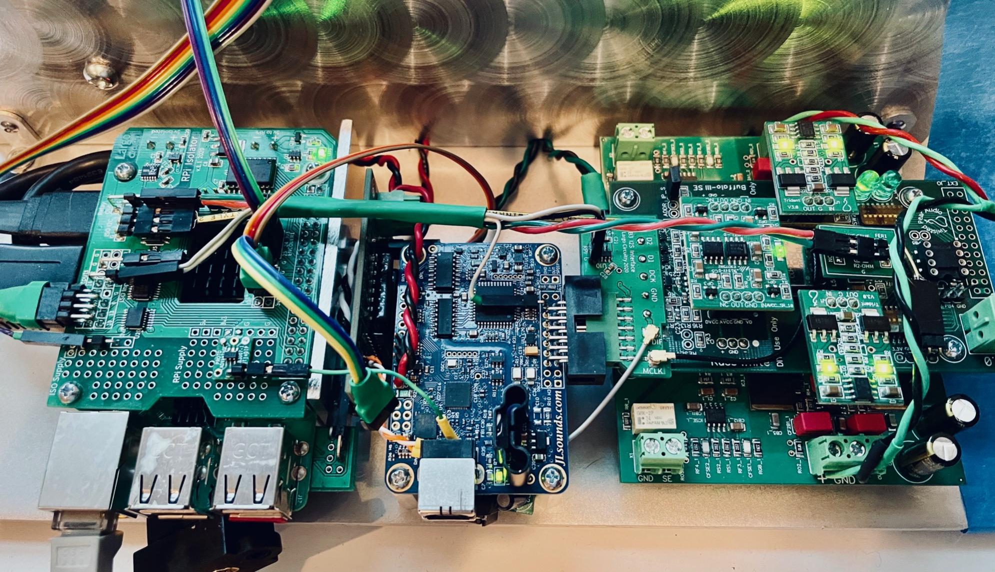

How do you like the JLsounds USB? I've seen that well-reviewed elsewhere. I have been very happy with the TPA cronus/amanero combo but am trying to get higher DSD rates to work.
Heyo @stew1234,
My first exposure to the JLsounds board was to try a 'No-DAC' for DSD. The interface worked just fine, though I'm not the only one who had trouble managing the needed high frequency filter and I dropped it. Since then the USB board has been re-designed a couple of times and is significantly improved.
I have no experience with the Amanero. Because of all of the pleasure I've gotten from TPA products plus their support over the years, I like to use TPA boards whenever possible. However, the current project has a cost ceiling and the JLSounds boards are less than a third of the cost of the Amanero/Hermes plus clocks (before shipping). So far the XMOS/Xylinx design is working well via my little connector/adapter. The USB boards provide good quality clock output at either 22/24 or 45/49, and it is no problem to run the lowest DPLL bandwidth in the various Buffalos being brought back into service. [Busy Santa's workshop, here!
I do plan to try PCM -> DSD conversion through these at some point, but not for a while. If anybody tries the JLSounds I2SoverUSB with DSD into a B3, I'd appreciate reading your experiences. I have a few extra adaptor boards that I am happy to share.

Question for a real engineer about I2C in Buffalo boards ...
Many thanks in advance!
Frank
- I made a simple GPIO isolator board for the RPi. For the I2C pins I used a TI ISO1540 IC. Data sheet here
- I2C communication with Buffalo boards works fine for a while (several hours to several days), but then fails. Eventually no bus is visible on the B3, but the isolator still broadcasts a START condition on command. The B3s continue to work normally except for I2C.
- The TI ISO1540 is wired exactly like the data sheet example [except for 2K pull-up resistors instead of 1K] running @3.3v and 100kHz.
- I2C in the Buffalo 3 boards that loose function had worked for years by isolated I2C from a TPA Hermes using a Si8600 IC for BBB output. Data sheet here.
Frank
Is the TI isolator IC damaging the DAC bus, whereas the SiLabs isolator did not? Any ideas what's going on?
Problem solved but questions remain. After replacing the I2C isolator on a rig with a 9028, I do indeed have restored access to DAC registers. What confuses me is that I2C only works reliably when a Trident is in place on the VDD_XO during power-up. Apparently, the management chip that holds the reset pin low on startup doesn't successfully activate I2C *without* the XO trident in place. Perhaps a longer 'low-hold' on power up is called-for...
