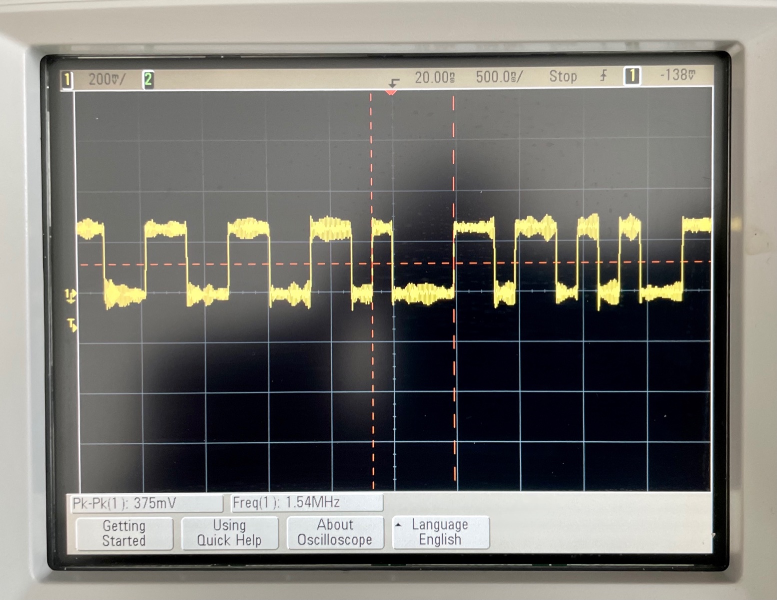

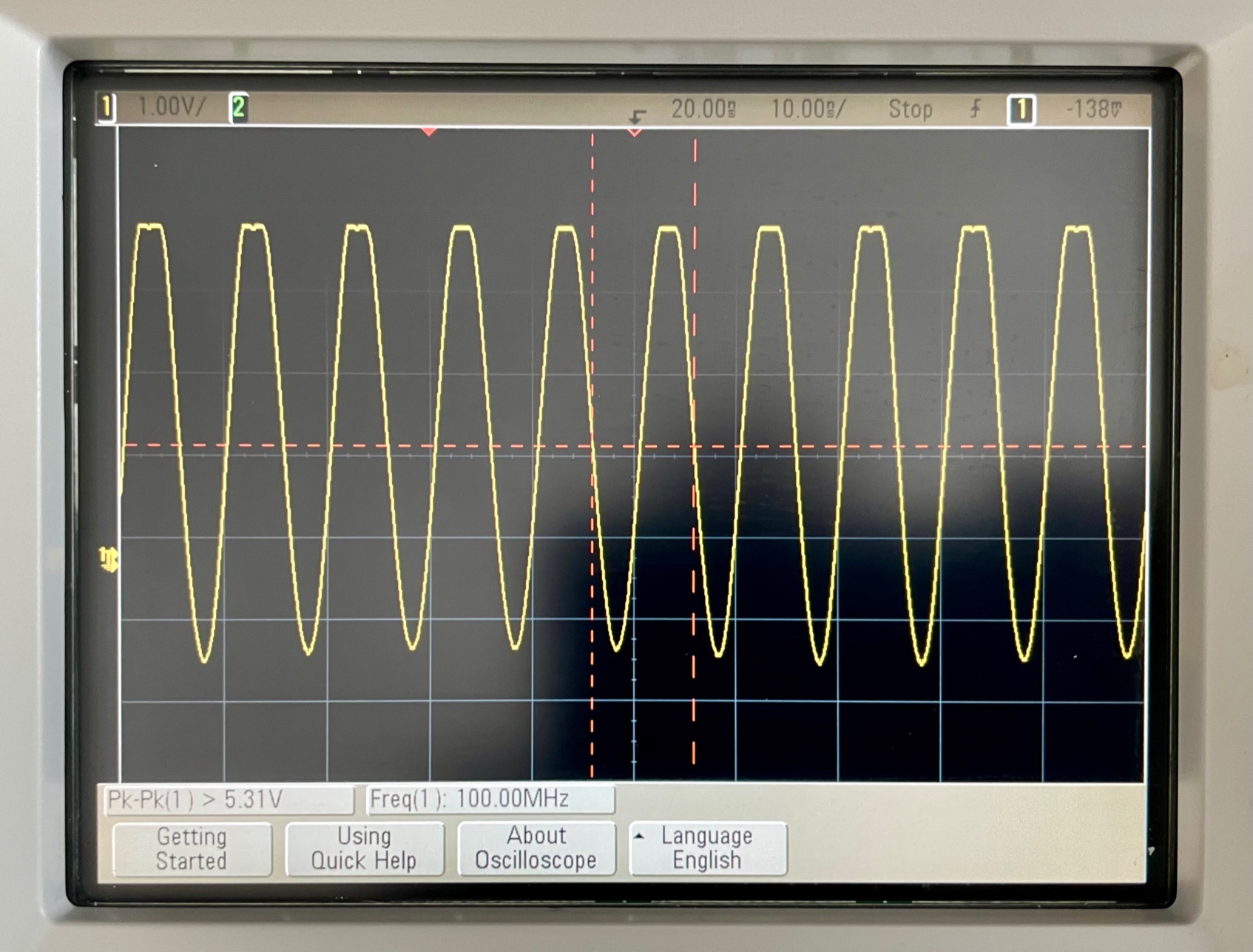

Problem solved but questions remain. After replacing the I2C isolator on a rig with a 9028, I do indeed have restored access to DAC registers. What confuses me is that I2C only works reliably when a Trident is in place on the VDD_XO during power-up. Apparently, the management chip that holds the reset pin low on startup doesn't successfully activate I2C *without* the XO trident in place. Perhaps a longer 'low-hold' on power up is called-for...
Sounds like the DAC doesn't have a functioning clock in time, I think you are correct to wait longer for the clock to be present.
Yes, thanks, that was the problem. Instead of using a boot management IC I switched to an isolated GPIO pin, whose timing is easily programmed.
My original design was to be able to use the 100MHz onboard clock with SPDIF, versus an external MCLK with I2S. I'm not succeeding in getting the old 9018s configured via I2C to work with the consumer level SPDIF from the TPA Toslink board. Toslink signal integrity doesn't seem bad (though only 375 mv p-p when connected to the B3, concern?), clock oscillations look good, and I2S is confirmed shut off. Is there still any online info concerning the 9018 register settings from the old B3 stock EPROM?
