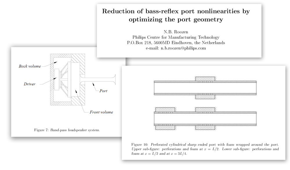

that's exactly what I am after. but instead of many holes with low absorption efficiency and high tendency of turbulent air flow around the holes I am trying to solve the issue with one very efficient opening, respectively one very light membrane.Thus, lowest mode in the pipe itself has pressure node in the middle of the pipe. Holes middle of the pipe would prevent pressure buildup, and reduce the first pipe mode.

I suppose you have seen clearly that @Kwesi used a second sewage tube to isolate the absorber airtighly from the box interior! that makes all the difference!Kwesi measurements show very good performance in this regard, as there seems to be very little other "noise" than the pipe mode, which is then reduced quite nicely.
edit: here is an excerpt of the philips/roozen paper that mentions port holes as possible solution to reduce resonances.
note that the port is not INSIDE the box! the paper does not mention this explicitly but it is highly relevant.
![roozen1.png roozen1.png](https://www.diyaudio.com/community/data/attachments/1147/1147699-4f2a18587afdcff44d1f4c773da3cb0a.jpg)
Hi, yes of course, that's exactly why I chose the wording like I did, that the holes are for the pipe mode and do work even without the sleeve for the pipe mode, but that isn't usually the only issue although very visual in the graphs. Should not have posted at all, seems to add just noise to the thread as you seem to be on top of it. Harmonics are something augerpro also measures in his thread, perhaps a good way to evaluate audibility of issues?

generally small ports will have much less resonant behaviour (length/diameter ratio is better) and further reduction is possible with resonance absorbers.

you can furthermore try to reduce the level of resonance by dampening the box interior (dapening material thickness should allow absorbtion of resonance peak frequency range, bass cannot be absorbed anyway, if we stay within reasonable box sizes). works even better with MLTL, as the port is far away from the driver, possibly even behind a TL fold.For anything big, I would always go for a MLTL. Which should have a lot less issues.
combining all these measures should allow to reduce the port resonance peak way below 20 dB of bass output.
Haha tell me about it!!I nearly decided that I'll just quit using ports, because after studying them in depht they seemed to be so flawed ...
Having holes in the port open to the speaker enclosure does effectively reduce resonances. I will go look for some data in a moment. I put this down to allowing a pressure release from the port node, but I have not considered the phase relationship between the inside of the port at tube resonance and the inside of the cabinet. Anyone know what that is doing?? It might be a different relationship than at fundamental helmholtz resonance.
