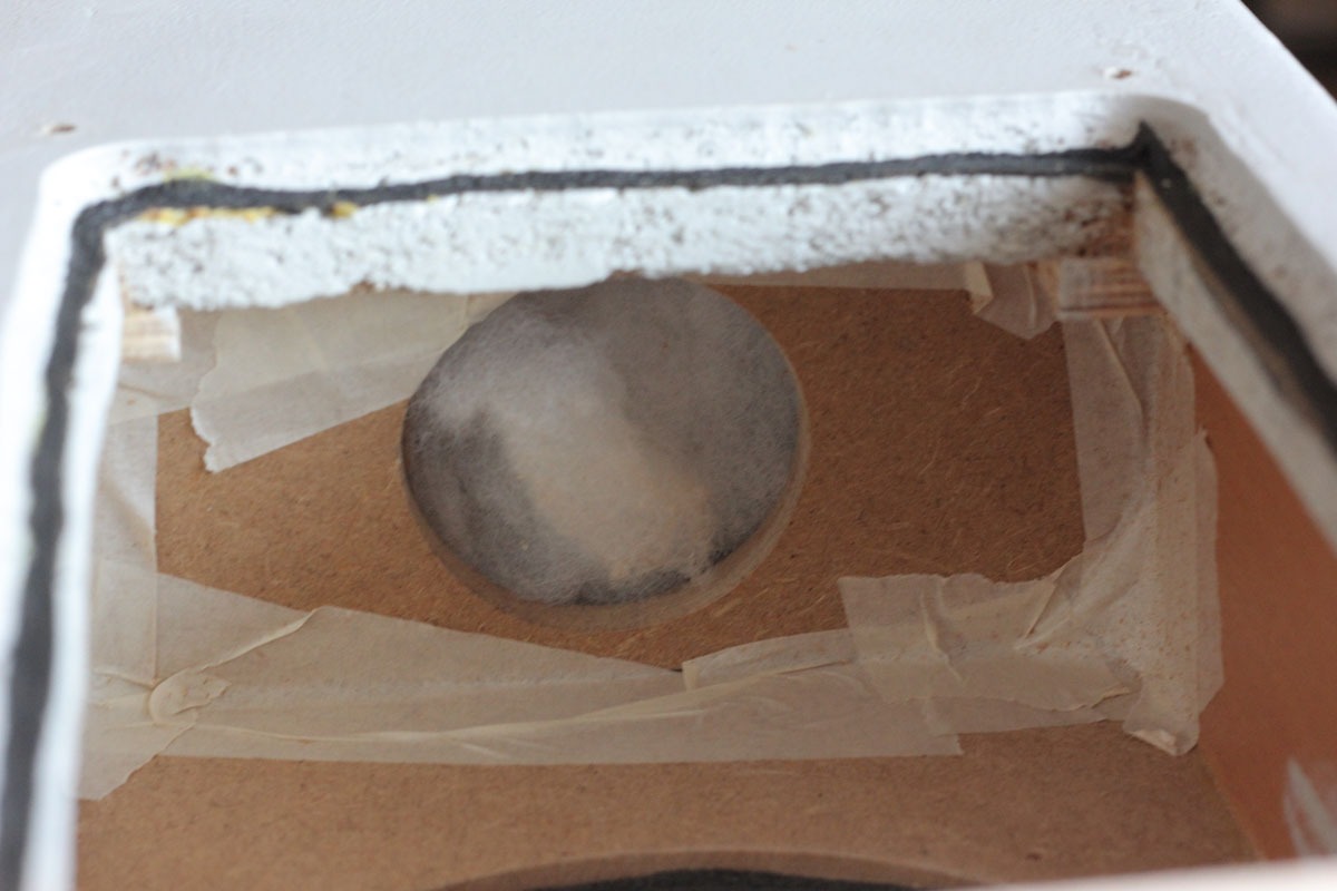

my first optimization step was to see how the lower enclosure resonances can be dampened/absorbed.
I first added basotect (melamine foam) to chamber 1 to dampen the longitudial resonance (660 Hz).
Optimum dampening occured when putting a strip of foam across the chamber with some distance to the back wall.
As i realized later this however also reduced bass output.
So I installed a small helmholtz resonator at the back of the chamber. Filling it with basotect on both sides and some polyfill in the center had the additional benefit of significantly reducing the port resonance (780 Hz).
I also tried dampening and installation of a helmholtz resonator in the bigger chamber V2 to remove the resonance at 300 Hz. Basotect strips across the width of the box were again useful to dampen the resonance but also reduced bass output, so i went on to build a helmholtz absorber.
I could not install a simple board with central hole as in V1 and this made things considerably more complicated.
The small internal resonator enclosure changed the existing resonance(s). Also, the calculated resonance frequency of the internal helmholtz resonator was much different than expected by simple calculation, probably because the “port” ist near the enclosure wall and probably several other interactions with the whole enclosure.
The best results i could achieve were by opening half of the “helmholtz” resonator and putting a piece of basotect at the open surface of the little stub.
I guess V2 should now rather be called a mass loaded quarter wave resonator with some dampening in the lower end!

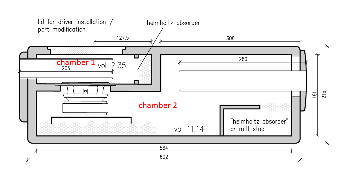

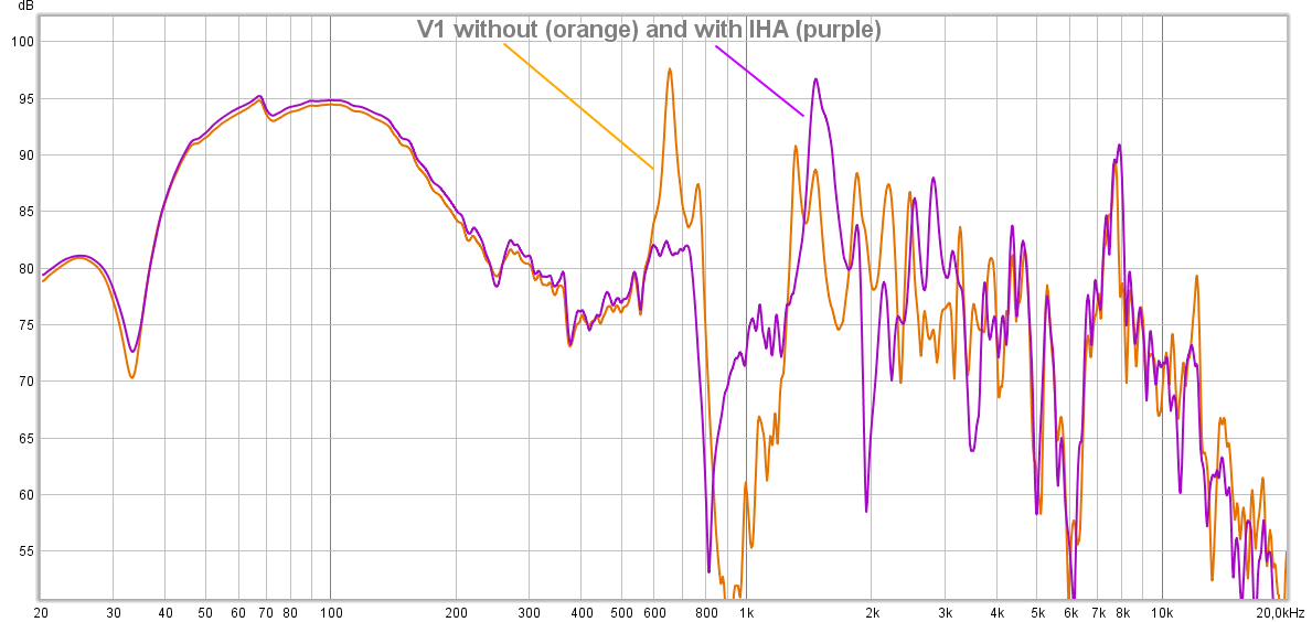

![IMG_1754-V1-IHA.jpg IMG_1754-V1-IHA.jpg](https://www.diyaudio.com/community/data/attachments/1113/1113531-f281ef1531c31fbef1ee7691118100a5.jpg)
![230823-V1-reso_optim.png 230823-V1-reso_optim.png](https://www.diyaudio.com/community/data/attachments/1113/1113533-c2d6d9250964ba9ae4d4b05354e1052f.jpg)

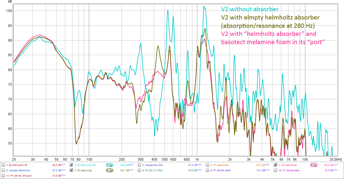

![230820-box2.png 230820-box2.png](https://www.diyaudio.com/community/data/attachments/1113/1113532-57887989333947125215028017f380e9.jpg)
![230823-V2-reso_optim.png 230823-V2-reso_optim.png](https://www.diyaudio.com/community/data/attachments/1113/1113534-bfc8ef20fccf565bc5e9ee2f4daa5cee.jpg)

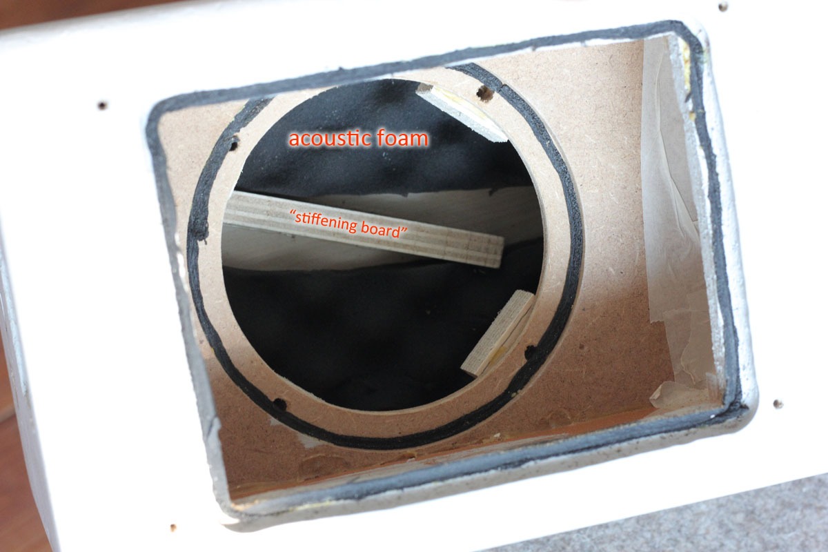

there was an additional resonance audible when tapping on the board below the driver. Strangely this resonance got much higher (360 Hz) when tightening the screws of the driver. I thought that a stiffening board might help, but did noch change anything.
![IMG_1753-V2-stiff.jpg IMG_1753-V2-stiff.jpg](https://www.diyaudio.com/community/data/attachments/1113/1113535-9ef52e4145cbbfb7f71d3d5df9dc6115.jpg)
I could have added more dampening material on the walls etc. to reduce the higher resonances. But these are so far outside the usable bandwith that i did not continue here.

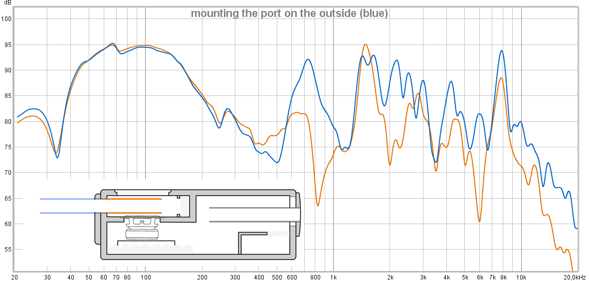

what happens if the port is mounted on the outside of the box instead of the inside?
as to be expected the longitudinal resonance (influenced by IHA) has a pressure peak at the enclosure wall and exits the port.
so, it's good to keep interior port ends in the center of the box to avoid transmitting pressure peaks. I did not, however, check what influence (chuffing?) it has if the port protrudes into a velocity maximum in the box...
![230823-V1-port_outside.png 230823-V1-port_outside.png](https://www.diyaudio.com/community/data/attachments/1113/1113538-7243d83e6e7b0b9686c44b946c4b3283.jpg)

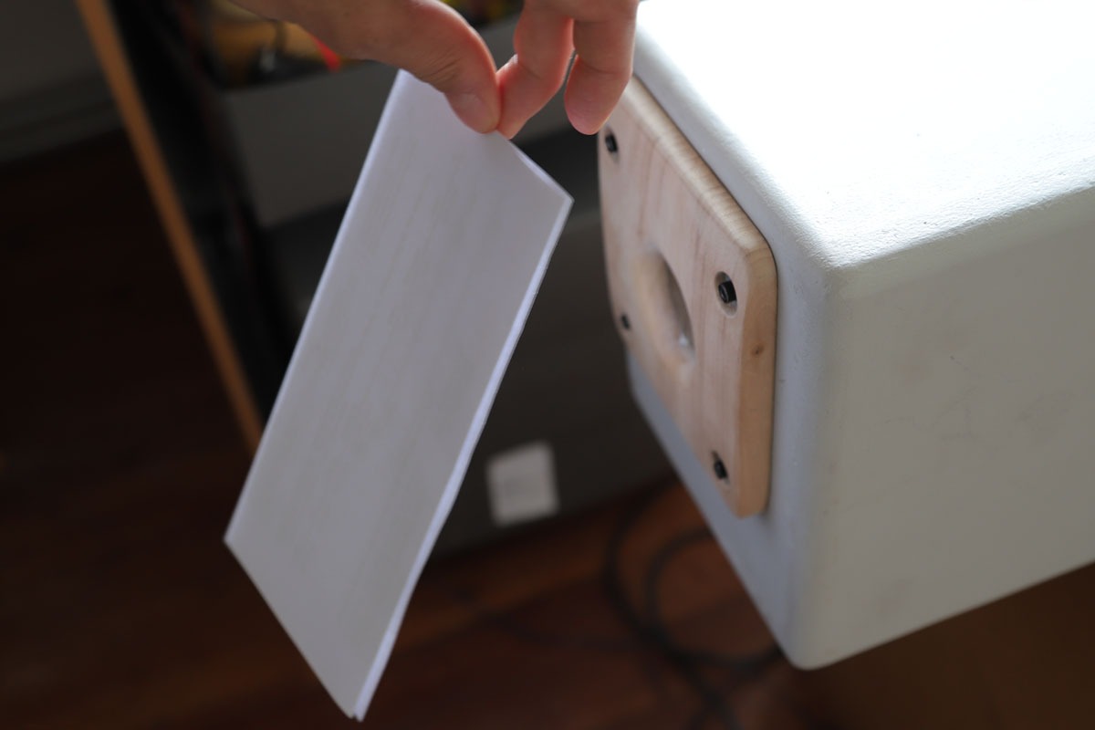

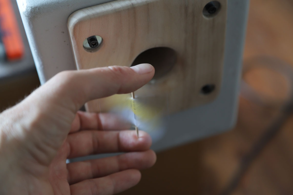

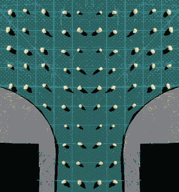

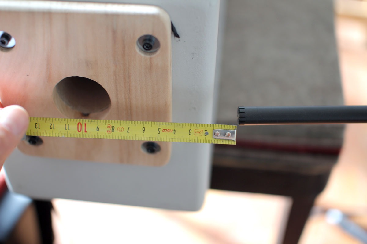

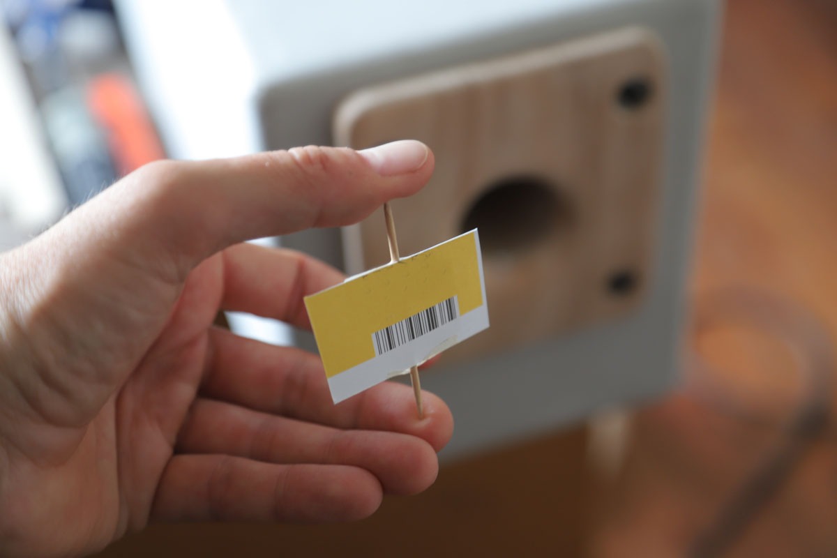

anyone ever wonderd why the ports seem to be blowig air out?
I didn’t and just thought that’s how vibrating air feels.
and of course a port should not blow air - where would all that air come from??
But in fact the port does indeed blow air! one can feel the port air flow even 1m away from the port!
It’s very easy to test with a sheet of paper or a small propeller using a loud sine at the box resonance frequency:
the paper is only actually vibrating (and slapping against the port) if held very close to the port exit.
The reason is: with higher pressure inside the box the port blows air straight out (directed flow from the port) but when the pressure in the box is lower than outside the air flows in from any direction around the port (and indeed mostly from the sides. by the way I don't think this has been addressed in the bezzola paper).
Moreover, with longer bass notes there is a constant flow of air starting just outside the center of the port and a return flow from around the port. I suppose for high levels this circular flow can be quite large!

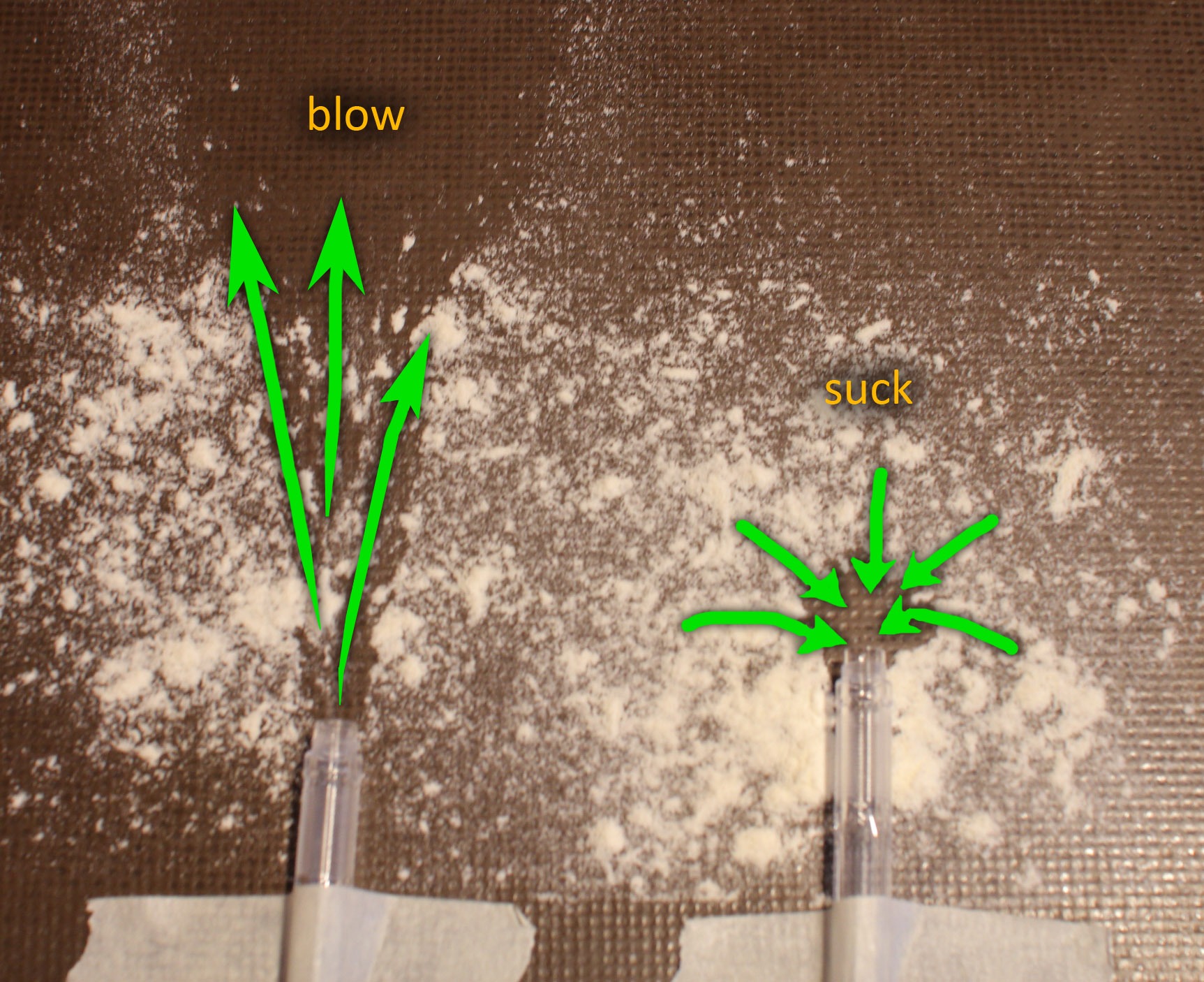

here is another small test:
blowing air is directed and has a long throw in exactly one direction.
sucking air (i didn't - it was a vacuum cleaner!) collects air from all around the opening.
This is in accordance with my experiments. Chuffing is mostly being created by air flowing back into the port from the sides. Sharp edges or rough surfaces around the port exit create turbulences and noise.
Also, if the port does not easily allow free return air flow from the sides (sharp edge) the efficiency is probably reduced because more air (weigth) is coupled to the port vibration, but it's not a coherent directed flow like inside the port (that in that case would virtually prolong the port) and will cause losses and noise.
In my tests there were two main “chuffing” noises:
![IMG_7920-paper-test.jpg IMG_7920-paper-test.jpg](https://www.diyaudio.com/community/data/attachments/1113/1113602-365844122e21e36cebd15d2c85cd88cf.jpg)
![IMG_7919_propeller1.jpg IMG_7919_propeller1.jpg](https://www.diyaudio.com/community/data/attachments/1113/1113601-ef247373ea90b489042ad0033b7ebd92.jpg)
![IMG_791x_propeller2.jpg IMG_791x_propeller2.jpg](https://www.diyaudio.com/community/data/attachments/1113/1113600-a04b35df11d4ee1049490a42359b4991.jpg)
![flowdiagram.png flowdiagram.png](https://www.diyaudio.com/community/data/attachments/1113/1113643-d1c8910ad1bd5e12795ffe1c24a1ae8c.jpg)
![230818-airflow.jpg 230818-airflow.jpg](https://www.diyaudio.com/community/data/attachments/1113/1113599-44d986e07e40f1be43975c1a5962b76f.jpg)

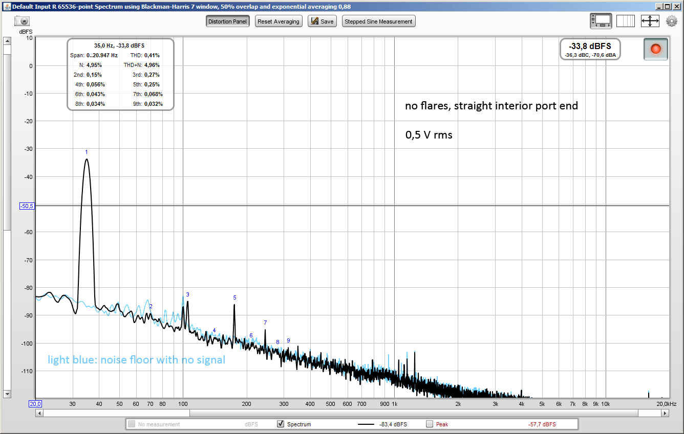

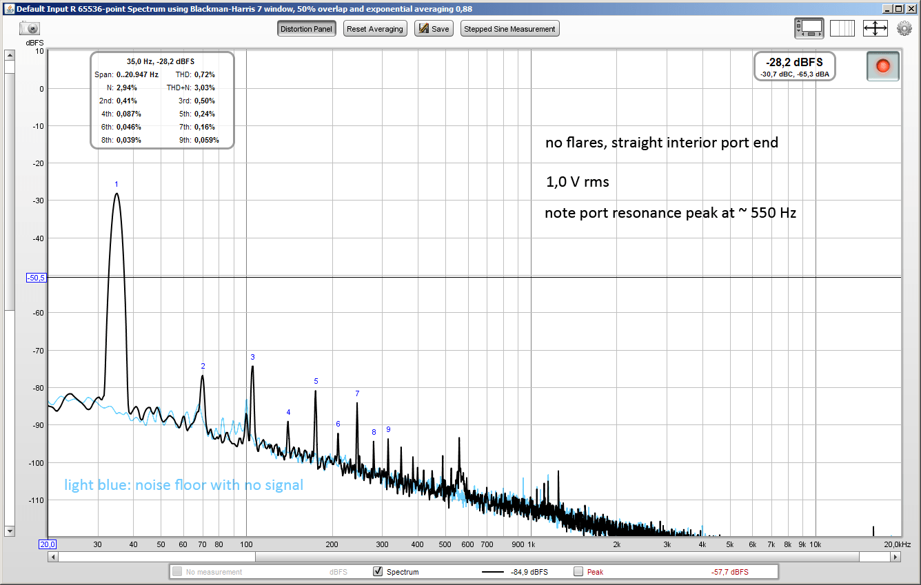

how audible is port chuffing?
I did a very informal test using a wave file composed of three parts:
lorde uses a synth bass that seems to be based on a pure sine or at least it’s heavily filtered, thus does not allow masking of distorsion with existing harmonics.
And the piece is in D and the lowest bass note is therefore 35 Hz (well, probably 36 Hz ...)!
Please keep in mind that the human ear is very unsensitive at such low frequencies and thus any distorsion is even more audible. So it’s a really tough test!
Here is a table with my subjective results from the straight, unflanged and undampened port(s), in about 1 meter distance from my ears.
For the music tests I added the (highpassed) fullrange speaker shown in post #19.
This was just a rough test – I did not care too much about a perfect system.
I also add objective data from REW measurements and hornresp simulation.
*) background noise!

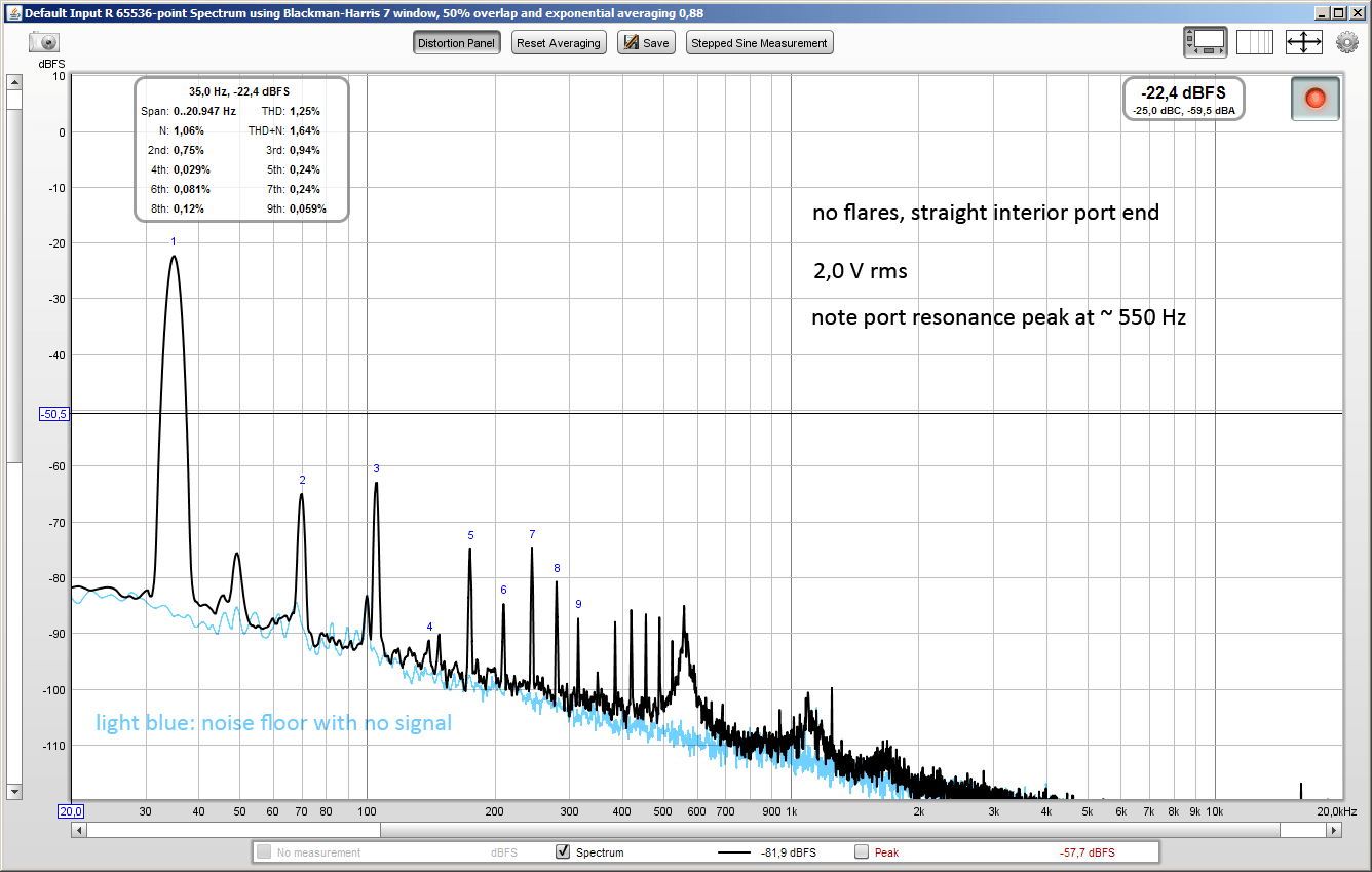

amp output voltage (V rms) | Chuffing audible with sine? | Chuffing audible with low passed music? | Chuffing audible with fullrange music? | SPL dB @ 1m | REW measurement for sine tone noise “N %” | REW measurement for sine THD % | Hornresp simulated port velocity (m/s) / (% of mach1) | Subjective impression / remark |
0,5 | no | no | no | 61 | 4,95 * | 0,41 | 1,3 / 0,38% | Sine tone is barely audible! |
1 | no | no | no | 67 | 2,94 * | 0,72 | 2,5 / 0,74 % | Sine tone is very silent |
2 | Yes, noise with audible port resonance pitch | no | no | 73 | 1,06 | 1,25 | 5,1 / 1,51 % | Noise with clearly audible port resonance peak is quite annoying for the sine tone. |
2,83 | Port resonance clearly audible | no | no | 76 | 1,04 | 1,75 | 7,2 / 2,12 % | ... even more! |
4 | Port-resonance whistle | Yes, for a particular part (see remark) | no | 79 | 1,21 | 2,62 | 10,2 / 3,01 % | Chuffing is audible from port 1 during a short section where two bass tones overlap; quite fatiguing. |
8 | Chuffing and port whistle much more audible than sine tone | Yes! | Cant identify as „chuffing“ but music seems uneasy | 82 | 1,6 | 6,79 | 20,5 / 6,02 % | Music seems to be too loud, impulse to lower the volume instinctively. |
16 | Very loud noise and port resonance | Clearly audible, mostly kickdrum at port 1 | Clearly audible at peaks, music is very uneasy | 88 | 2,08 | 14,7 | 41 / 12,05 % | Subjective impression: it’s far too loud, I immediately want to turn it off. This, by the way may partially be due to the small fullrange driver playing near its limit! |

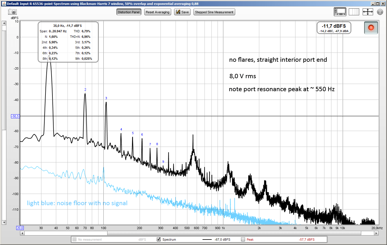

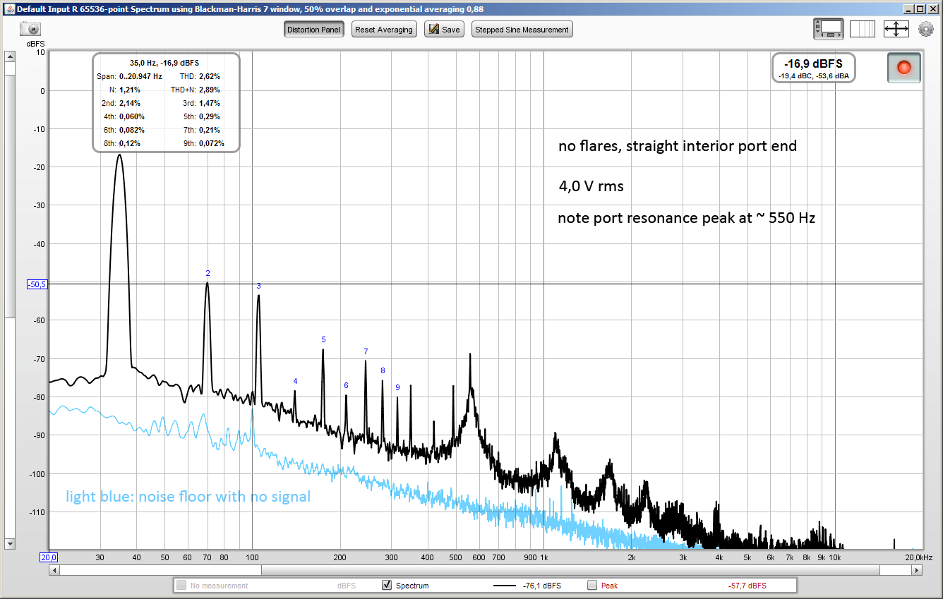

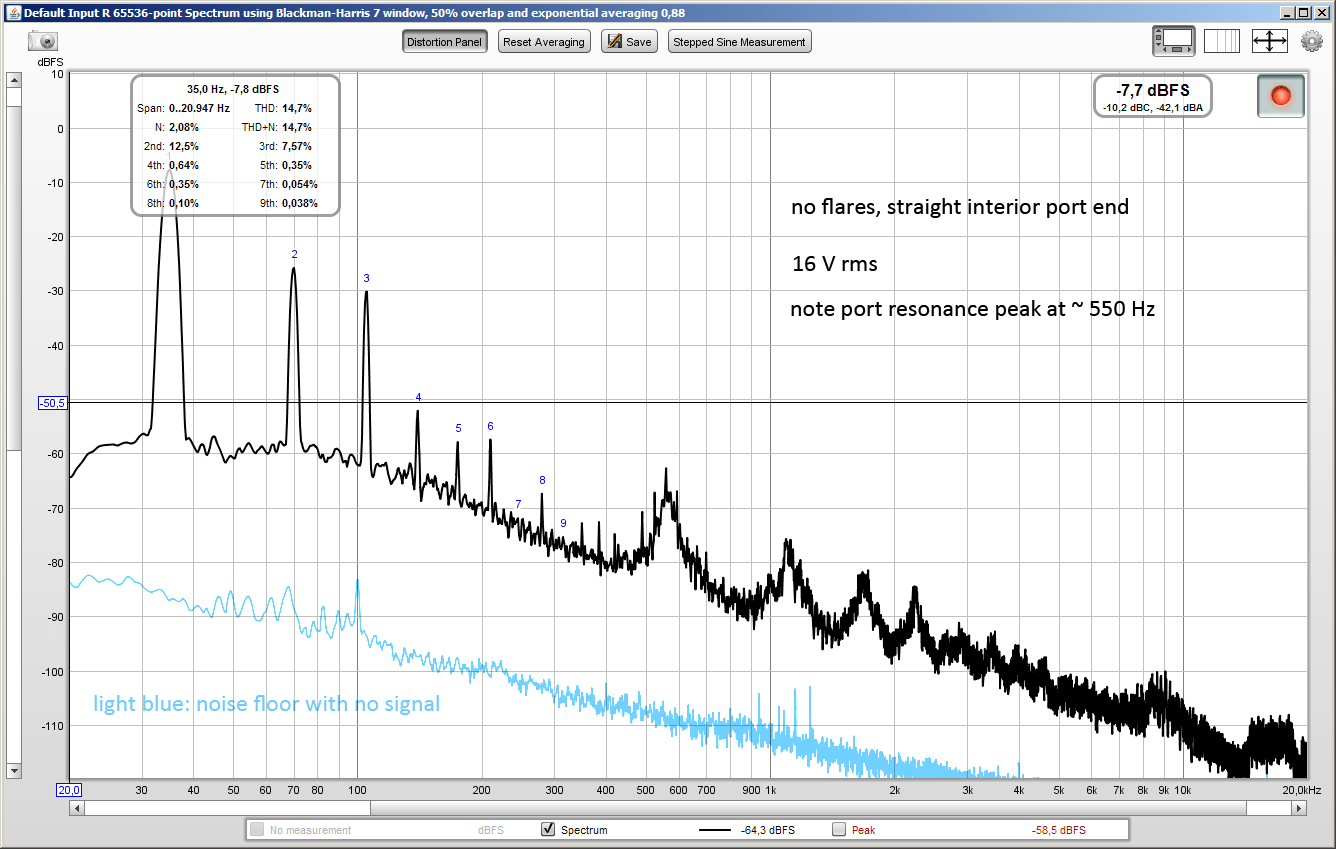

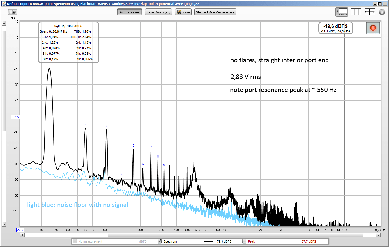

here are the corresponding spectral analysis results of pure sine tones in the same order as the table above:
from 1 V on the port resonance is clearly excited; already with 2 V the first harmonic of the port resonance is visible.
generally the noise floor raises; for high levels the noise increases in the lower area and at about 9 kHz.
THD raises gently up to 4 V and then more rapidly. this is mainly due to H2 (and H4) - might be a result of the very unlinear air movement as mentioned in post 24.
by the way: the poor little woofer reaches its xmax at about 8 V rms for frequencies other than 35 Hz!
![230817-01_noflare_straightpt_05.png 230817-01_noflare_straightpt_05.png](https://www.diyaudio.com/community/data/attachments/1113/1113676-ac3355585dae792ba1db2e163bc8fe34.jpg)
![230817-01_noflare_straightpt_1.png 230817-01_noflare_straightpt_1.png](https://www.diyaudio.com/community/data/attachments/1113/1113673-e57309fab067414bd6b293678469a10d.jpg)
![230817-01_noflare_straightpt_2.png 230817-01_noflare_straightpt_2.png](https://www.diyaudio.com/community/data/attachments/1113/1113674-6377d14feb1d16d7cb4f881db3a460d1.jpg)
![230817-01_noflare_straightpt_283.png 230817-01_noflare_straightpt_283.png](https://www.diyaudio.com/community/data/attachments/1113/1113672-6cd4c2e2b284df51c5d22c91ea0d4a2b.jpg)
![230817-01_noflare_straightpt_4.png 230817-01_noflare_straightpt_4.png](https://www.diyaudio.com/community/data/attachments/1113/1113675-05fe3fcf89e0856c61757194815f2bd8.jpg)
![230817-01_noflare_straightpt_8.png 230817-01_noflare_straightpt_8.png](https://www.diyaudio.com/community/data/attachments/1113/1113677-ec42502ad67c70bb3abf4112c04bd249.jpg)
![230817-01_noflare_straightpt_16.png 230817-01_noflare_straightpt_16.png](https://www.diyaudio.com/community/data/attachments/1113/1113678-c83c66956364d8ee43023858d1bd708f.jpg)

I initially wanted to keep this to a later post for creating more suspense - but anyway, here it is:
blowing helmholtz ports are a sign of "port stall"
this is similar to airport stalling (well, less dangerous) because the controlled flow of air is disturbed and turbulences are created, loosing port output.
this is fun to test out (see post #24 and post #34 - thanks @Dmitrij_S !) but it is higly undesirable for good sound, because it creates distorsion, chuffing and a loss of output (compression).
here are two very rudimentary animations that show the principle:
first the bad, ugly, stalling and blowing port:
![port_stall.gif port_stall.gif](https://www.diyaudio.com/community/data/attachments/1114/1114062-e747b047875df55bdb8d1199d9054839.jpg)
and now the good port:
![port_good.gif port_good.gif](https://www.diyaudio.com/community/data/attachments/1114/1114061-bd9cbba7c6d10df29a4689a1c60f7e31.jpg)
my investigation showed that probably any port will stall at a certain level.
however, the bad port starts stalling (and blowing) at tiny levels.
the good port will only eventually stall at extreme levels.
once more my lousy experiment images:
![230818-airflow.jpg 230818-airflow.jpg](https://www.diyaudio.com/community/data/attachments/1114/1114063-44d986e07e40f1be43975c1a5962b76f.jpg)
the "natural" flow characteristics of a simple, hard edge tube end shows huge differences for both flow directions.
for a port we need to do everything to keep the flow out from the port and the flow back into the port as similar as possible (thus: consistent sound waves!).
every change of flow characeristic during change of air direction will produce turbulences which create chuffing, distorsion and SPL losses (aka: compression).
I will introduce a spectacular new testing method for port stalling in my next post:
stv's helmholtz port stalling test (c) - "SHePoST"
this will also include fact-based evidence in the form of THD, chuffiing noise and compression measurements.
and some examples of good (and maybe very good?) port designs - not entirely new I must admit
stay tuned!
