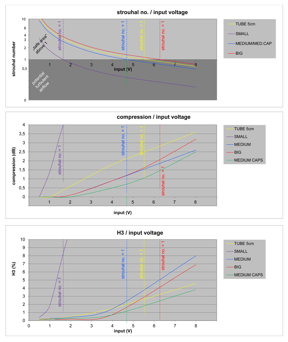

Update of post #556 but using correct strouhal calculation method:
data from the RTA chuffing/noise/harmonic distorsion graphs, but arranged in a more comprehensive form:
the correct calculation method for strouhal number (credit to DavidMcBean) just rearranges the "strouhal number" limit of 1.
It is now clear that for useful music reproduction the strouhal number should remain a good safety margin above 1.
because the graphs above are mostly interpolated between the measurements at 0,5 - 1 - 2 - 4 - 8 V, I will provide a new measurement with smaller increments and additional subjective impressions.
relating the strouhal number to compression and distorsion
- strouhal number, calculated for the port variants at respective input voltages (referring to port exit radius).
- compression ratio (dB), referred to the lowest input signal
- 3rd harmonic distorsion

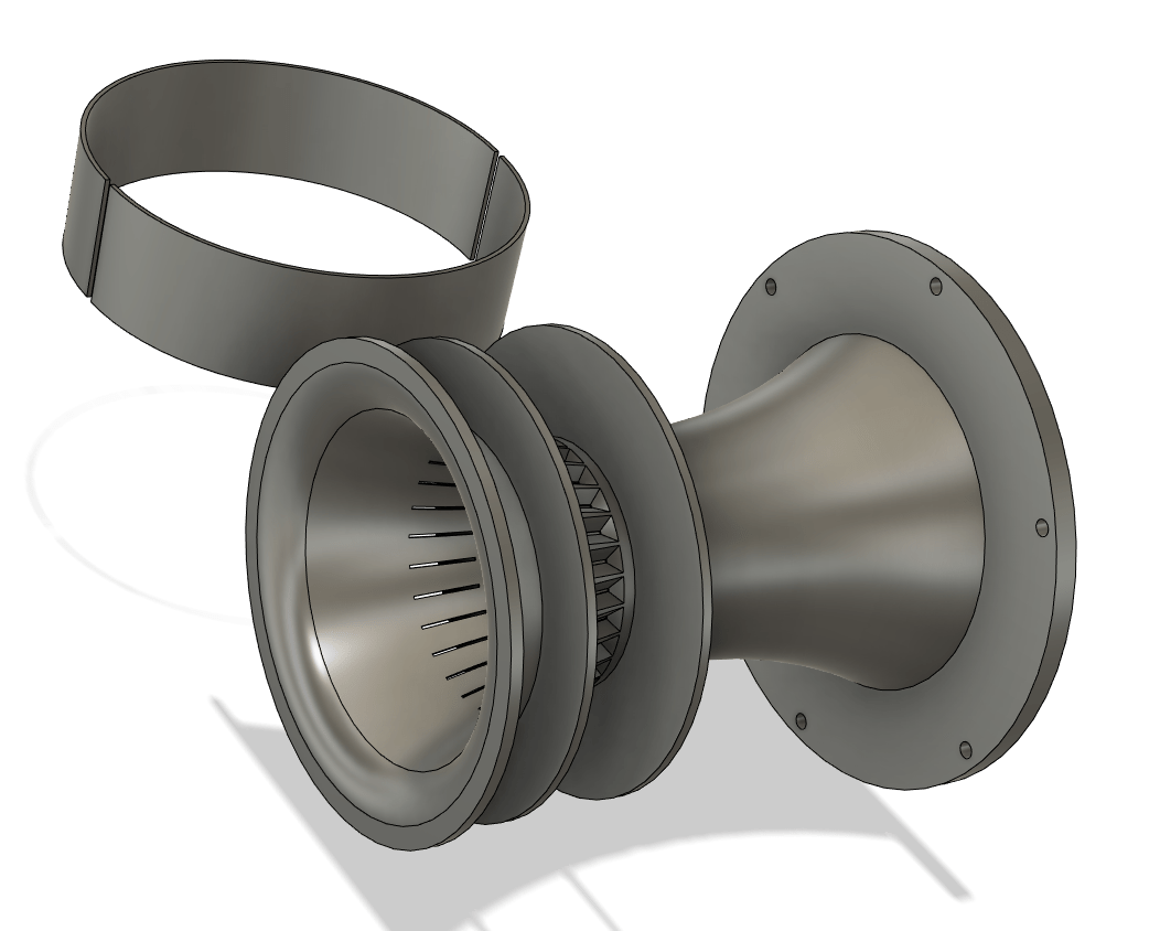

I will see if I have time today to verify your tool with my existing ports. If anyone wants to use this port, attached is the F360 .f3d file. The only user change should be port length and port radius at the center of the port. Everything else should scale with those changes.

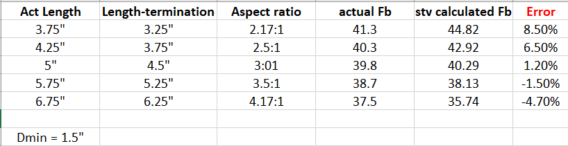

Here is the comparison of this spreadsheet to 5 test ports I made. All ports are Dmin = 1.5". Some caveats...the measured tuning can shift within about +/- 0.7hz every time I make a measurement. I selected the value that came up most often in a run of 6 measurements. Also, I'm converting from imperial to metric when I use stv's worksheet, so there will be a bit of error there.
I also included aspect ratio of the length to Dmin. It is interesting that if I had a port with aspect ratio 3.25:1 there would probably be zero error between calculated an actual. Above and below that we see a systematic error with a pretty clear relationship to the actual measurement. Certainly this is very promising and usable for me!

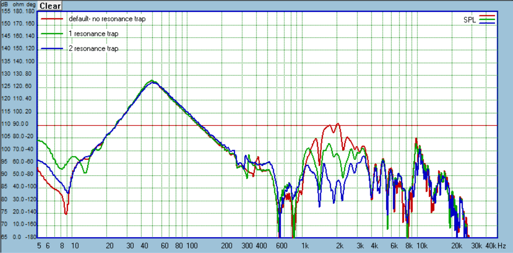

If you really want to turn it up to 11, attached is the .f3d for my port with 1 resonator to damp the pipe resonance. 2 resonators damped the pipe resonance more but really suffered in chuffing and distortion. 1 resonator is a decent tradeoff. I couldn't detect any issue in my very short listening session, but Erin didn't hear any issues either when I sent my prototype to him. Again, user inputs are length (d3 in sketch 1) and port radius at the center of the port (d2 in sketch 1). I couldn't make the same tweak as the version I posted above because one of my operations depends on this port radius value, and for whatever reason, operations cannot depend on a driven dimension in F360. So after using stv's worksheet to design the optimum port, use half of Dmin to enter this value in d2. The third user input is related to the diameter of the caps that cover the resonator. Enter the value from d151 in sketch 8, into d74 in sketch 5. I use super glue to attach these and fill the resonator with wool batting.
That's very generous of you, thanks!attached is the .f3d
I'll try it out, very curious about the result.
Thanks for the tests! Yes, that looks pretty usable to me too!Certainly this is very promising and usable for me!

I've wanted to share this port design for awhile but since I could not figure out the tuning, I kind of put it on the back burner. If your spreadsheet works out and can calculate a Strouhal number, I'd be happy to host that and my .f3d files on my website so people can start making these ports.
When do you think you might be able to do your own tuning verification? It seems to me the systematic error is a good thing because you can correct for that by finding an empirical correction factor.
I will testWhen do you think you might be able to do your own tuning verification?

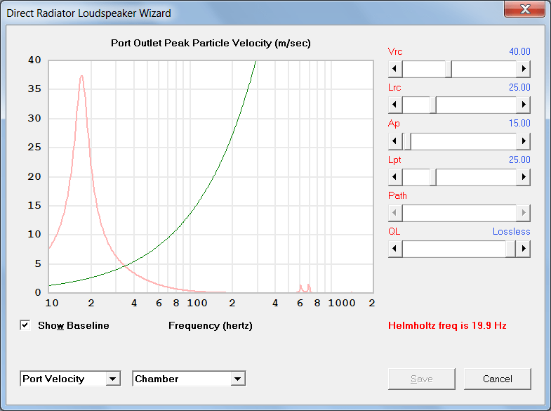

The green line on the attached chart shows peak particle velocity vs frequency for a Strouhal number of 1, given port outlet area Ap.
Would this feature be worth adding to Hornresp? It would be switched on or off by pressing the L (for limit) key.
Absolutely!Would this feature be worth adding to Hornresp?
I am still working on whether the strouhal number limit of 1 is really useful for high quality music reproduction or if it should stay even higher.
But the number one limit can be a great guideline that needs to be respected with some safety distance.
What we do know for sure, confirmed in the papers, is that going below a strouhal number of 1 does degrade efficiency and increase noise.
I am about to make a chart with all measured vs calculated ports, to see if I get similar deviations!I also included aspect ratio of the length to Dmin.
Could you check once more the aspect ratio - I cannot replicate your results:
First example Lact=3.75 Dmin=1.5
3.75/1.5=2.5
You stated 2.17 however.
Am I getting something wrong here?

maybe just in STEP file, so everyone can open it?Fusion360 - you need to open it to export a printable "stl" or "3mf" file.
step can't provide parametric adjustability - which is key to have a useful model that can be adjusted following the excel sheet!
But I could provide a collection of different printable models in stl, 3mf or step format.
I will also try to model a parametric port in freecad.
3.75/1.5=2.5
Thanks again!
Doh! My original notes used the length minus 1/2 of the termination roundovers as you normally do when calculating port length with roundover terminations. So the length used for aspect ratio is actual length minus 0.5". I'm not sure which method you want to use but I would think subtracting these termination lengths would be more accurate, at least for shorter ports. Unless it is somehow accounted for already in your calc?
Perfect, I just wanted to know the calculation method for comparability!used the length minus 1/2 of the termination roundovers
I have a similar "error" for big length/diameter ratios.
