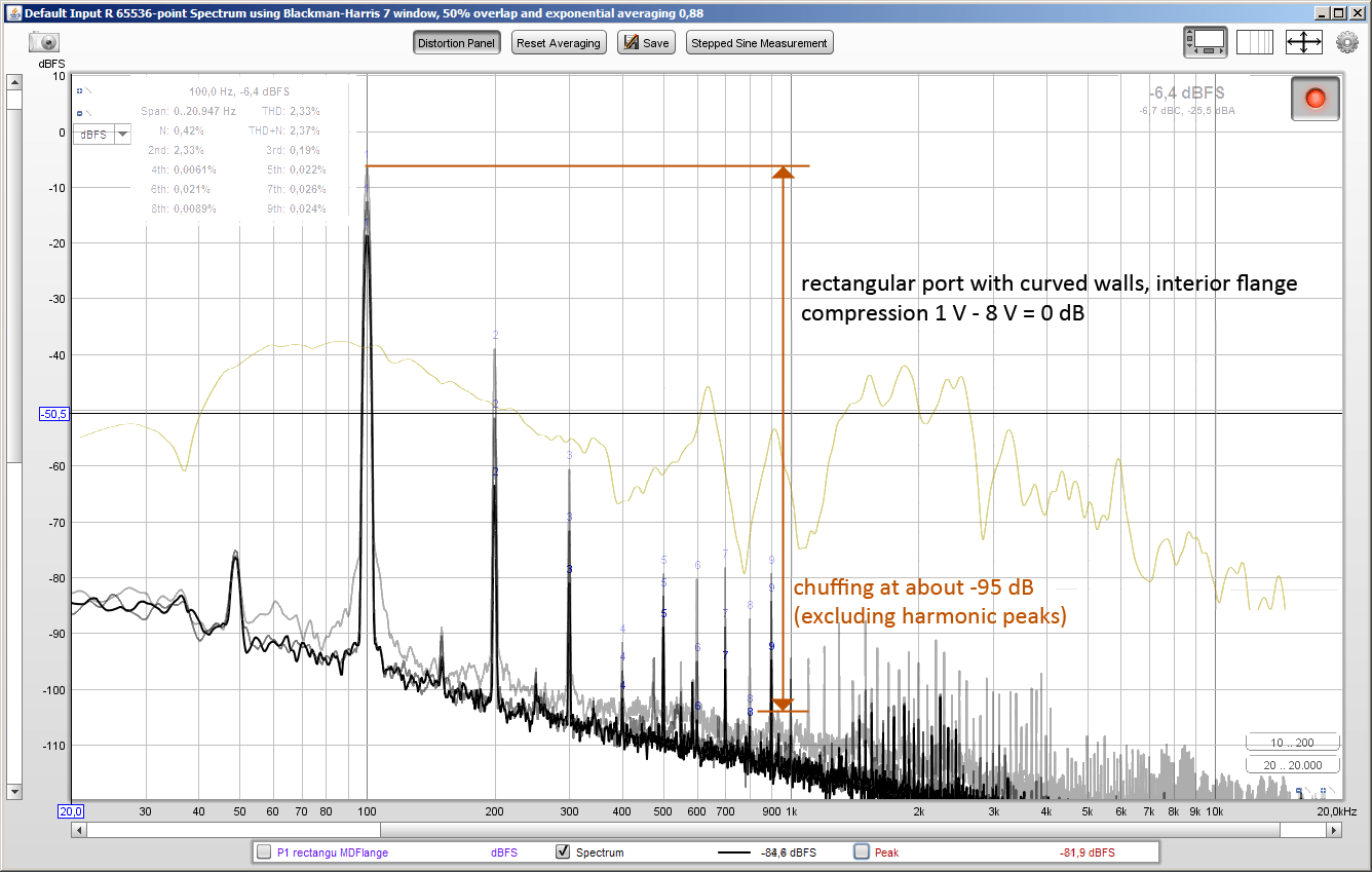

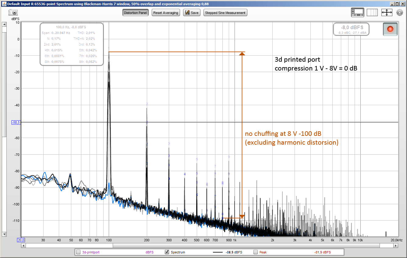

chuffing measurement of rectangular curved walls port and 3d printed port
here are the (slightly less crowded) measurement graphs for chuffing at 1 V, 2 V, 4 V, and 8 V (in fading shades of grey) for the curved wall rectangular port and the 3d printed port, the latter with sanded, smoothed and fillered interior port surface:![231109-P1-rectangu.png 231109-P1-rectangu.png](https://www.diyaudio.com/community/data/attachments/1140/1140893-4ff7e61be1ea975e6e002480df130db1.jpg)
![231109-P1-3dprint.png 231109-P1-3dprint.png](https://www.diyaudio.com/community/data/attachments/1140/1140892-198d19fcac4981a67eff37b6e50537fd.jpg)
both ports have a very good non-chuffing behavior, with none of the typical chuffing resonance peaks even at 8 V input.
no turbulent energy loss leads to no measurable compression.
I once more included the port response for the rectangular port to show the correlation of (higher) harmonic peaks and the response.
air speeds

from the airspeeds and measured chuffing I once more conclude that the chuffing problem is not related to the (narrow, in the case of curved walls) center section of the port but the port ends.
I should mention that while the small 5-inch driver of course has low excurcions at the resonant frequencies of the bandpass chambers it will reach it's Xmax of 5 mm at frequencies between 60 and 80 Hz with around 8 V input.
so it probably makes sense to consider this a sensible limit, also for chuffing.

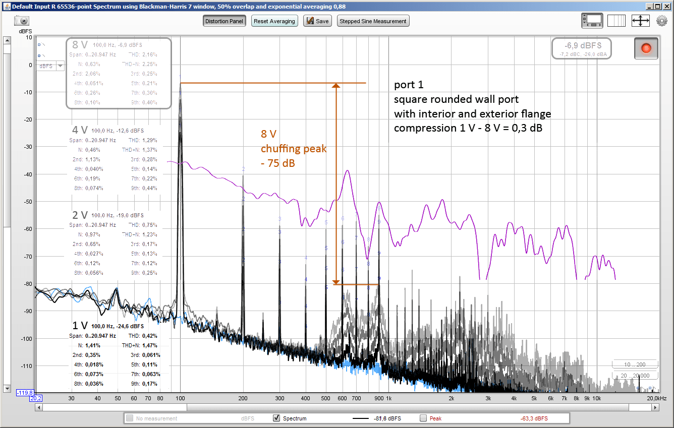

chuffing measurement of square plywood port
![231110-P1-square_flange.png 231110-P1-square_flange.png](https://www.diyaudio.com/community/data/attachments/1140/1140994-eb26c4f32d86ba3d49546b4f5a62f737.jpg)
I suspect that the added "chuffing" turbulent air flow is created by the rough surface of the plywood, a not-perfectly smooth trasition between interior flange and port and eventually by sharp, not rounded corners of the port.
the cross sections are the same as for all other curved wall ports and cross section dimensions are even very similar to the 3d printed port.

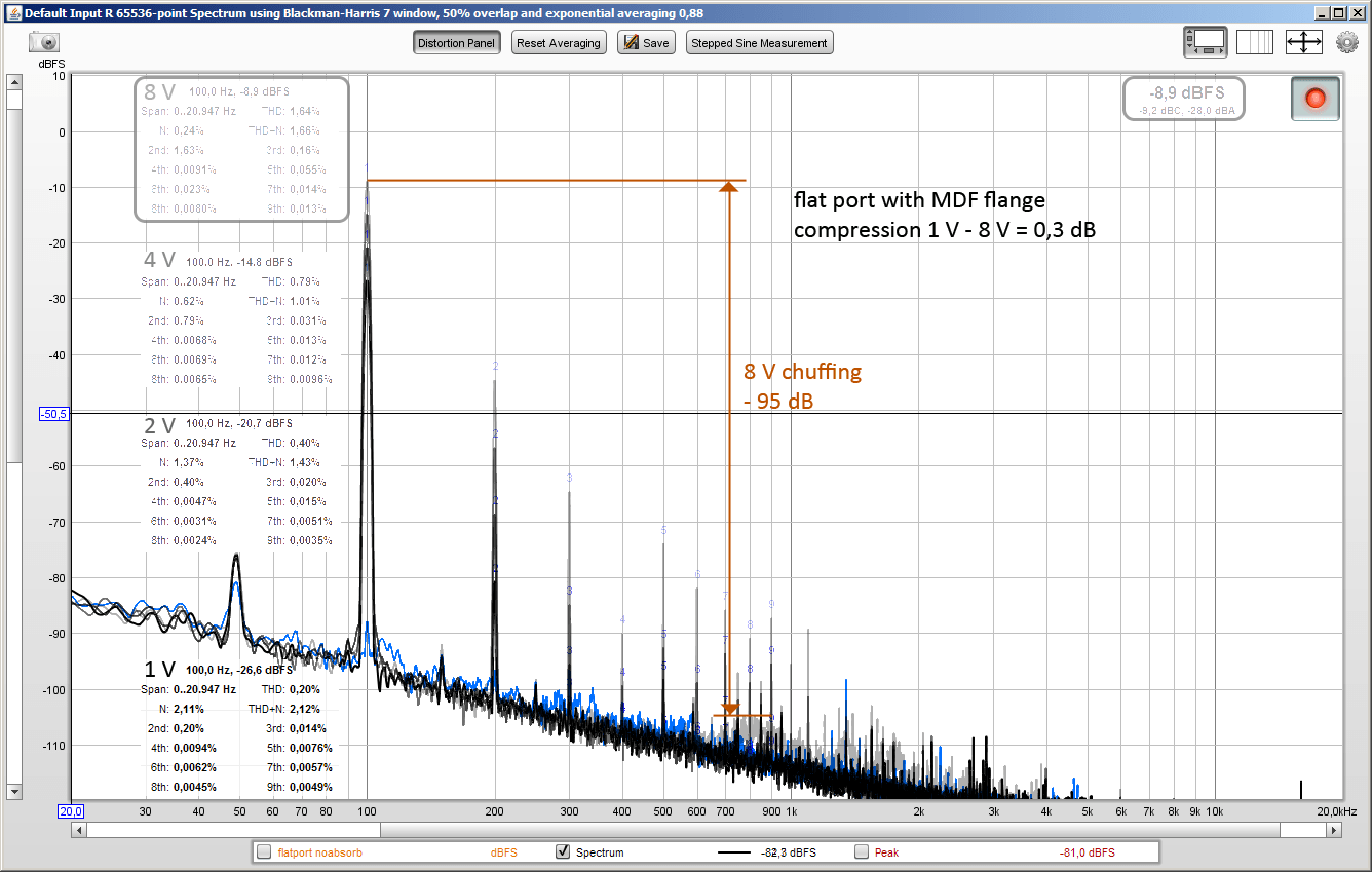

flat port chuffing graph ...
![231110-P1-flatport.png 231110-P1-flatport.png](https://www.diyaudio.com/community/data/attachments/1141/1141002-936fc4d4154d69b5f247f11c493fa4d4.jpg)
I thorougly sanded, smoothed and rounded over all interior edges with putty and painted the port with primer.
this resulted in very low chuffing, even if the port surface is increased.
I suppose the 3d printed port with even lower chuffing noise had a slightly smoother interior surface. another reason is probably the difference in interior edge length, thus reduced turbulent "air intake". and the more compact cross section.
my conclusion regarding a slot port:
the longitudinal port resonances are significantly reduced and this can be an ideal solution, as that as long as picking up enclosure resonance pressure peaks from enclosure walls can be avoided.

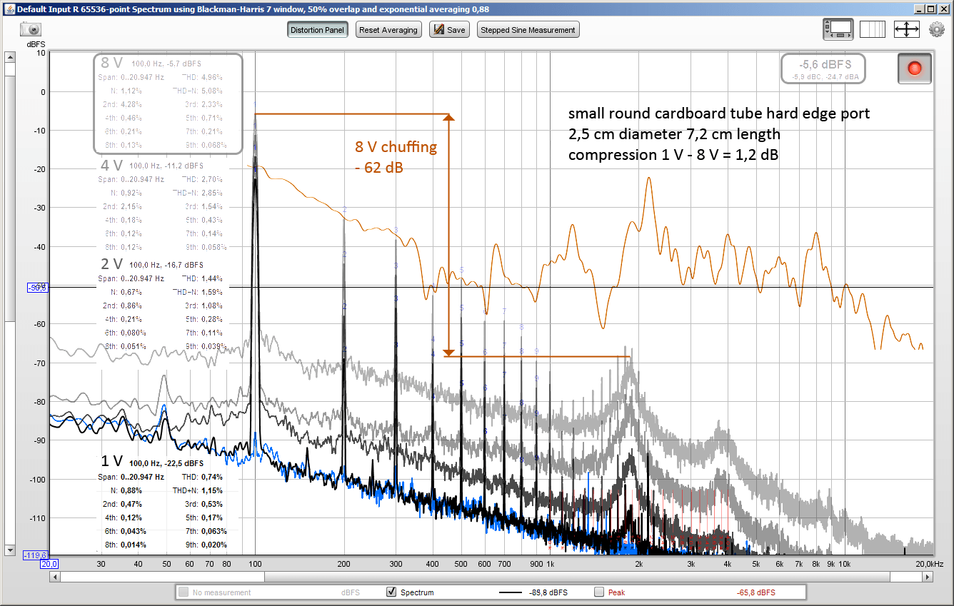

... and small straight port chuffing graph
![231110-P1-smallport.png 231110-P1-smallport.png](https://www.diyaudio.com/community/data/attachments/1141/1141003-ebf359775d19c1b6fa96dc6d167c3679.jpg)
as to be expected with its cross section of only 4,9 cm² and the hard edges inside and outside this port produces a very high level of chuffing turbulences, simulated airspeed at 8 V around 34 m/s = 10% of speed of sound. also the compression between 1 V and 8 V is now -1,2 dB (energy lost in turbulent air flow).
in contrast to the other ports the noise is raised over the whole bandwidth and the chuffing resonance peak seems to be similar for different outputs. this may correspond to the observation of low Q resonance of straight port in the roozen paper. I think the high excursion turbulent airflow prevents building up of a high Q resonance.
of course the chuffing of this port was very audible, however it was not as annoying as with other ports, because the resonance "whistling" was mostly masked by wide bandwidth wind noise (edit: this refers to an extended 100 Hz sine tone).

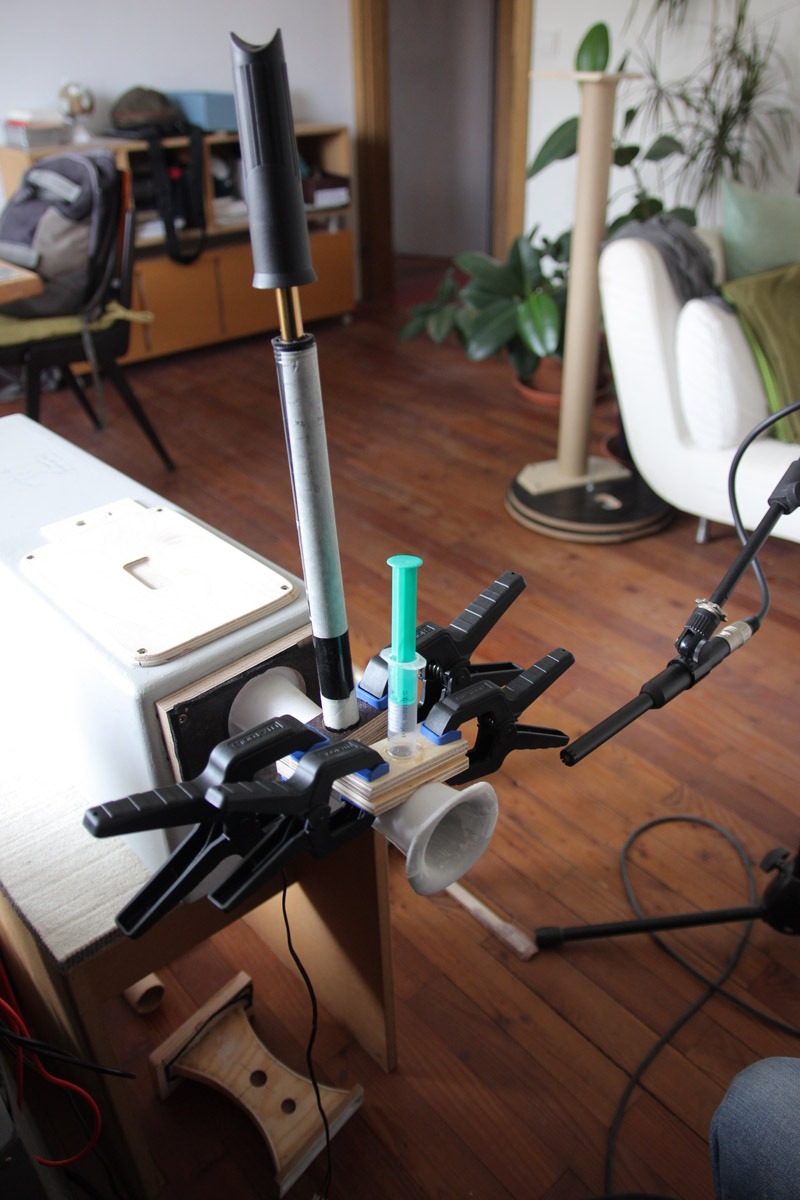

returning to resonance absorber ideas
with these (and several more) results and insights I went on to investigate how an "absorber" (or better called an "additional resonator") mounted to the center section of the port influences the total resonance behaviour and eventually could combine the least chuffing with a non-resonant behaviour.I took the 3d printed port and the flat port and drilled a 2cm hole each in the middle of the port (half port length, for absorbing the fundamental length resonance) and another smaller one at a quarter of the port lenght (for second harmonic resonance).
I found ideal variable length resonators/absorbers using a syringe and a bike air pump.
both are cut open at the "lower" end.
the air pump needed some silicone to tighten the air intake valve of the piston.
both are mounted with airtight epoxy on small boards that can be mounted at flat boards on the ports:
![IMG_1934_absorbers.JPG IMG_1934_absorbers.JPG](https://www.diyaudio.com/community/data/attachments/1141/1141018-78e1f0859121f2c4da48bcd753cd1c8f.jpg)

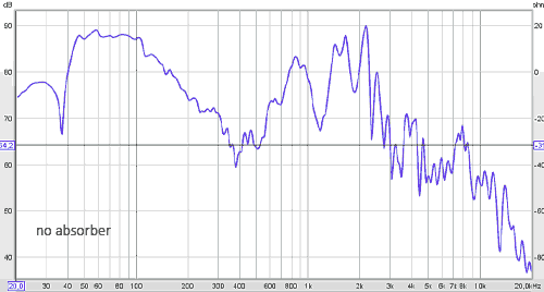

I attached only the central air pump absorber, closed the quarter lenth hole and measured the responses of different lenght settings:
![absorber-length.gif absorber-length.gif](https://www.diyaudio.com/community/data/attachments/1141/1141023-ce3d52626a08c8861daffee1ebd8358e.jpg)
observe the port length resonance at 900 Hz with "no absorber" (or more precisely: absorber set to 0 cm lenght) and the changes when extending the air pump.
the pump is acting as simple 1/2 wavelenth "absorber" with a constant cross section.
as can be seen the port length resonance combines with the added "stub" and creates a strong lower resonance. once the "combined" resonance is at about 600 Hz the port lenght resonance appears again.
also it is quite obvious that adding a simple resonator introduces more problems and is not the simple solution as I was thinking some time ago when starting this thread. that idea was to absorb the pressure maximum at half the lenght (here about 10,25 cm) with an absorber closed at one end of that same length (10,25 cm).
have a look at the response at 11 cm extension - it just does not work like that.

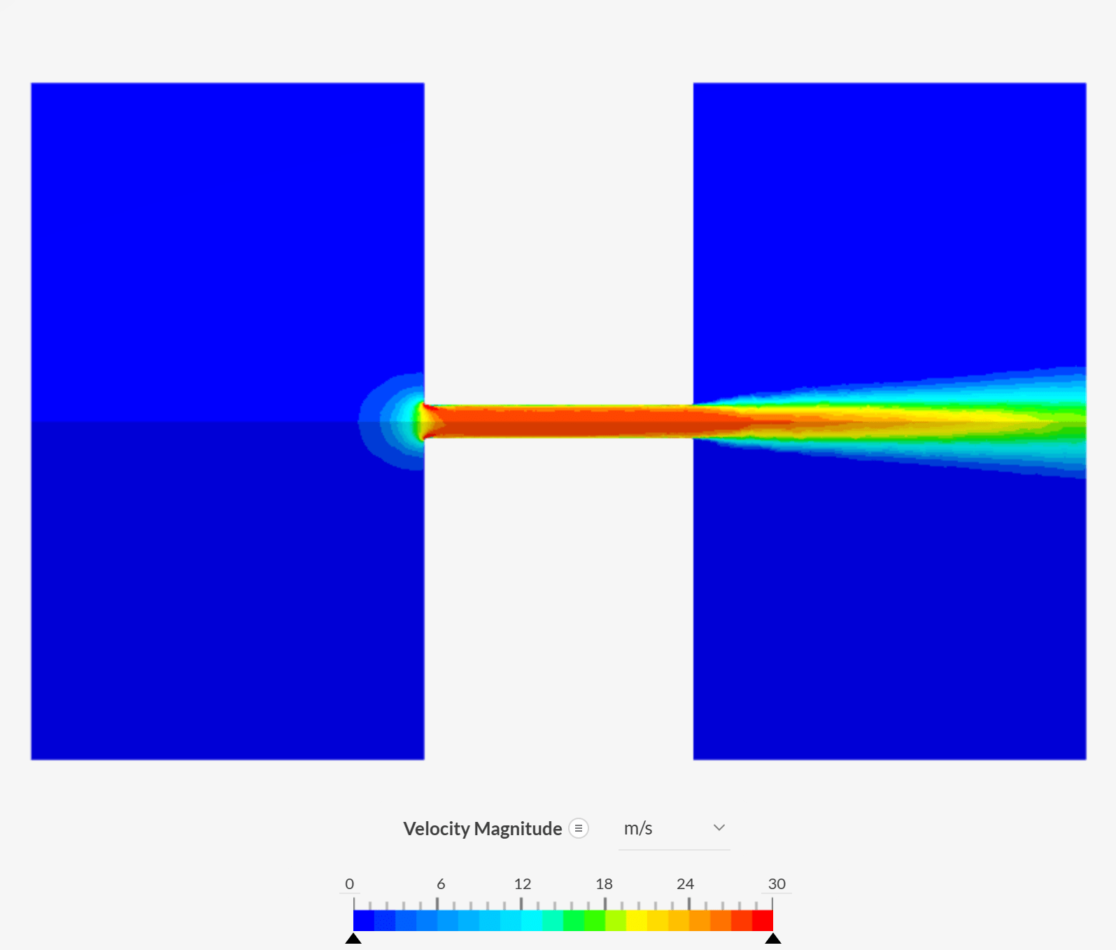

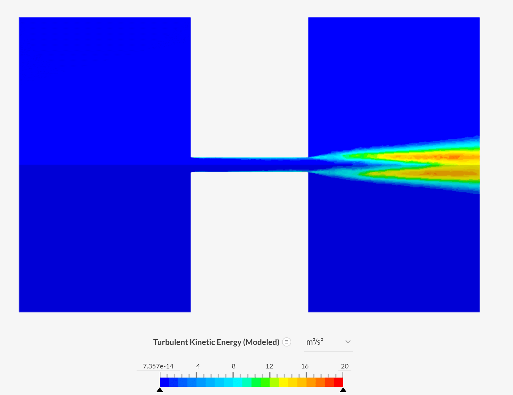

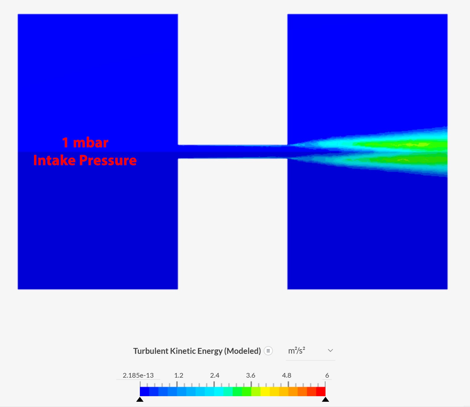

Very much agree. The cause of turbulence is the change in air speed, not the air speed itself. The more abrupt the change, the more turbulence generated, generally.
This occurs when the reasonably constant air speed of the straight port meets the large air volume of the room and abruptly slows down (pressure rises). In practice, the wave front does not slow down uniformly and we get turbulent flow. When we flare the port ends we gradually reduce the air speed towards the ends of the port, essentially trying to reduce how abrupt the change is at the boundary to the room or cabinet internal.
For your interest, here is a CFD simulation showing air speed of a 4cm diameter straight port with air flow going from left chamber to right chamber. The pressure rise in the left chamber is approx. equal to a 6" woofer with 5mm pk-pk movement. Clearly air speed is highest in the middle. When it slows down to the right we see concentric streams of differing speed that will dissipate energy in sheer friction as the boundaries rub past each other.

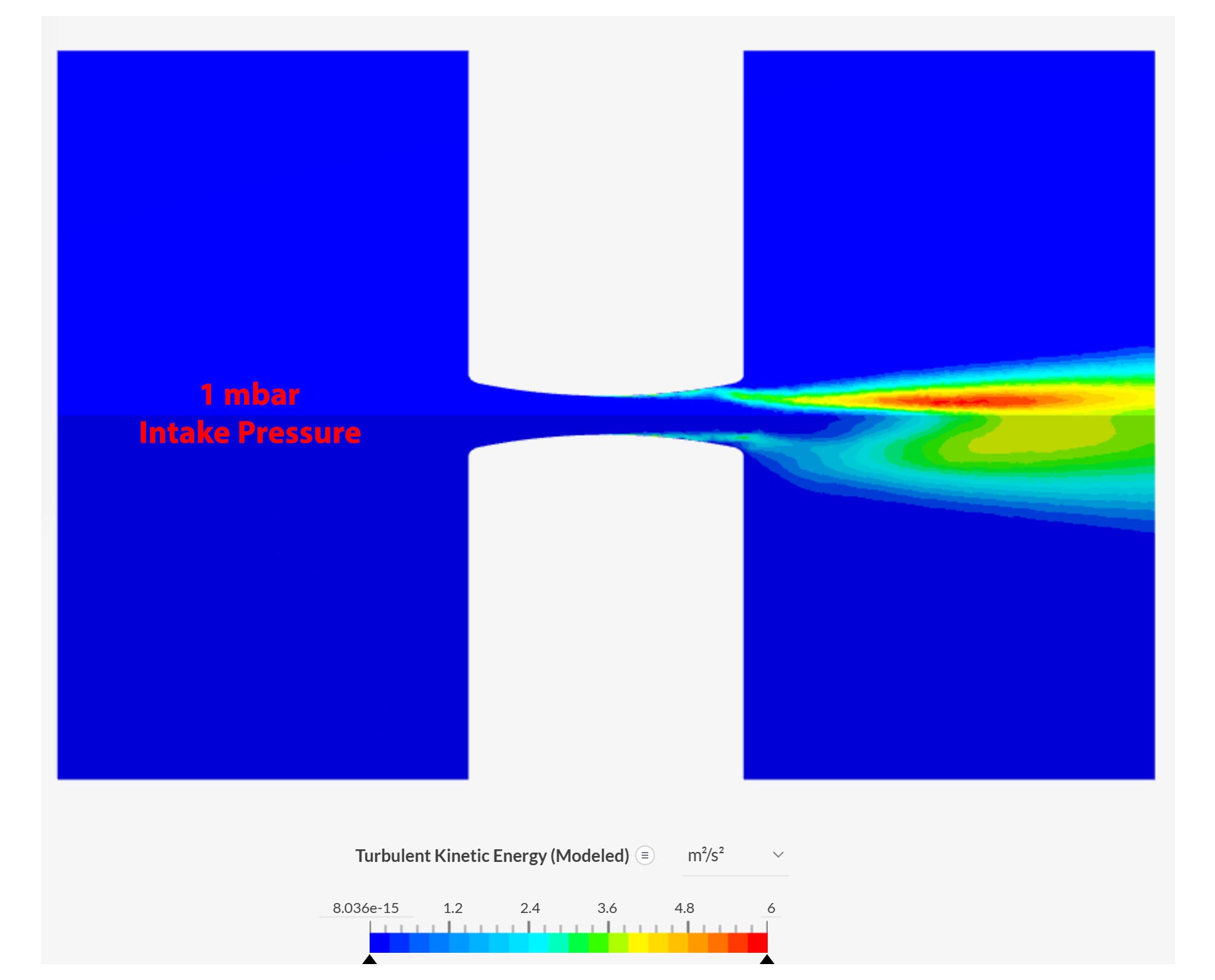

By contrast here is the TKE (turbulent kinematic energy). It is concentrated around the concentric / parallel streams of differing air speed, not at the highest region of air speed in the middle of the port. We don't see a lot of turbulence in the middle where the speed is highest because the 'wave front' is uniform and does not cause sheer friction.
I want to show a flared port too, but something is weird with the meshing.
Really brilliant work! For those who don't realise, that is an animated gif, you can click it to see all the graphs.

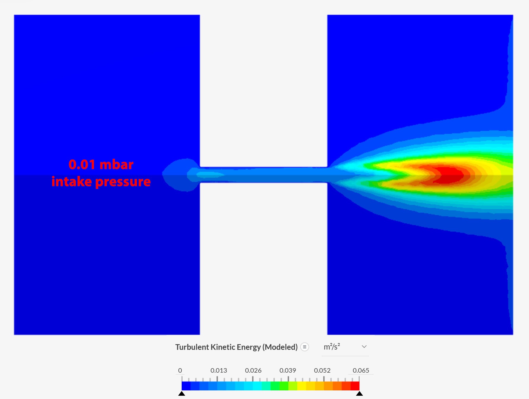

So, I'll follow up on those CFD simulations.
I didn't post the graphic of the flared port because it showed higher maximum turbulence than the straight port and the result was not symmetrical to the port axis. I figured something was not right on my simulation but actually it was simply the intake pressure was too high. It's very interesting because this shows how a flared port can actually perform worse than a straight port at very high air speeds / output levels.
So here is the turbulence energy of straight vs. flared port at a low pressure level:
Here is the same thing but at a higher pressure level. Note the scale has changed:
This is supportive of the research by Roozen.

Any round-over will result is less turbulence because the jump in impedance isn't as bad as just straight.
It's only how we define "flaring", because in your pictures the flares goes gradually but all of a sudden very abrupt when it's towards the end. (it has a very small radius there)
In that case we get a sudden jump in impedance again, so in that sense it doesn't surprise me dat we are getting some turbulence again. The radius (in this case it's a compound radius) has to do with this as well.
If you would make that radius at the end much bigger (so I mean on the edge), this would also perform better in sense or turbulence.
The downside is that the tuning frequency will become a lot less predictable and sometimes even start to change depending on the amount or airflow.
What are you simulating this with btw?
That is correct, however the turbulences are starting inside the port, at the big radius curvature, as far as i see it.it has a very small radius there
I suppose (as i mentioned before) that the simulation shows a constant one-directional air flow and air speeds will get very high (if i am not mistaken and the air flow is actually simulated as oscillating).

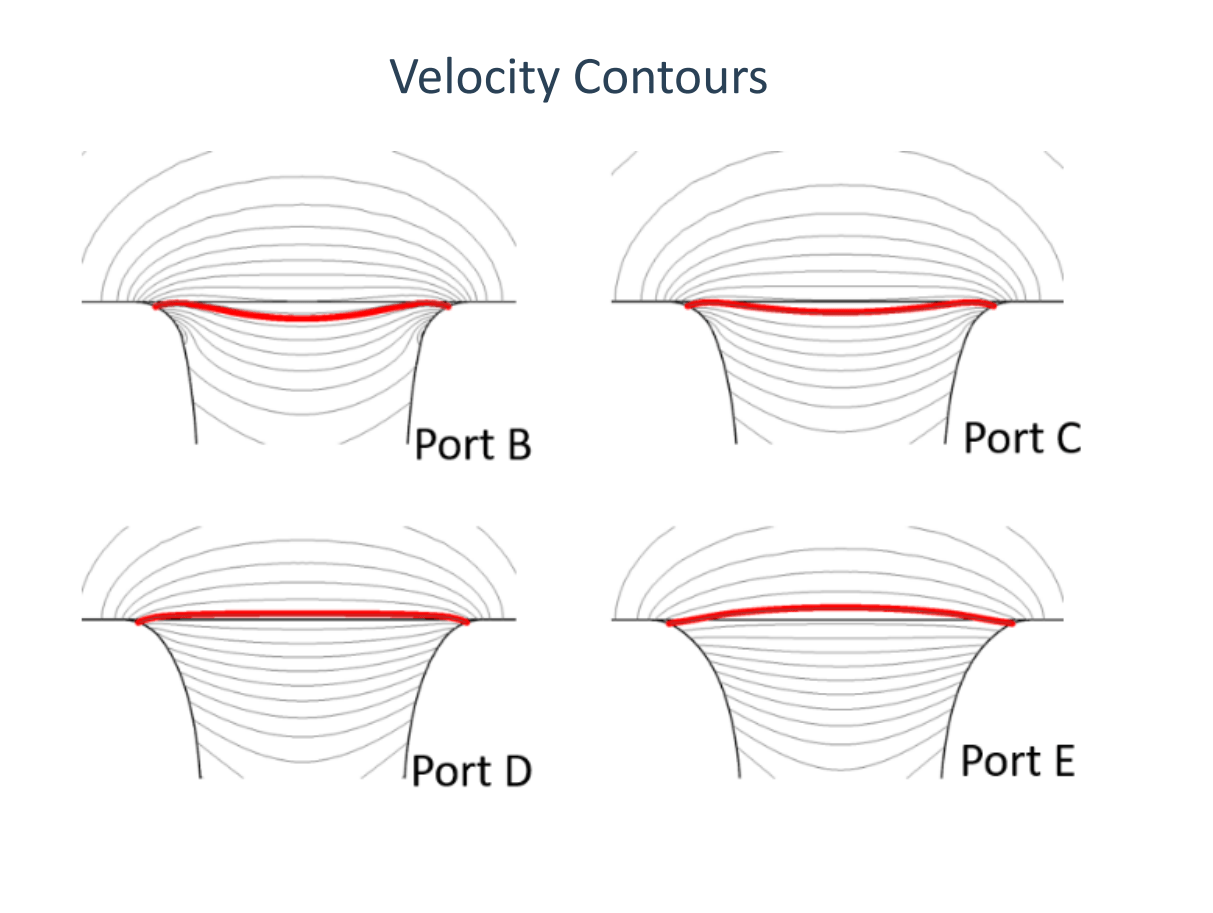

Most of the research I've read says that a rounded over end of the port is beneficial - as in the radius between the port and the cabinet. However the question about over-all flare of the port is something that depends on the air-speed / output level because flow separation will happen differently at different air speeds. You can't have one ideal flare for low and high air-speeds. In the 1mbar sim my flared port is 'over-flared' for the air-speed. We might think of it intuitively as a car not being able to take such a tight corner at high speed.
"This study shows that for high exit velocities a slower taper may be required"

There is a Comsol paper that shows why optimising for the velocity contour, not the max velocity, is how we maintain low turbulence.
https://www.comsol.com/paper/download/679321/bezzola_acoustics_presentation.pdf
