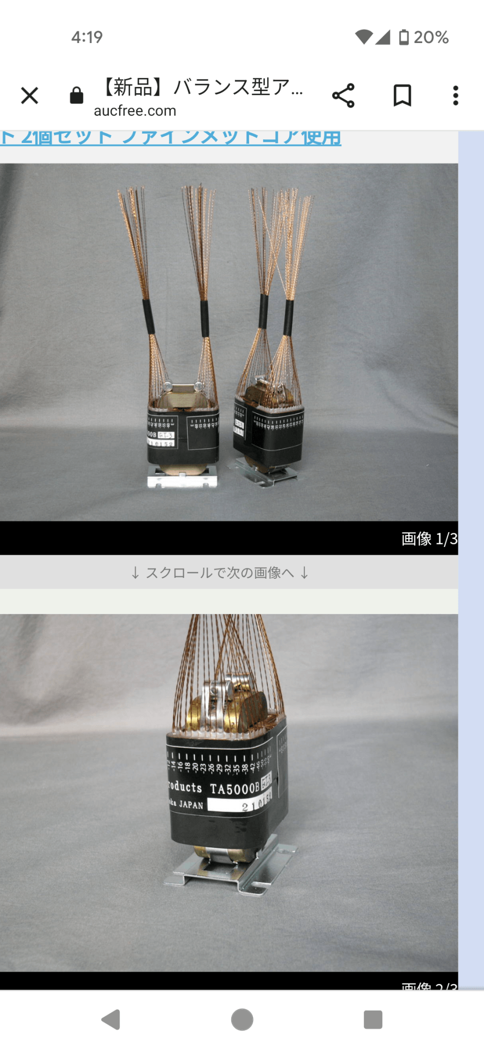

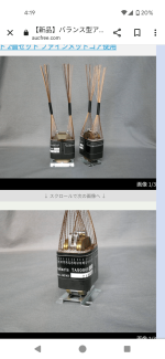

Both coil mean 2 wires on secondary?
I think it's properly balanced.
I am asking him if he still making them.
