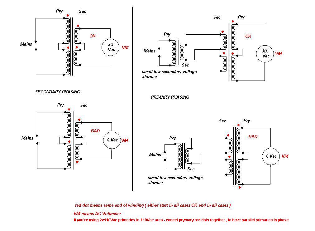

as I've sent you that small donut , while forgetting that it's having 4 separate 15Vac secs , so I didn't solved wiring for ya .......
you can phase them either measuring inductance , or with simple test shown in attachment
it's simple in fact - connect primary you have to mains , carefully to not make some short (anywhere) ;
prior to that - tie two adjacent wires of two secondaries ; measure across other two (free) wires - if you have double voltage of just one sec , you got phasing right - and that common point is center tap
repeat the same for two other secs
if you have approx. zero volts across two free wires , you got it antiphase , so use other wire of one secondary
and of course that you need two AC wires and one CT to connect to pcb - that's the way to get bipolar supply
