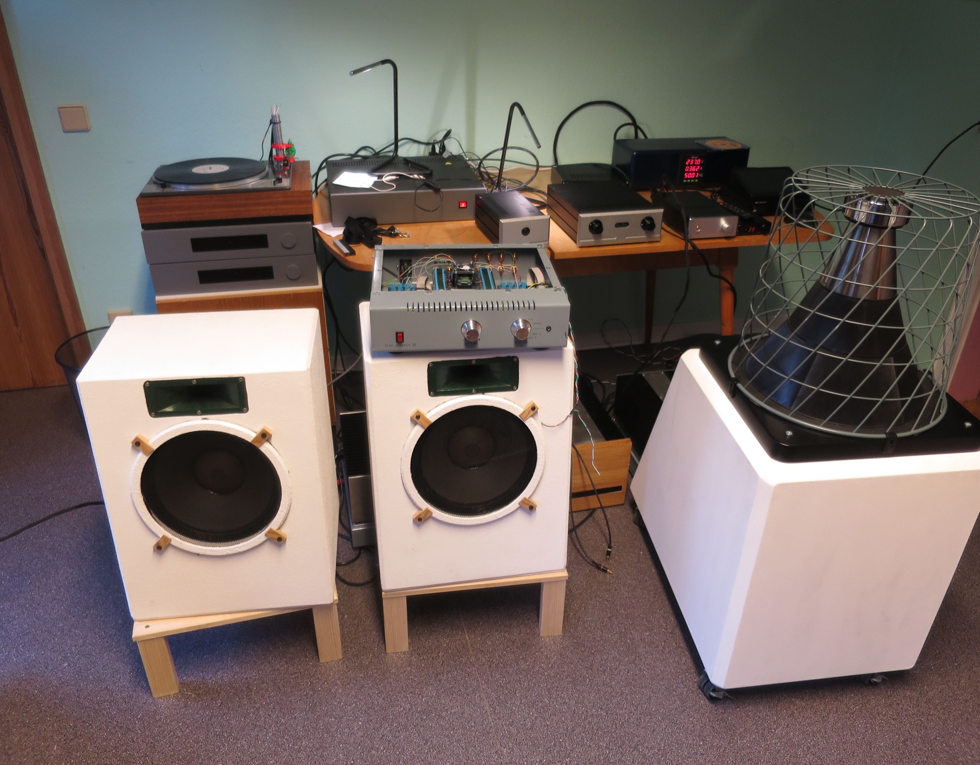

It´s a diy tonearm made with a 3D printer (not mine) 🙂

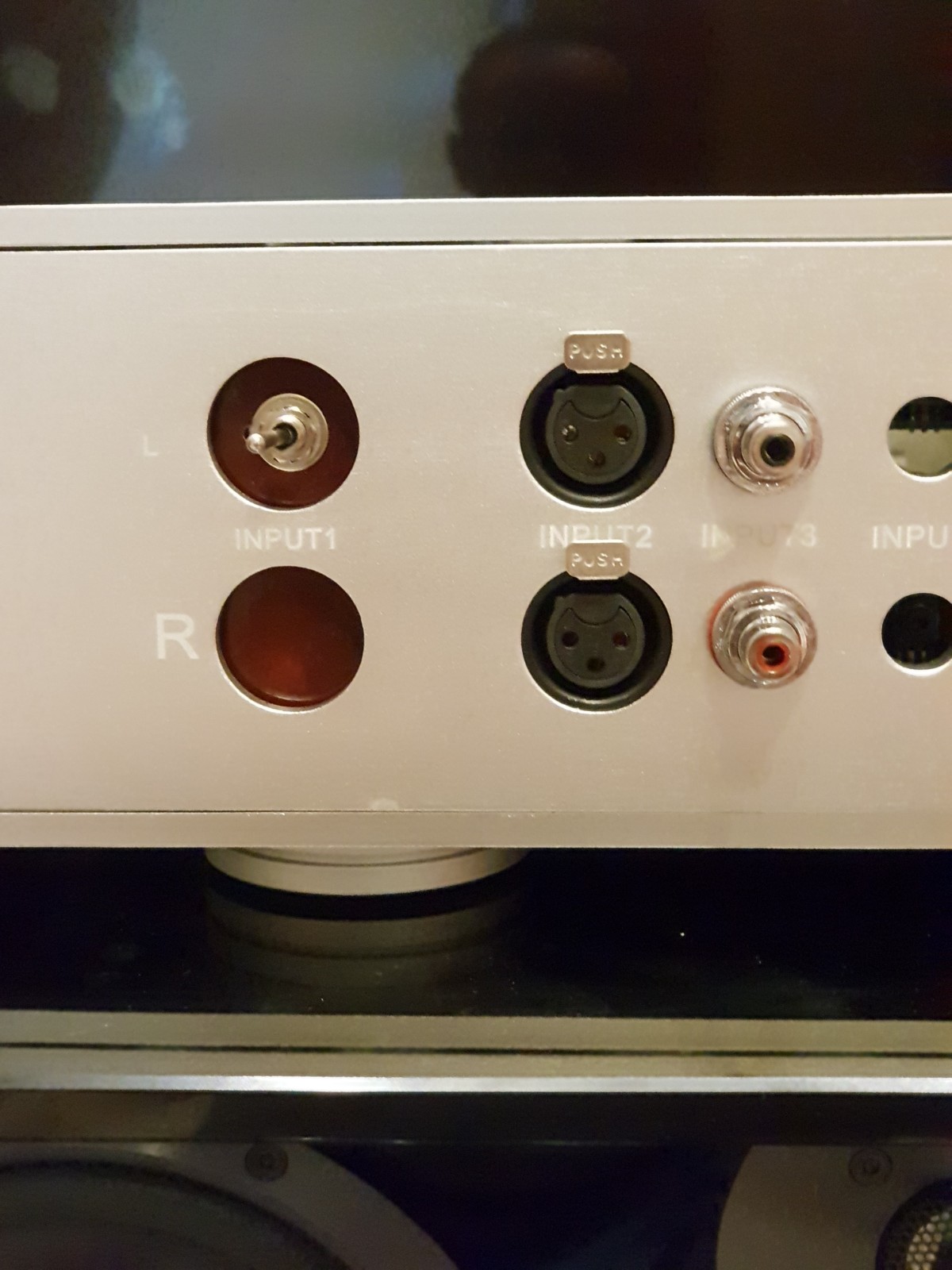

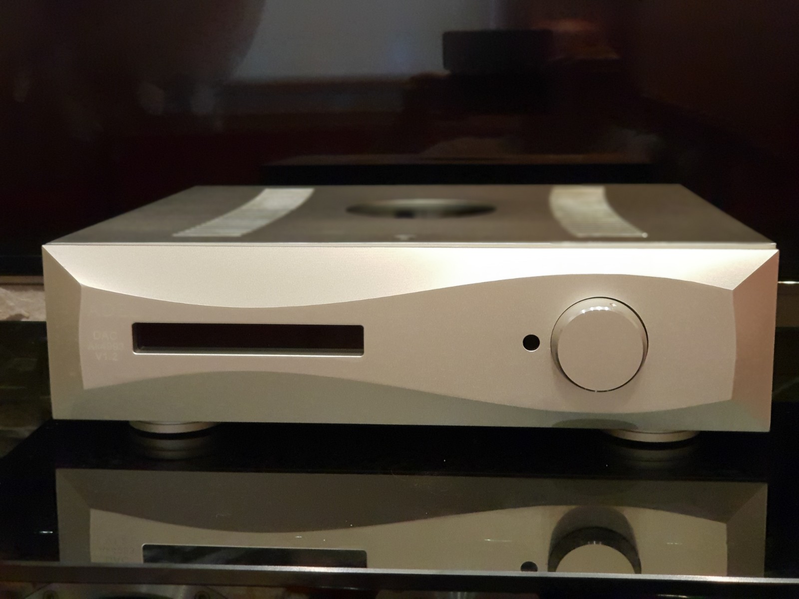

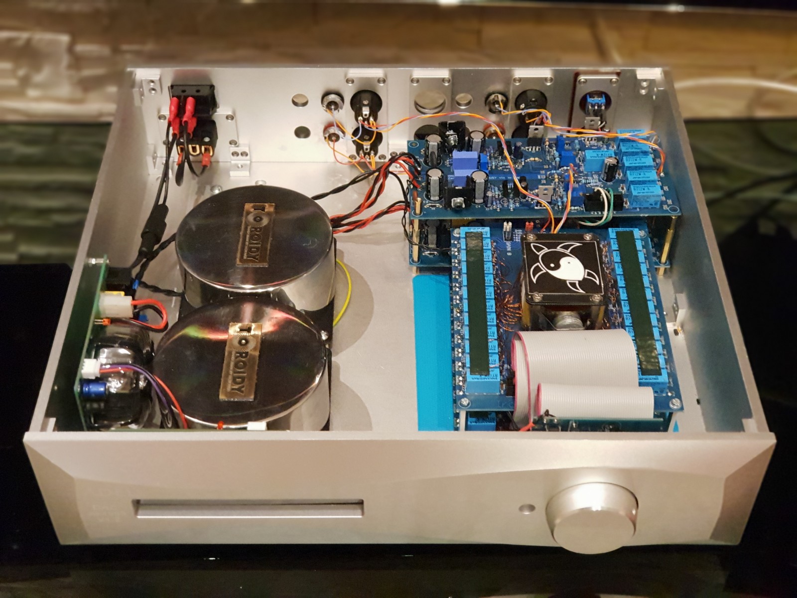

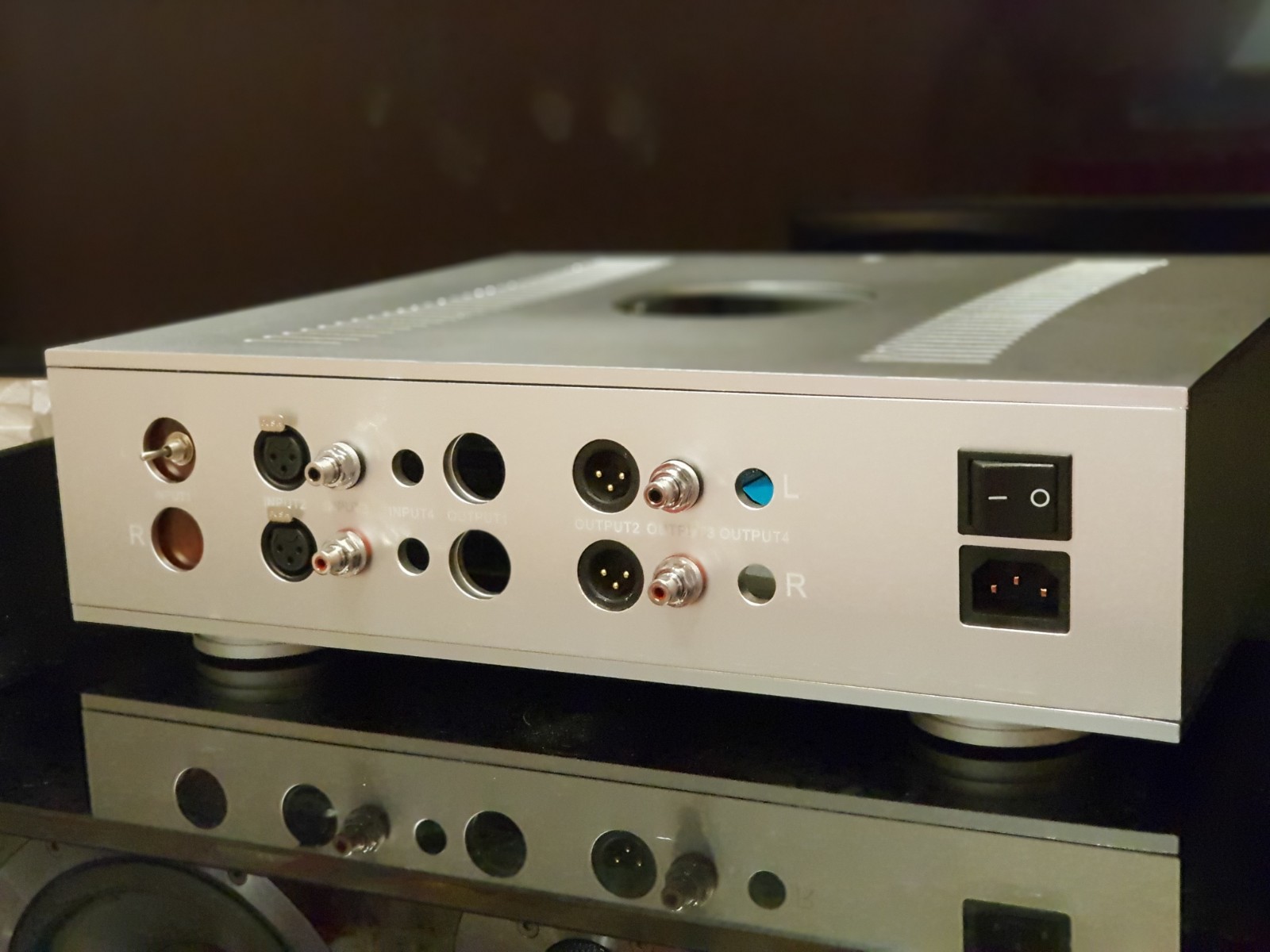

After a long period of time, I finally managed to assemble the preamp. Because I do not need so many entries, I kept an XLR and a RCA. In this case, I dropped the selector from the front and put one switch in the back, with which I select the entrance.
Houses, made to order, are 100 mm tall. The top and bottom plates have a thickness of 6 mm, so I managed to mount everything in a space of 88 mm and I am very happy to have succeeded 🙂.
Transformers have a softstart, which can be started from the remote control.
How does it sound? I'm not talented to describe. But from everything I've got, it's the most transparent and neutral preamp.
I can hear the smallest details, with a superb positioning in instrument and voices space. Female voices sound incredible. Very articulated bass. In short, I love this preamplifier and many thanks to Aleksandar!

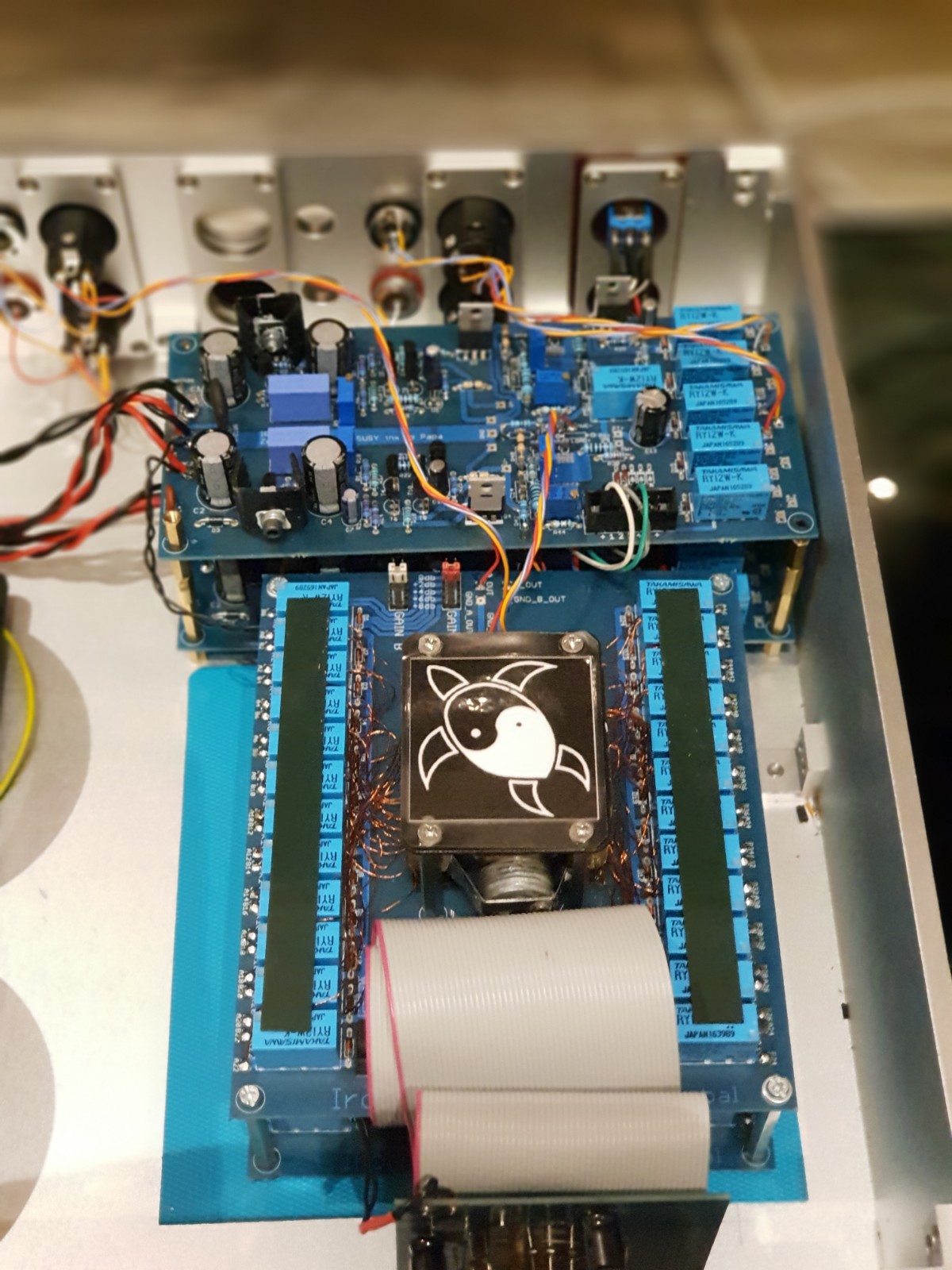

Problems - I have two.
- Volume increases counterclockwise
- at position 11, the sound disappears in both channels, in the other positions everything is OK.
I would be grateful if ZenMod can help me with some advice 🙂

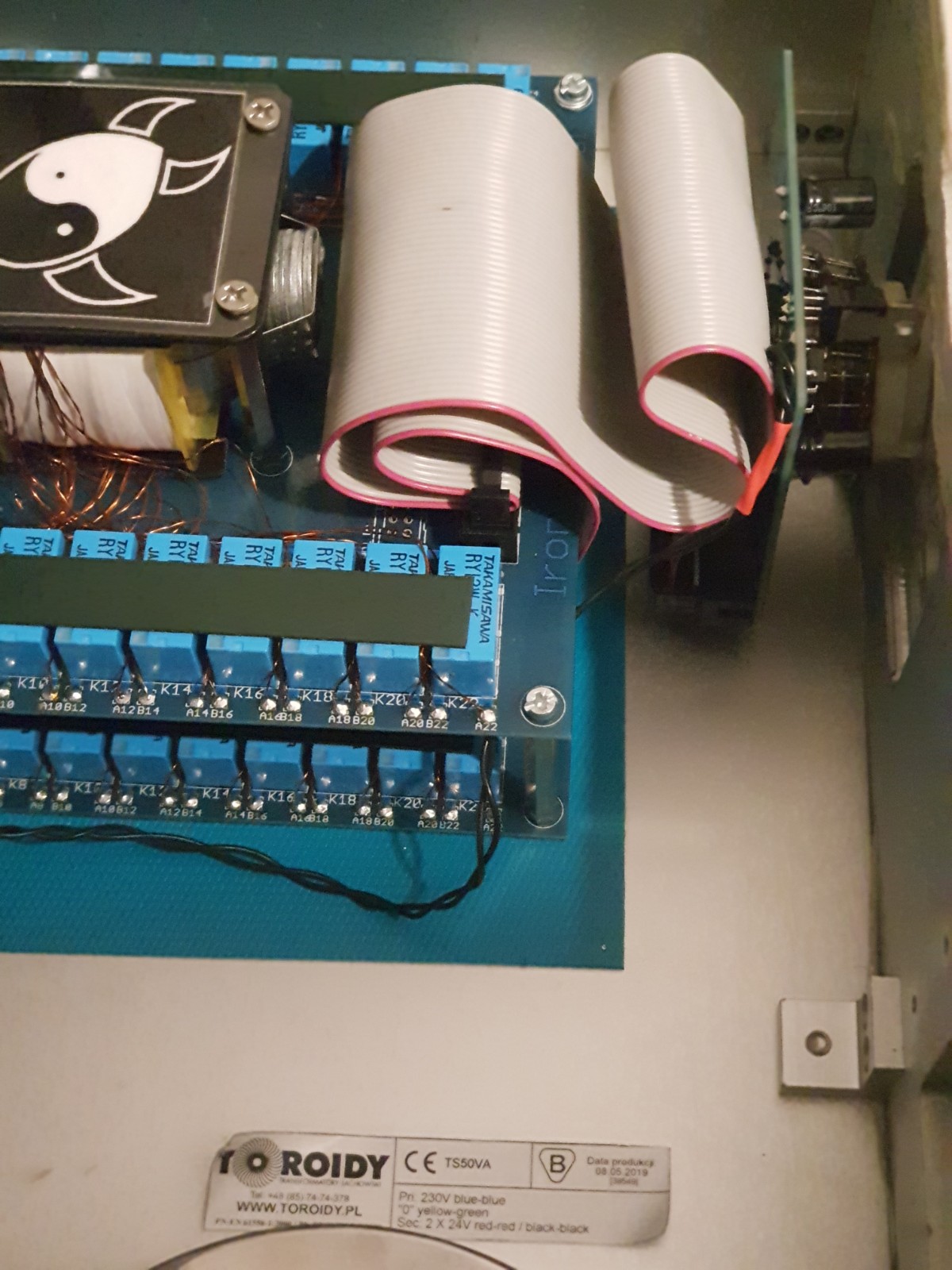

I'll email you trivial solution (tonight) , because reason is trivial
even if obviously my mistake with IDS header
I'm glad you like it
just shave** that tooth at IDC cable connector , on side of switch , and rotate it's position for 180deg
you have enough cable length for that
**use file , dremel, smal grinder , sand paper .... whatever you have handy

Will this trick also solve the problem that the signal disappears in position 11?
