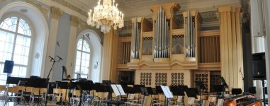

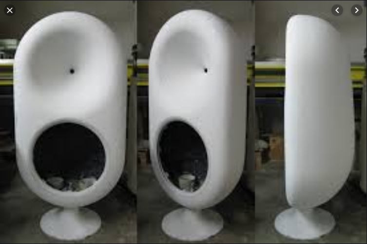

This is a story from 2014. The speakers were built by a guy who is an aircraft engineer, very skillfull and equipped, he made it all himself at home. I remember that this big and heavy enclosure was extremely rigid and acoustically dead - some sandwich construction. The driver was 1" P.Audio PA-D45 (quite a monster) - maybe I could find the measured data. We measured these together at HAMU in Prague, musical academy right under the Prague Castle, they have an anechoic chamber there. Unfortunatelly these were never finished as the man has since a more important work to do - airplanes I guess. Pity I have lost much of the photos...
The photo above is from his yard measuring the speakers on an equipment he built one afternoon just for this purpose.

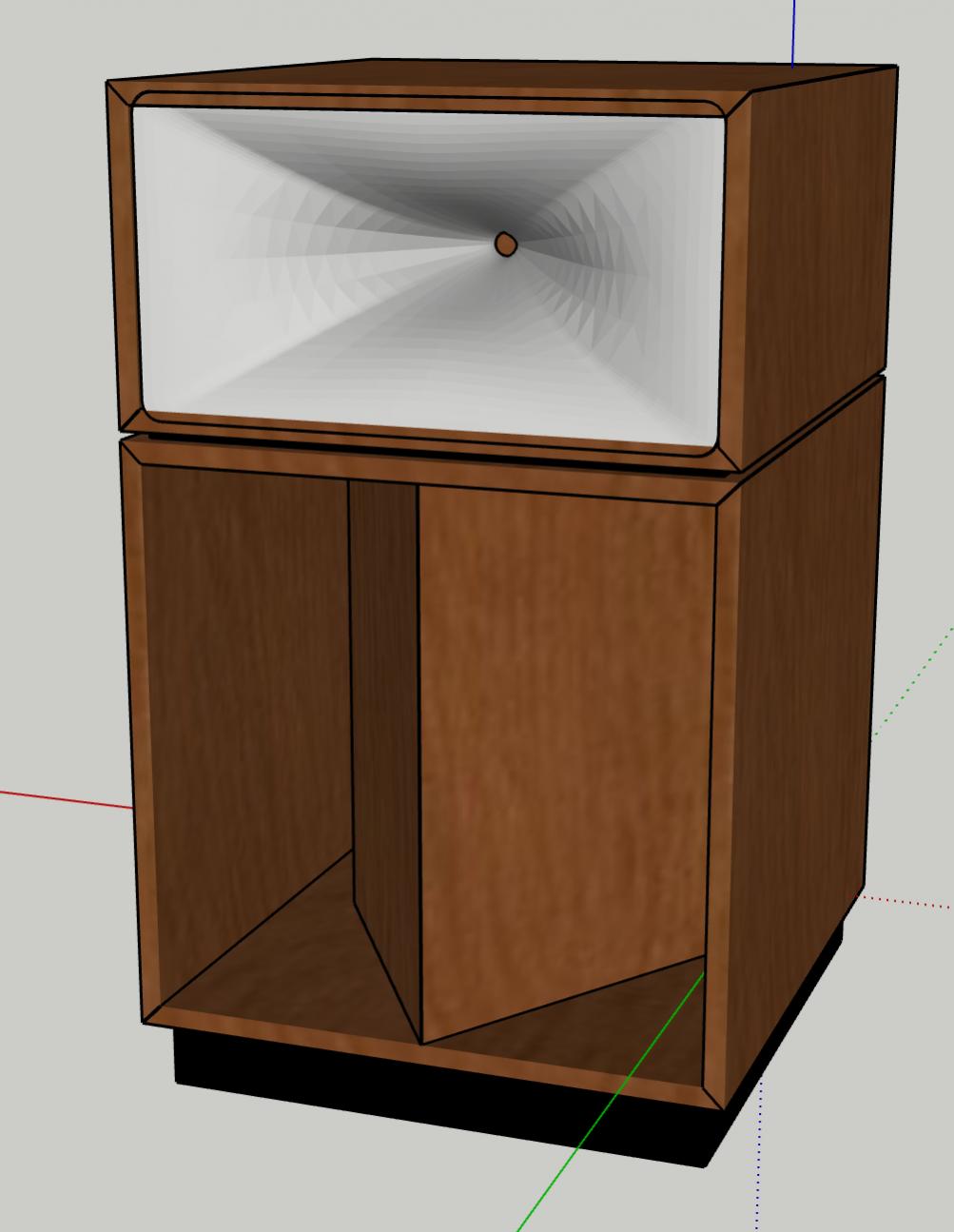

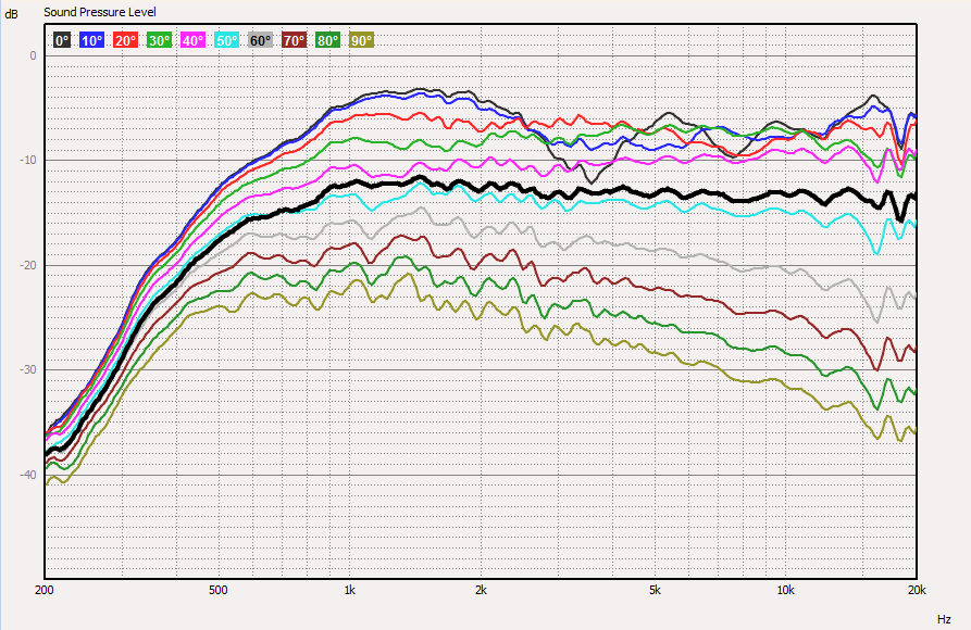

So this is what one of Mabat's horns looks like in a LaScala like enclosure. Pretty cool stuf for only an hour spend (excl. waiting for the simulation to finish) 🙂.

Mitch, your 2384s are still very good imo.
In the complete system the M2 wg is undoubtely a competent performer, but this only after a considerable amount of processing.
The wg+D2 and the woofer are not an ideal match.
It's no wonder the wg doesn't load the driver very well below 1000Hz, if you look at its depth, or lack thereof.

But as can be seen from some of the recent polar's, there is better.
Given most large 2-ways are 15" woofer(s), one would have thought a 15" or 18" optimised matching constant directivity waveguide would be readily available for 1.4 or 1.5" exit CD's (which seem to be the best comprise for crossing low and still making it out to the top octave)...
PS. Love the latest set of measurements - very nice waveguides - cool LaScala!

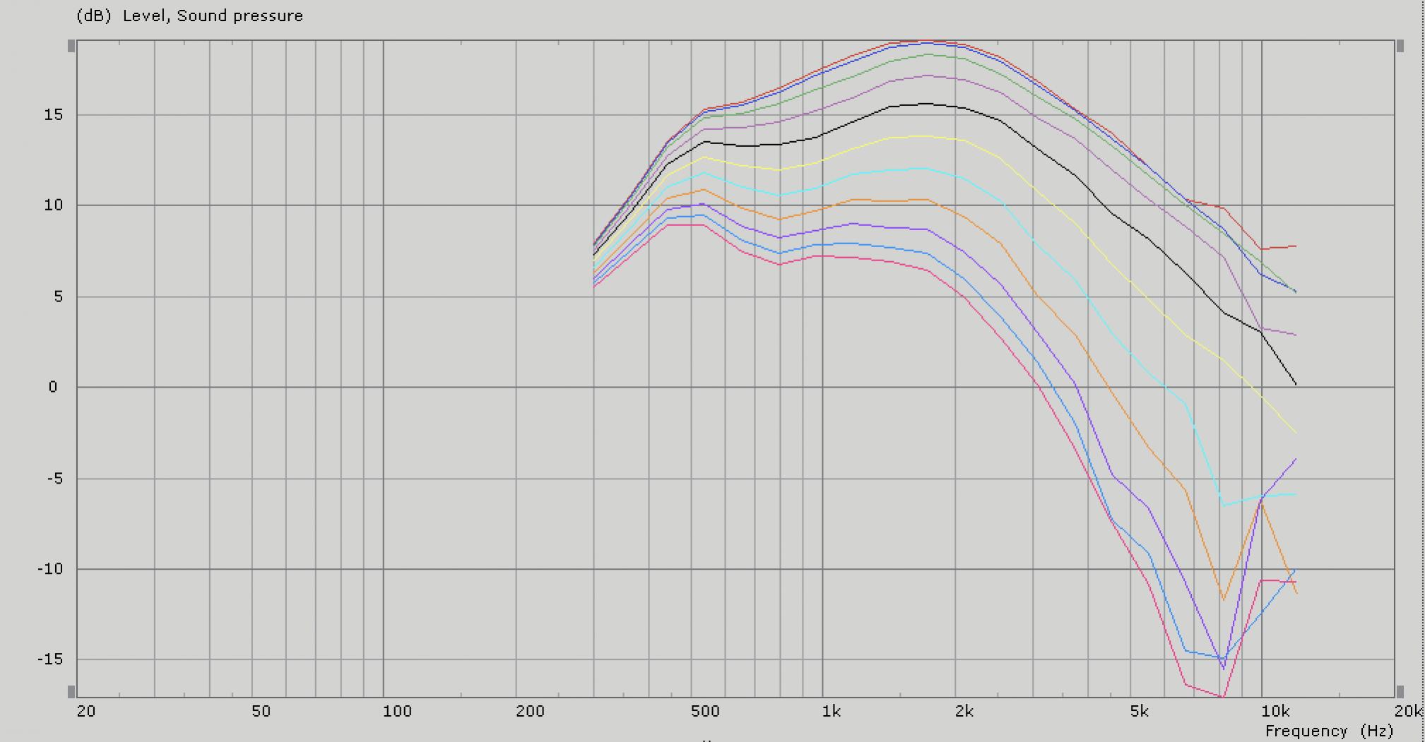

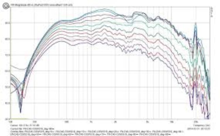

This is a story from 2014...
From the web archive I could find only some poor resolution thumbs...
But you can see that even a waveguide this big (OSWG about 20") in an enclosure this smooth is not free of axial issues when not terminated good enough (this was before I gained the knowledge of how to do that). It's not just the size.
BTW, one more thing I remember was that the driver used (P.Audio PA-D45) was very clean sounding during the (very loud) sweeps for the measurements. Much more than DE500 that we measured right before in a similar speaker. Does it really mean something? I don't know, it's just that everybody noticed. The target crossover point was around 700 Hz IIRC.

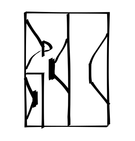

This is the schematics of my latest construction - still in progress. With a passive crossover, three-way (15" + 12" + 1.4"driver) with a 4th order band-pass on the bottom end (presumably with a passive radiator). I expect a lot of performance from that - performace AND simplicity. All closed boxes.
