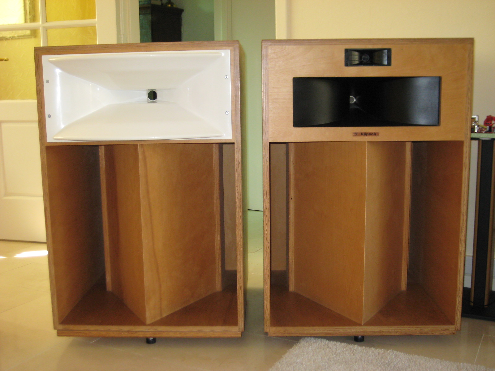

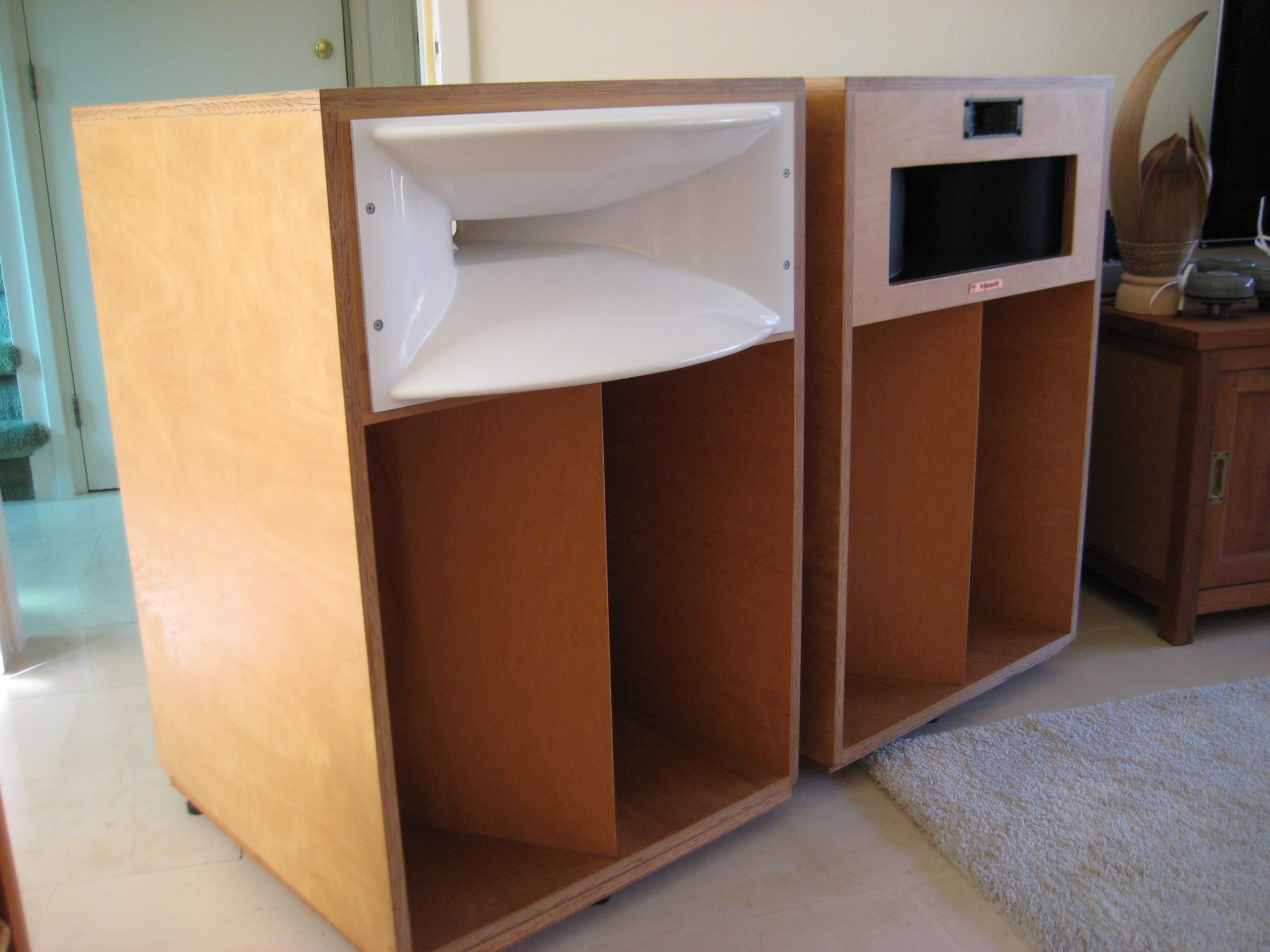

So this is what one of Mabat's horns looks like in a LaScala like enclosure. Pretty cool stuf for only an hour spend (excl. waiting for the simulation to finish) 🙂.
Reminds me of this LaScala mod, by a fellow Dutchman btw.

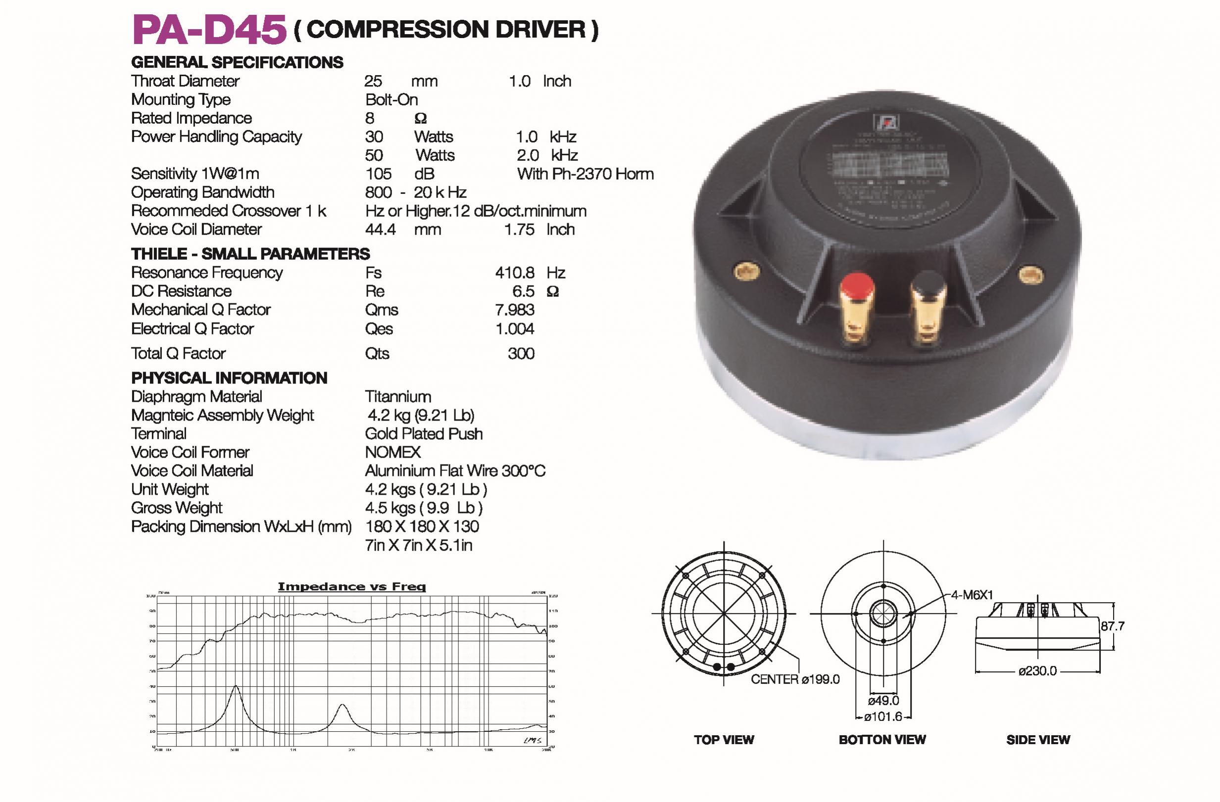

BTW, one more thing I remember was that the driver used (P.Audio PA-D45) was very clean sounding during the (very loud) sweeps for the measurements. Much more than DE500 that we measured right before in a similar speaker. Does it really mean something? I don't know, it's just that everybody noticed. The target crossover point was around 700 Hz IIRC.
IOW the P.Audio PA-D45 sounded better than the DE500, especially around and below 1000Hz?
That doesn't surprise me in the least. Not so many pages ago, I posted a similar comment regarding the DE500.

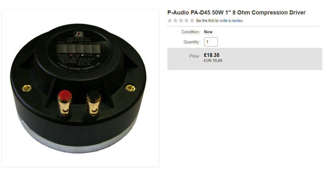

The P.Audio offers tremendous value.

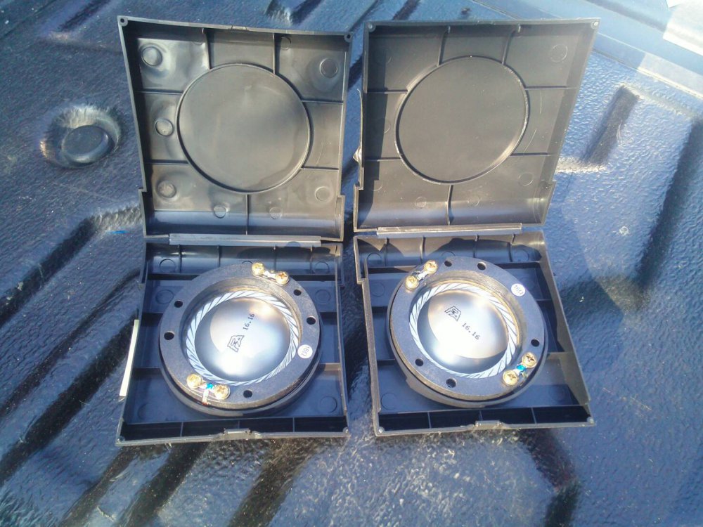

I got these very cheaply in a sale years ago and I still have a pair. It's not quite typical 1" driver. It was definitely cleaner during the sweeps - probably well below 1 kHz, I didn't measure the distortion. So it could be crossed over quite low for a 1" (1.75" diaphragm) I guess. In fact, this was the stimulus to build the big speakers - "let's build something big with this". Usually it's the other way around 🙂

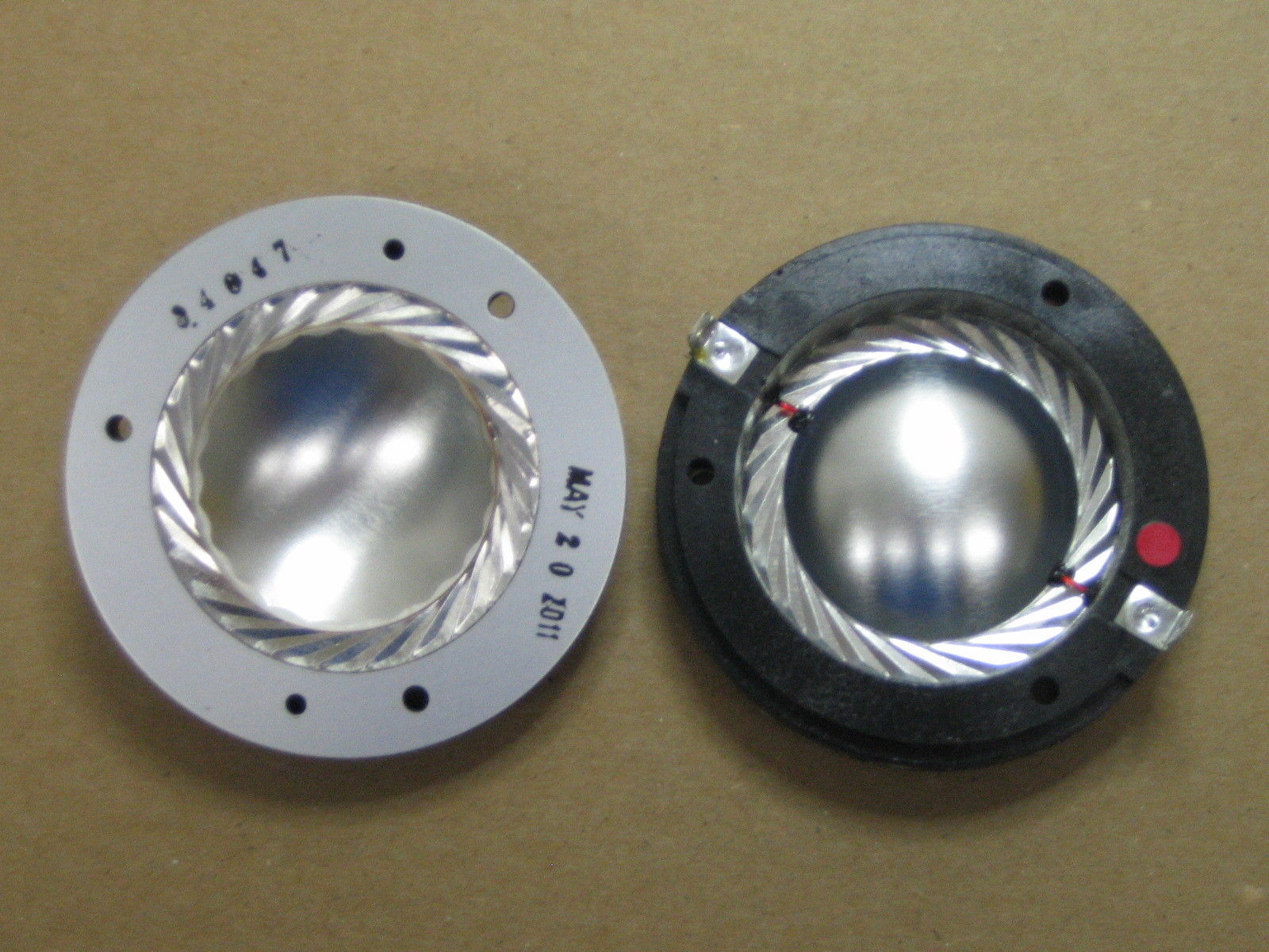

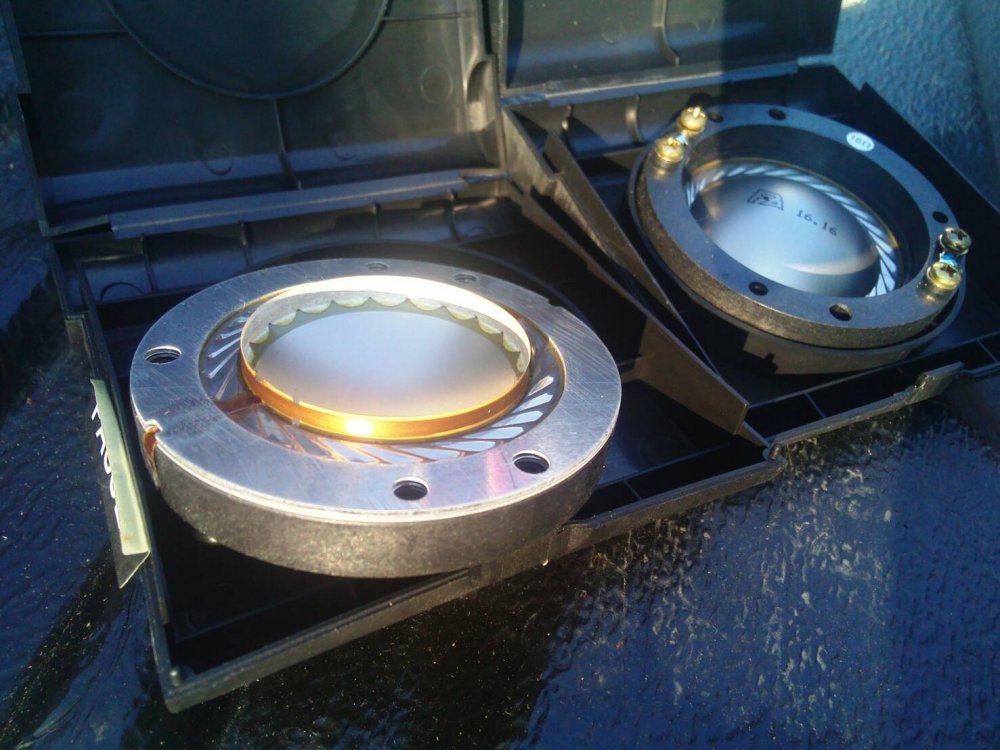

Indeed, it seems the PA-D45 shares some properties with the vintage drivers, like the 1" Altecs.
1, 2: PA-D45 diaphragm
3: Altec replacement diaphragm (GPA)
