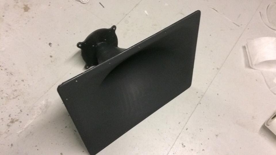

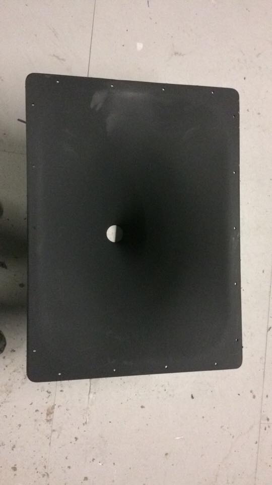

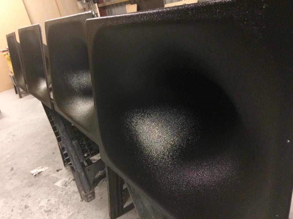

This XT1465 easily loads a coaxial from 300Hz:
Yes, I haven't been under the illusion the xt1464 can load to 500Hz.
But I have been thinking it could at least act as a waveguide to 500Hz...figuring i might not like the lack of pattern control, but that I could at least listen to how the lower crossover point sounds.

The XT1465 was developed some time ago for the BMS 4590 and 4592, so it's a 2" horn. You'll find more info in this thread, though many images are gone.

I am tempted to try that once. It definitely looks better than the XT1464 but will not load as deep. OTOH the mounting can be done much smoother than with the XT1464.
HiFi wise there are a few implementations using it , some Crites designs and the Unison Max 2 for instance.
