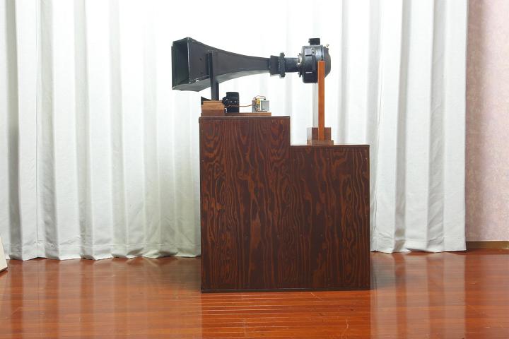

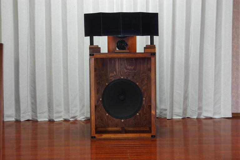

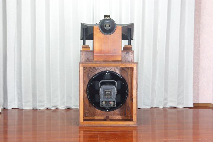

WE TA-7331-A
I am not sure if this baffle was already mentioned. I heard it at High End fair in Munich two years ago and was very surprised about the good sound. Simply use a proper horn on top of this and you have enough bass for private purposes.
ElectraVolt: Western Electric TA-7331-A Baffle

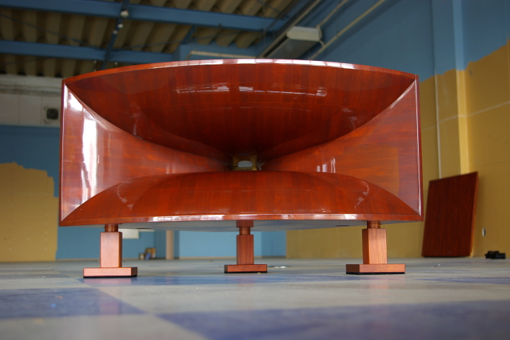

On several occasions my brother played electronic (as well as other) music through the loudspeakers shown below, and commented:
"Sounds better than any club system, even the Funktion One install of the Berghain."
Funny, because the G.I.P. 9700 is only 1/3 of the price
The cut off frequency of the big radial horn is 120 Hz.
![GIP9700%20(1)_1.jpg](/community/proxy.php?image=http%3A%2F%2Fwww.gip-laboratory.com%2FGIP9700%2520%281%29_1.jpg&hash=663a675da143181abb705b33be9f8143)
However, you really need a big room to get the most out of the 9700 system. The owner of the setup in the picture purposely built the space around it.

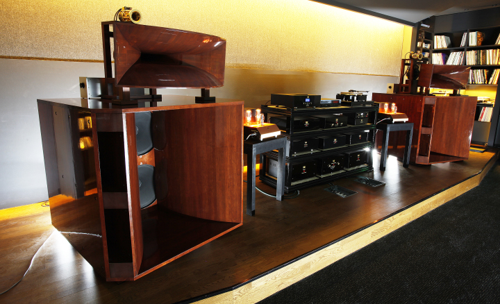

This G.I.P. system includes a similar baffle as the Western Electric TA-7331-A in docali's link and is better suited to a medium sized room:
The folks at G.I.P. likely had their reasons to leave those out. Their systems are inspired by WE, not necessarily identical/perfect clones.

[GIP-9712] radial horn is cut off frequency 120 Hz.
