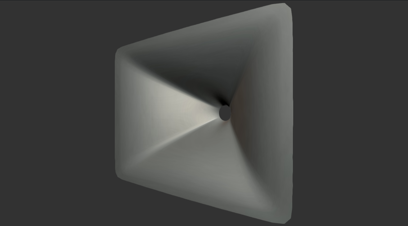

In experimenting with mabat's tools I've found when extreme .exp values are entered, the onset of trenches become visible, similar to those in the 4367's horn (up and below the throat).
Somebody with exceptional parametric modeling capabilities would probably be able to develop a tool, or parametrized CAD model - including the required math - to reproduce (and even improve upon) the JBL Image Control Waveguides.
mabat's tools reproduce an OS throat section, which is still visible in the horizontal plane, where the trenches are less pronounced.
I believe the beaks of the JBL waveguides are 'brought in' from the the mouth. There's a short 'slotted throat section' - basically similar to the throat section of the latest Meyer horns - that's modified in accordance with the required/desired 'smearing of reflections'.

Another way of looking at the Image Control Waveguides is as follows:
The basis is a parameterized, fully closed bi-radial horn - so with an infinitely small throat size - into which the required driver exit is then pressed.
Finally, a key-element in cancelling interferences is the intentional creation of pathlength differences.
If you visualize an (imaginary) extension of the 4367 horn's horizontal walls into the throat, it's obvious that the beaks (or knuckles) would meet 'in front of the vertical walls'.
The 'magic' of the Image Control Waveguides is in the throat section.

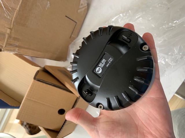

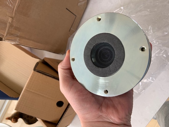

Thanks! I'm working on a scaled up version ES-600 right now using the RCF ND-650.
ES-600 Bi-Radial Wood Horn – Joseph Crowe
