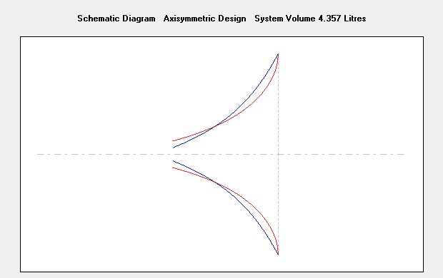

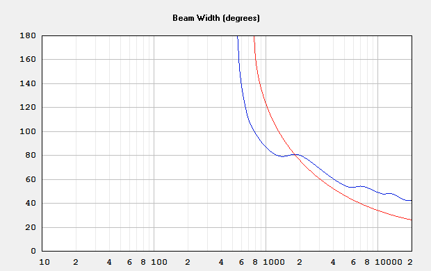

Where I find hornresp useful is showing the relative effects of tweaks to certain horn types. Waveguides aren't bad at holding a pattern low.A generalization
Don't read into the throat size difference, the LeCleach is just longer.
